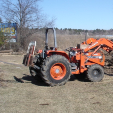

I made these over 10 years ago out of rusty metal I had laying around at the time. The key ingredient was the 1/2" plate piece I found that had the perfect dimensions. The back stop is an old headboard from a bed which is slipped over old cut off axle shafts. Scored the forks for $20 each. It will handle anything the tractor can and then some. I since have added a modified back blade that clips on and will post pics of that when I have it on.

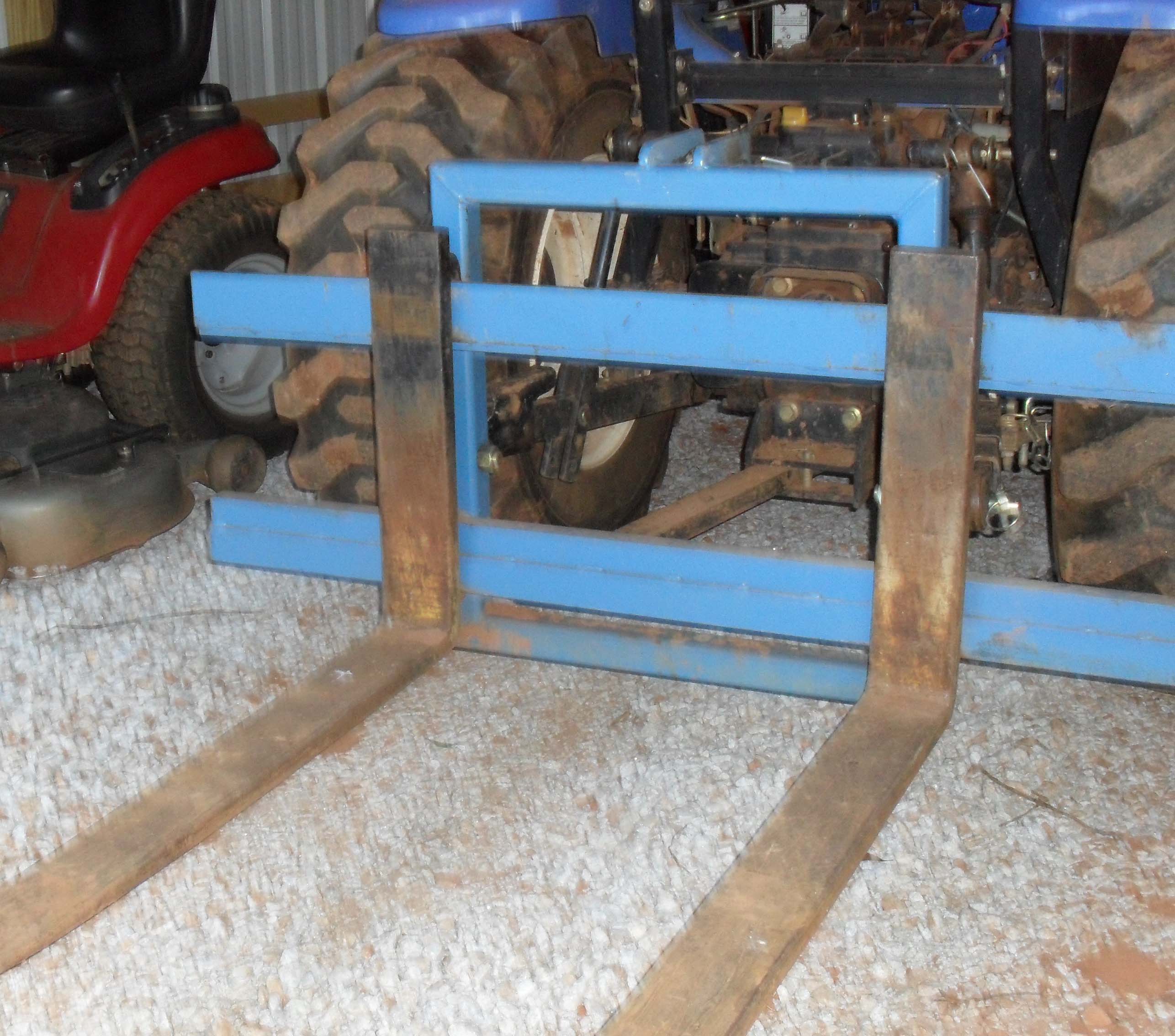

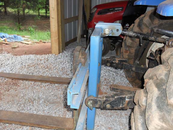

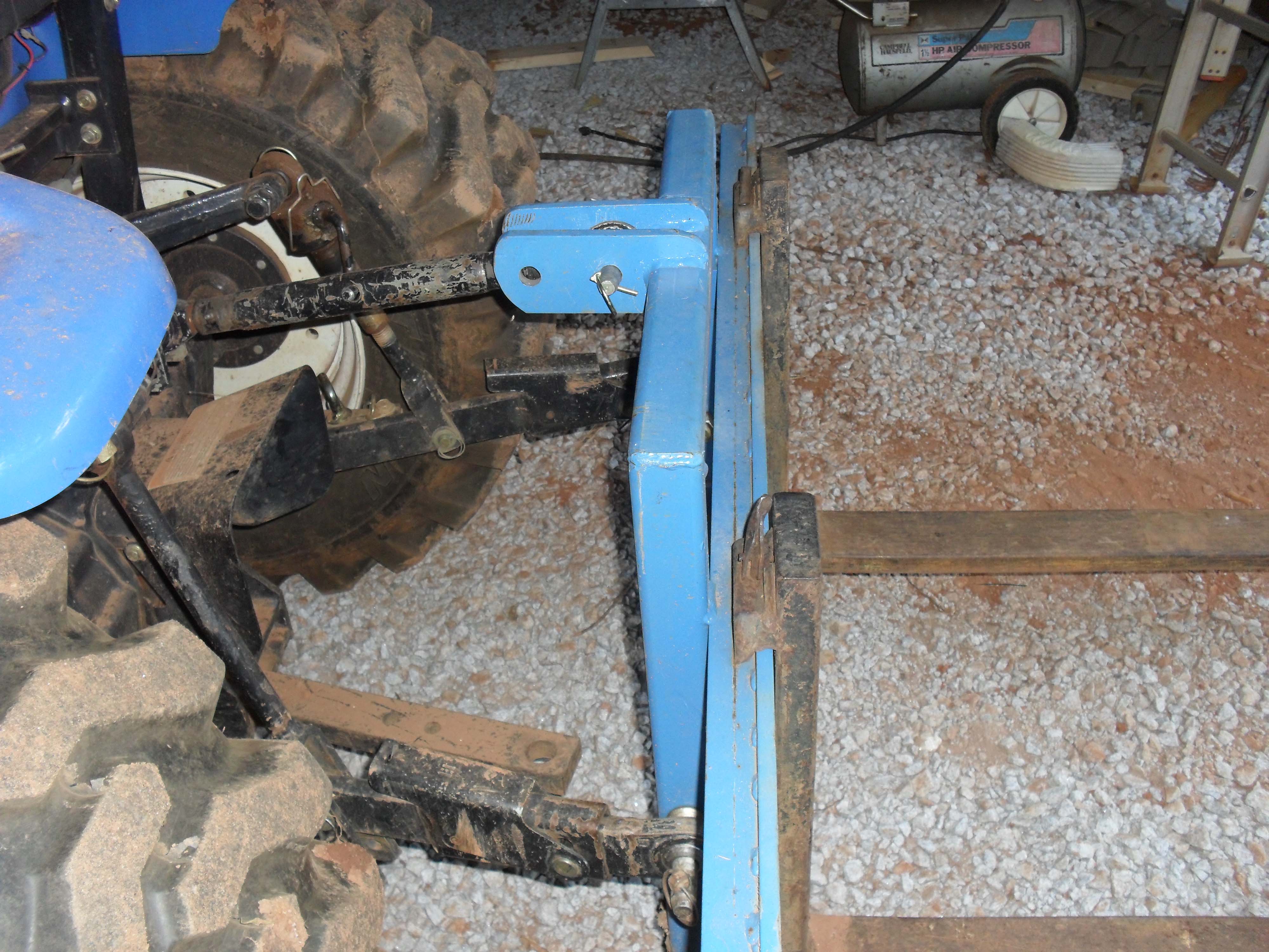

Here is mine.
