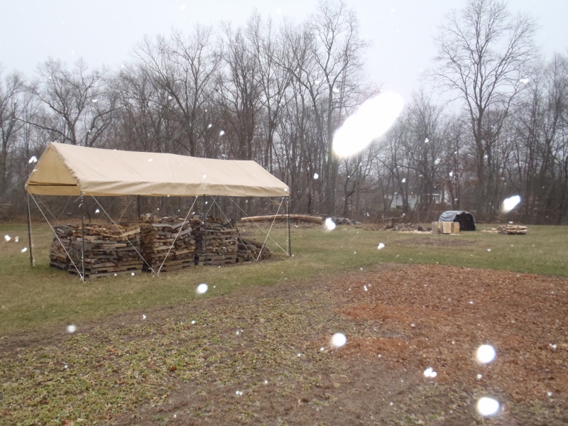

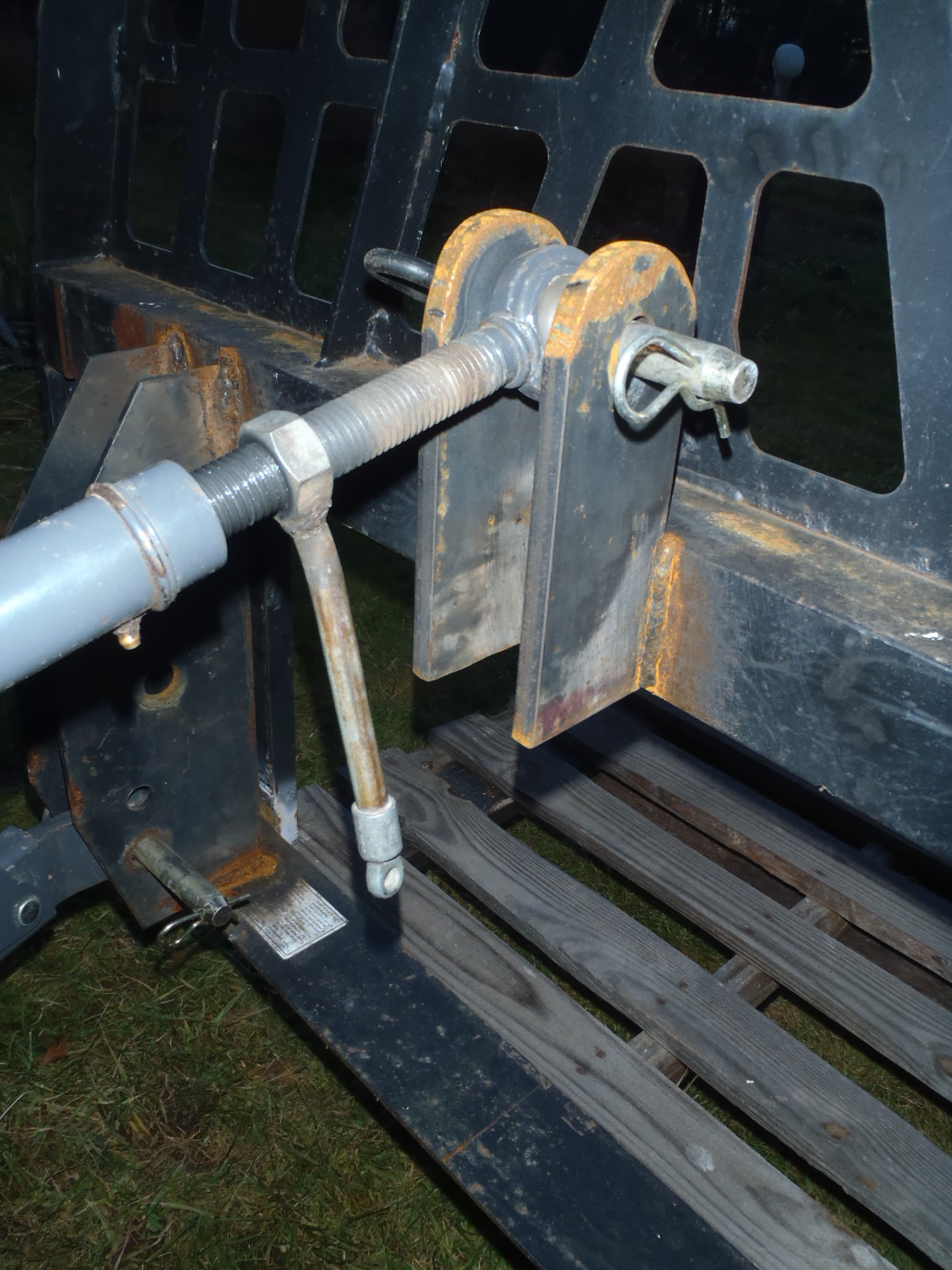

I found a set of used, FEL forks on CL that don't fit my FEL (yet), but that's on my to-do list.
Asking price was $400 and we struck a deal after some discussion.
Modification to attach to the 3pt hitch was pretty easy and has made it a very useful implement.
Top-&-Tilt really makes the forks a pleasure to use and much more productive, especially on slopes & uneven ground.
I'm now a collector of pallets for firewood, material storage, handling and alien technology.
My advice is that whatever forks you get for your 3pt hitch should be able to handle the full power of your 3pt hydraulics plus some safety factor. I found myself taking them to the limit (hydraulic bypass) almost as soon as I started to work with them.
-Jim

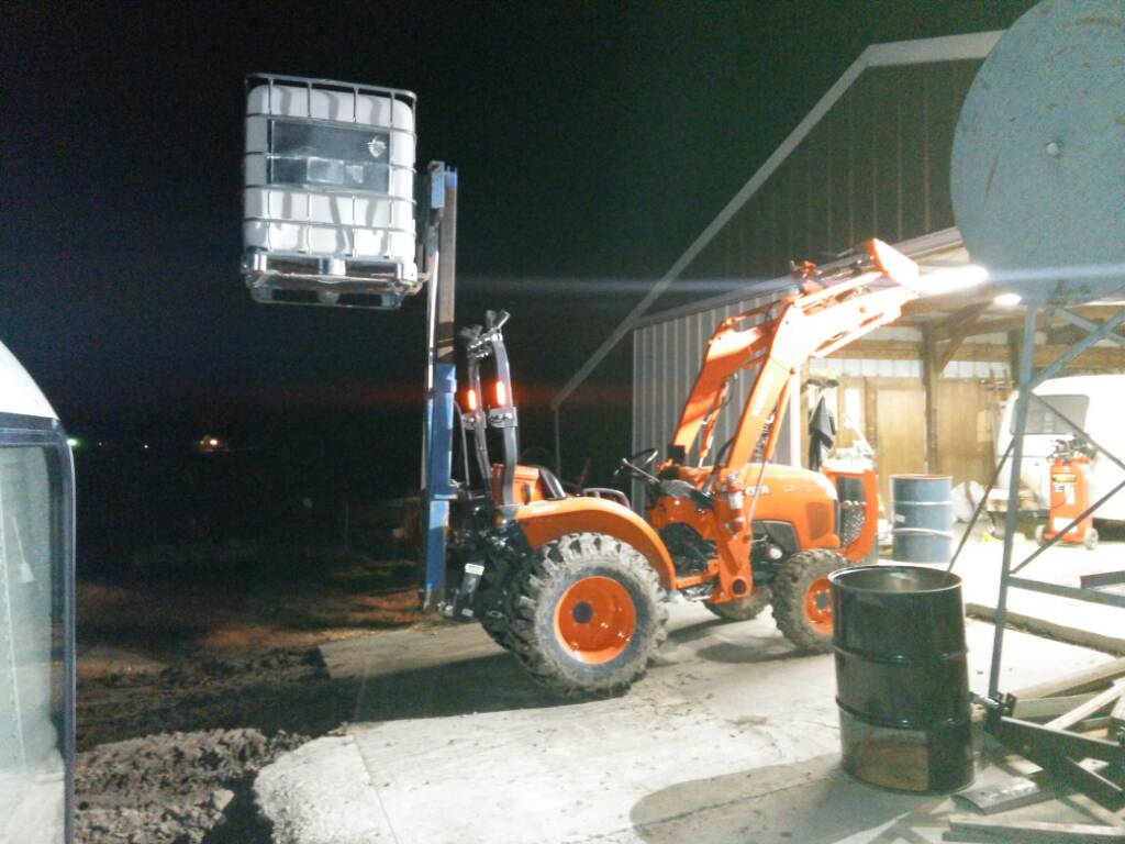

I have SSQA forks & for a while had a 3pt forklift. I got the forklift for $200 & it worked well after new hoses & would lift a hair higher than my loader. However it weighed maybe 500-600lbs & the 250 gallon IBC tote I move water with maxed out my 3pt lift at about the same fill level as it did my loader.
The weight of the lift + the extra length of my quick hitch killed any extra capacity I would have gained. The mast would still lift easily, but not my 3pt & I decided not to push it & break my tractor. Sold the forklift shortly thereafter for a hair more than I had into it.
Also, you really need TnT to maneuver the forks well or dump a load if things aren't perfectly flat & level.

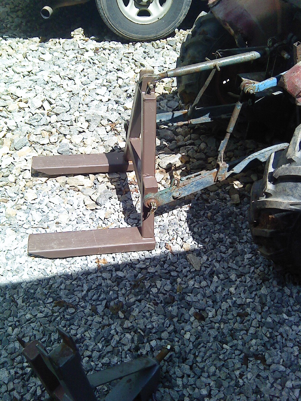

Rob, They are easy even I can do it.

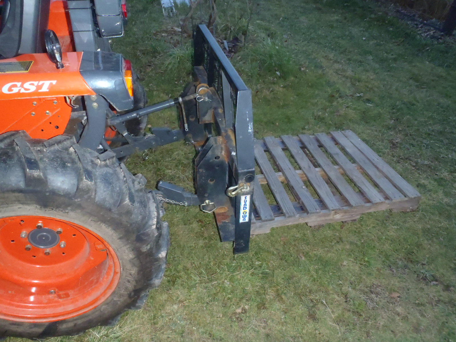

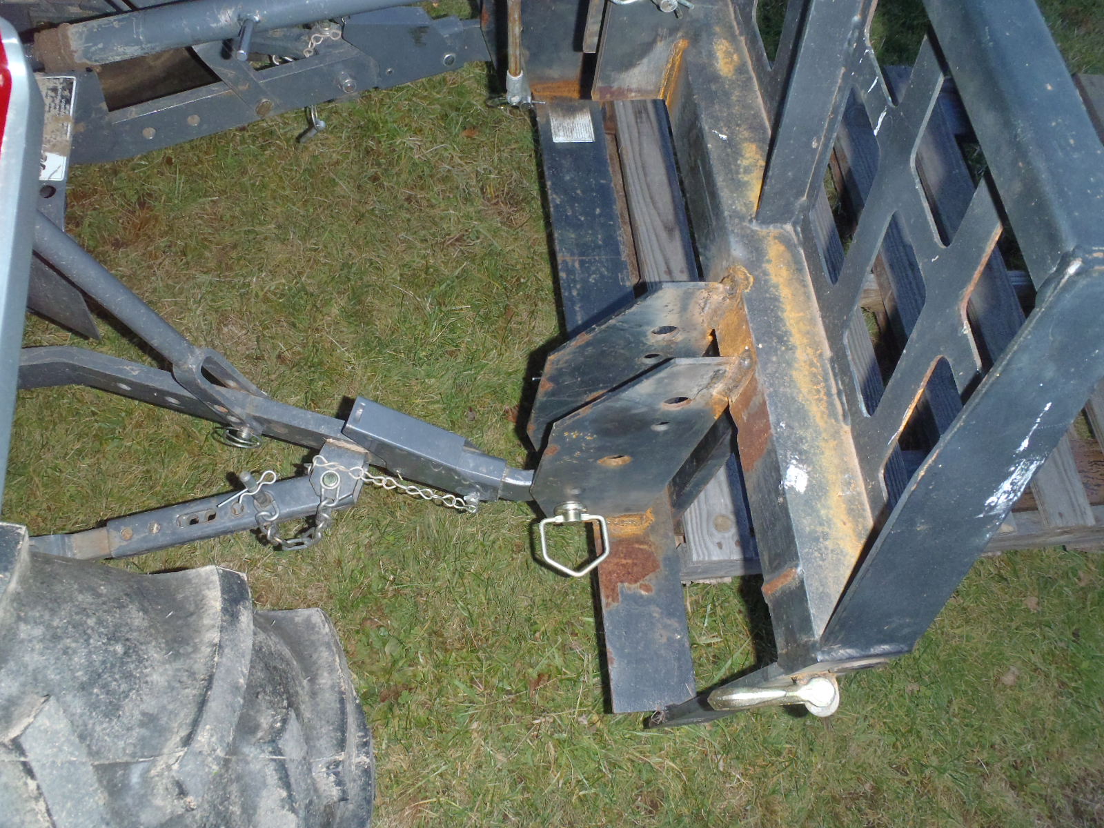

I like that small light 3pt fork setup, just needs TnT.
Here is the forklift I previously mentioned.
