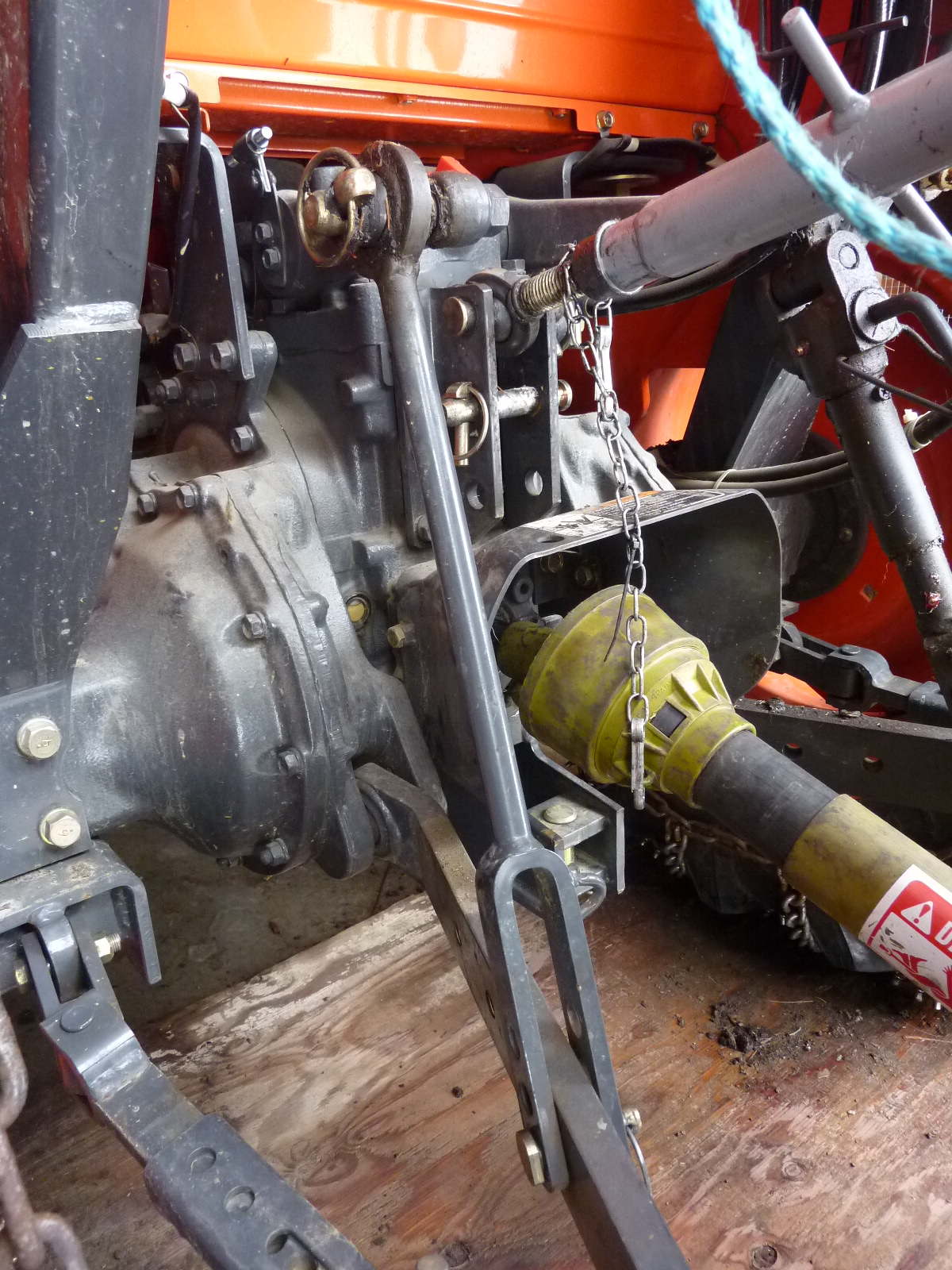

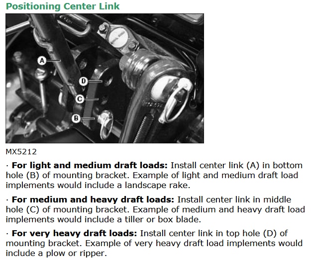

Does your tractor have multiple choices for top link connection? If so the top hole will have the greatest lifting force with the least amount of travel. The lowest hole will have the least amount of lifting force with the greatest amount of travel.
Also the CAT 1 standard for top link height from the lower links is 18".
This was the position choice I was referring to.

Be careful here it can be confusing - A "Draft Load" is not a Lifting Load. In fact it is just the opposite. A draft load is the pushing force the top link puts on the tractor when running an earth engaging implement like a box blade. The dirt tries to hold the box blade back so that the box blade wants to roll forward and pushes the top link against or into the tractor.
When you lift something just the opposite happens. The forks try to roll back and the top link pulls on the tractor.

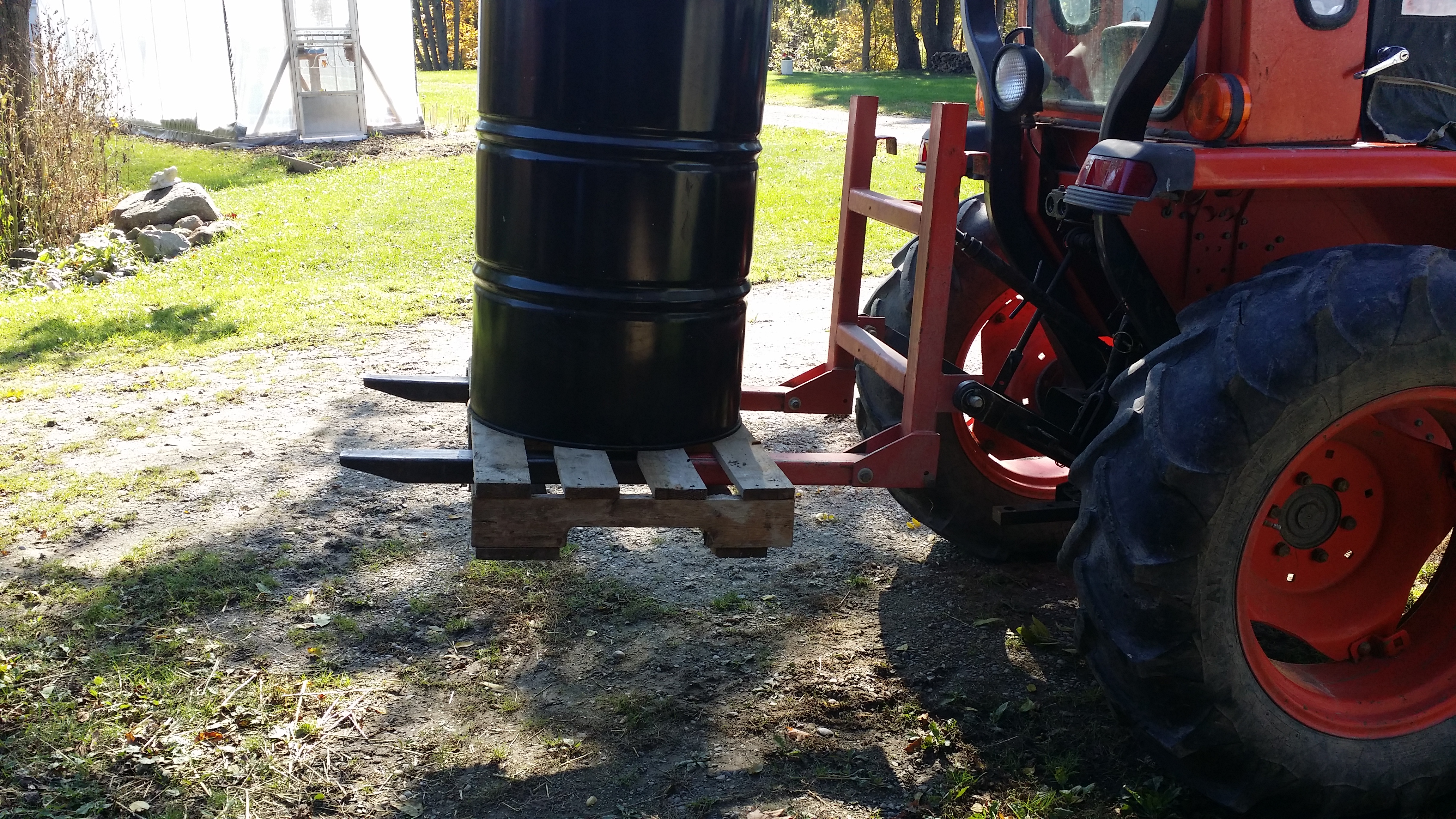

YES !!! Lifting with 3pt forks PULLS on the top link while DRAFT loads is force PUSHING on the top link. Two very different things.
