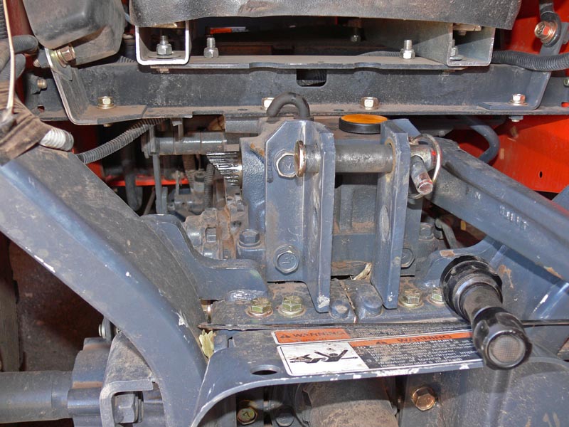

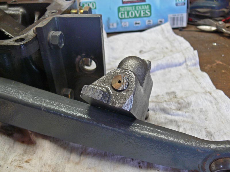

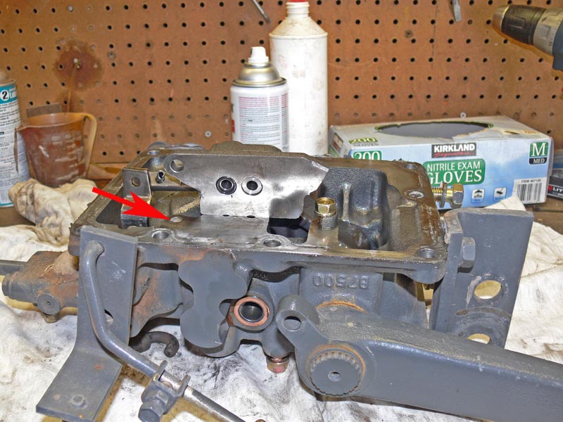

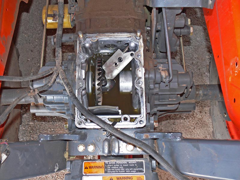

Well, if it had been just the shaft that had broke, it would not have been too bad. Unfortunately, that is the lesser problem. Seems like a bolt broke that holds the control valve assy. The ear on the other end broke & the control valve dropped into the differential gear assy. & it got drove forward & poked a hole in the gear case. It's 3 years old & 617 hour on it. I guess I'll go have a talk with the dealer Monday & see how much this is going to cost me.

What were you doing when it broke?
   / 3 point hitch broke
Pulling a box blade. Tried to lift it. No KTAC.
