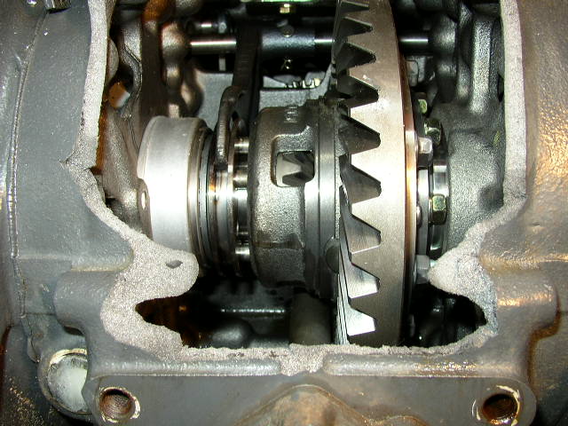

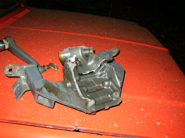

Back in 2004 I posted about an L4610 with broken 3 point. The pictures have since been deleted but because they are somewhat related to this thread I've re-posted a few of them below. I believe the factory helped with the cost despite the tractor being beyond the warranty. If anything it might help Locoweed feel better that his breakage wasn't as bad. The take-away from the L4610 incident was not to draw log butts too high or tight against a 3-pt winch before skidding them out.
