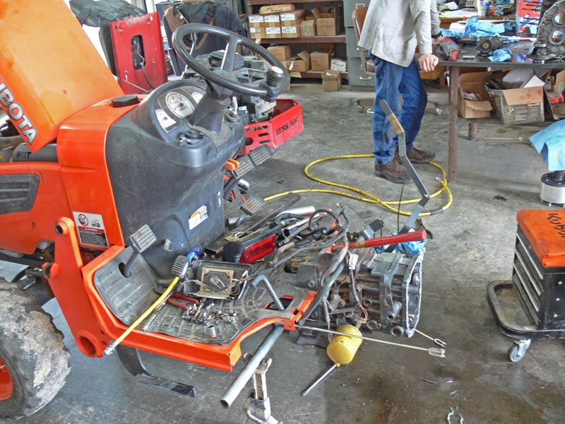

What was the size/weight of your box blade?
   / 3 point hitch broke
#19
48" rollover box blade. 525 lbs.
#20
Update

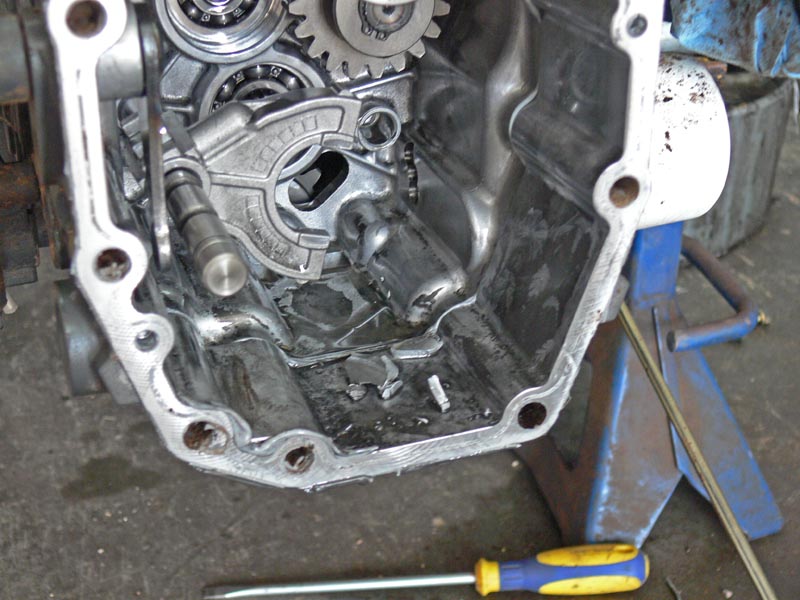

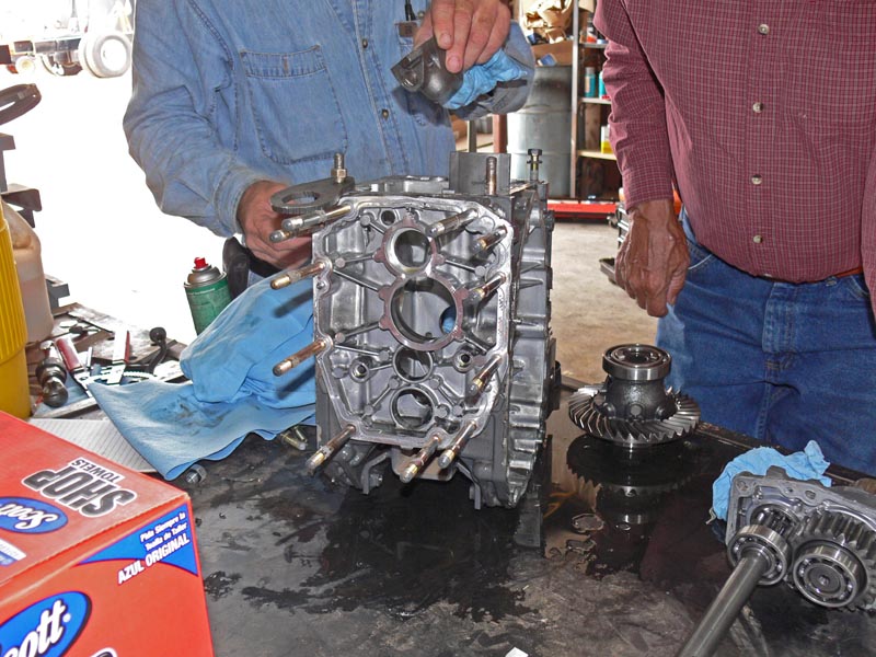

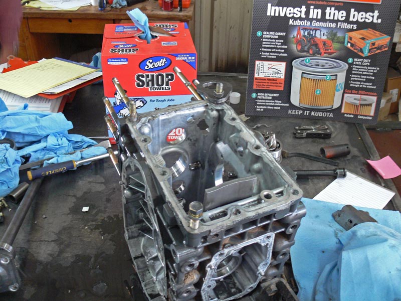

They came & picked up the tractor Friday. Went down to see what else might have happened. Thankfully the only other damage I had already found. The splines in the left hand lift arm were partially stripped. All the parts are supposedly in the Texas warehouse. The 3 years on the warranty had expired on June 26. The problem occurred on July 5. Kubota is going to help with parts cost. How much I don't know yet. Here are some more pics.
