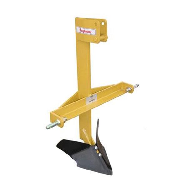

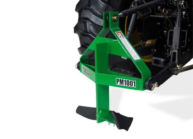

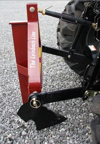

I am new to the forum, and new to the world of tractors and implements. Few months ago purchased my tractor (Kubota 3300) and now it's time to build a middle buster and cultivator. Looked at many pictures for middle busters, and they are all somewhat similar. what I can not figure out - and maybe it's not important at all but still - is why the vertical part that holds the shank of the buster is almost always welded behind the horizontal part that goes between the two points of attachment of the hitch. is it not stronger to have it at the front?

You get a better brace from the back. Ken Sweet

While by only a small amount, having it behind allows it to lift higher also.
Front is likely stronger by a slim margin, but as they are designed now, they would bend before that becomes an issue, no matter weather its front or rear.
/ 3 point hitch construction - another (simple) question #4
the way most of them have the flat bar truss there stronger in that configuration than if in front, to be as strong one need a large tube or angle to equal the strength of that flat bar truss,

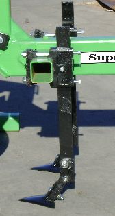

if you want a little more veritilty fix it so the breaker bar sill move up or down and use a heavy tube for the bottom cross, and get the bottom attachment with a shear bolt construction,
made a corn cultivator with similar shanks but 7 of them on a tool bar, 4x4 heavy steel tube, and would run between the rows of corn with a sweep on the bottom I have some rock hills and was thank full for shear bolts save a lot of bent things,
now on a small tractor you would probably break traction before damage is done,
I bought parts form a company called "Roll a cone",
Shanks
Shank Holders
the picture is more of an idea what one could end up with (for a middle buster ) you would only have one shank,

Because as Ken said, you get a better brace. When located behind, it is pulling(tension) rather than pushing(compression), which in theory could twist the vertical shaft easier. If you look at box scrapers the ones that are crinkled are almost always bent from pushing back to hard on something, rather than pulling and snagging something.

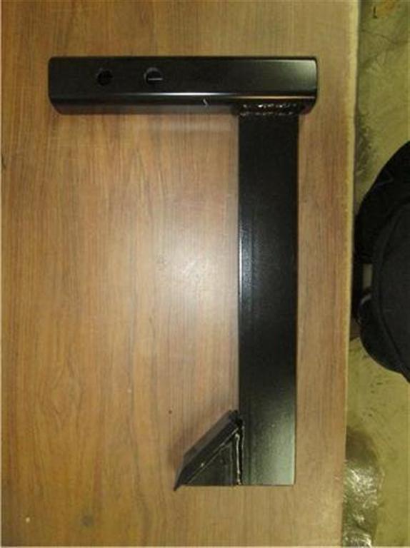

The one I built is more of a ripper shank than a middlebuster. And has a knife edge at the bottom.
I built it with 2" x 4" x 1/4" tube. But that is likely overkill.

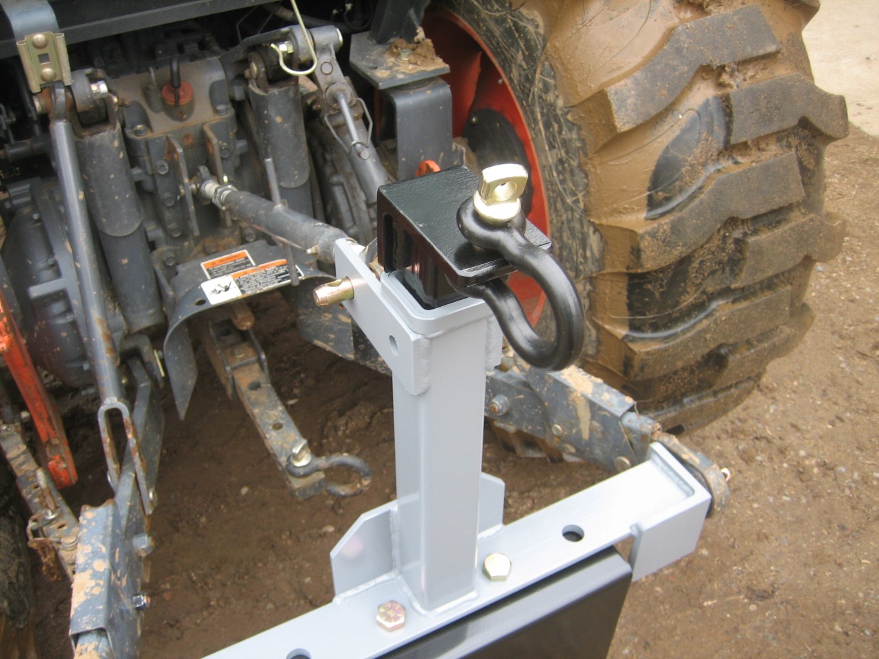

You could copy this design, if you have a 3 point receiver hitch.
And the most versatile hitch design.
Pictures from: TRANSFORMER Quick Hitch Compatible Platform - OMNI Mfg LLC

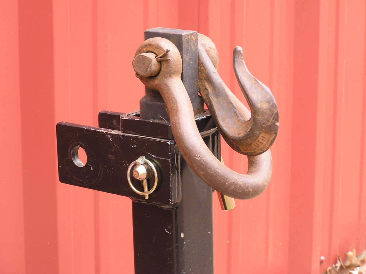

This is the one that I have:
