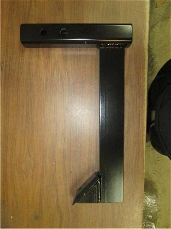

The one I built is more of a ripper shank than a middlebuster. And has a knife edge at the bottom.
I built it with 2" x 4" x 1/4" tube. But that is likely overkill.

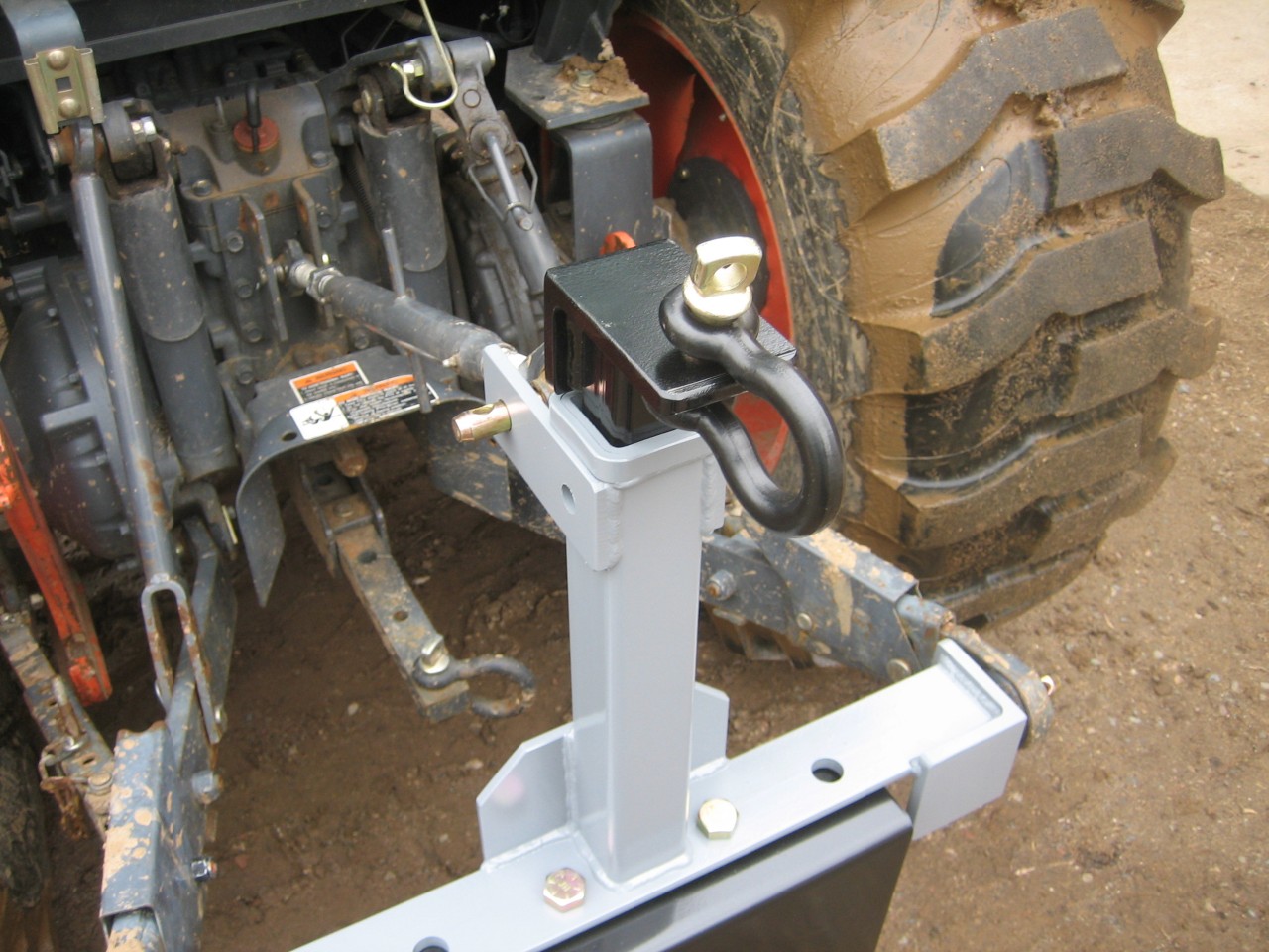

You could copy this design, if you have a 3 point receiver hitch.

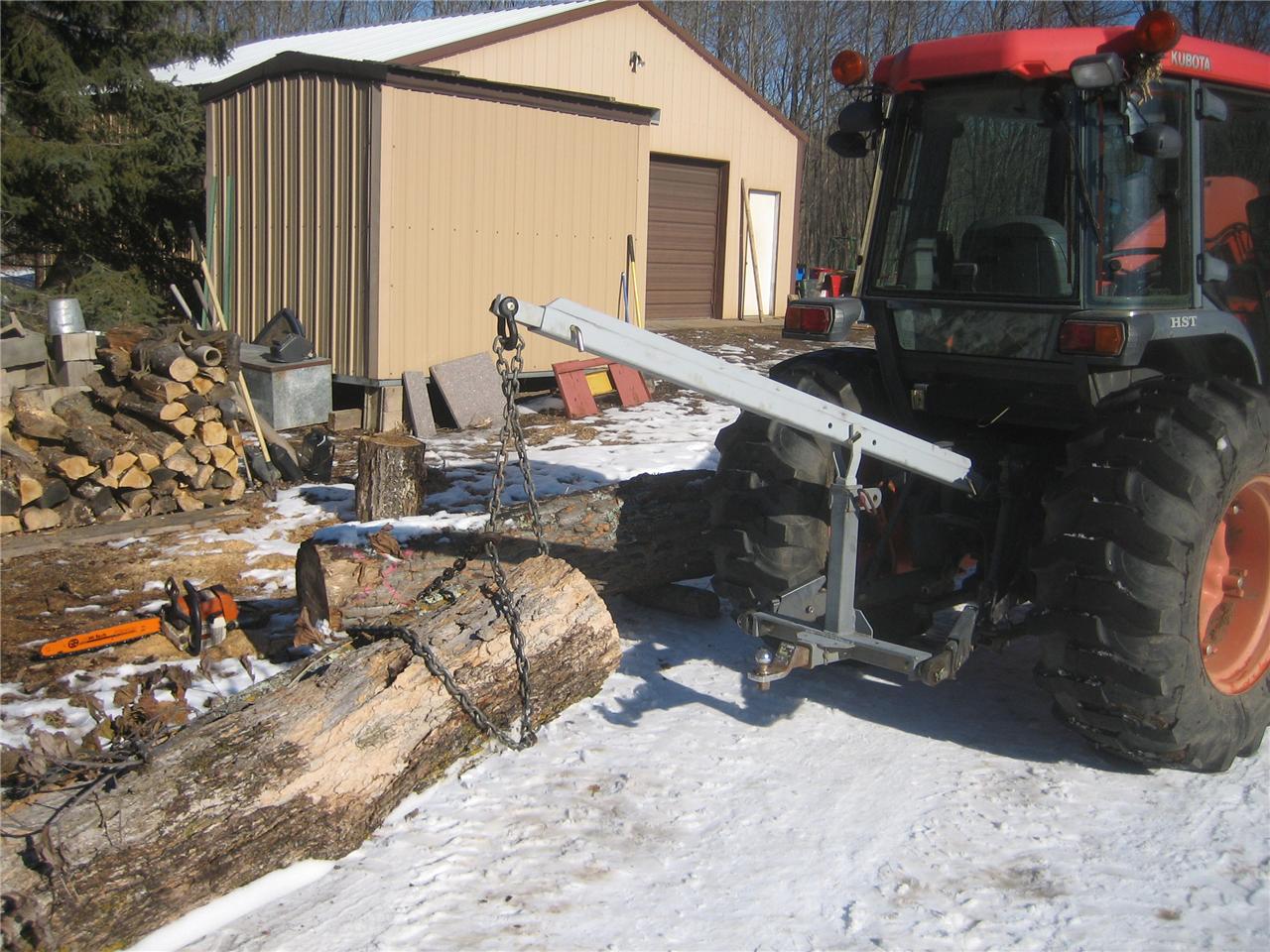

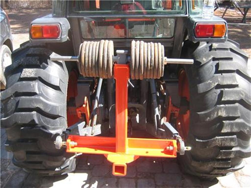

And the most versatile hitch design.
Pictures from: TRANSFORMER Quick Hitch Compatible Platform - OMNI Mfg LLC

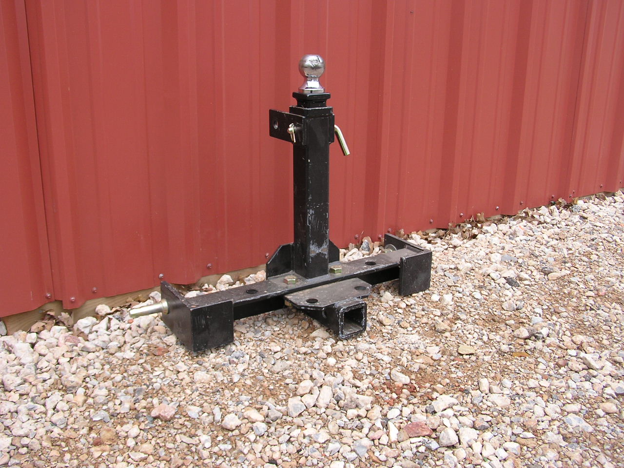

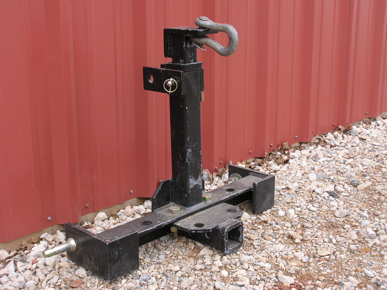

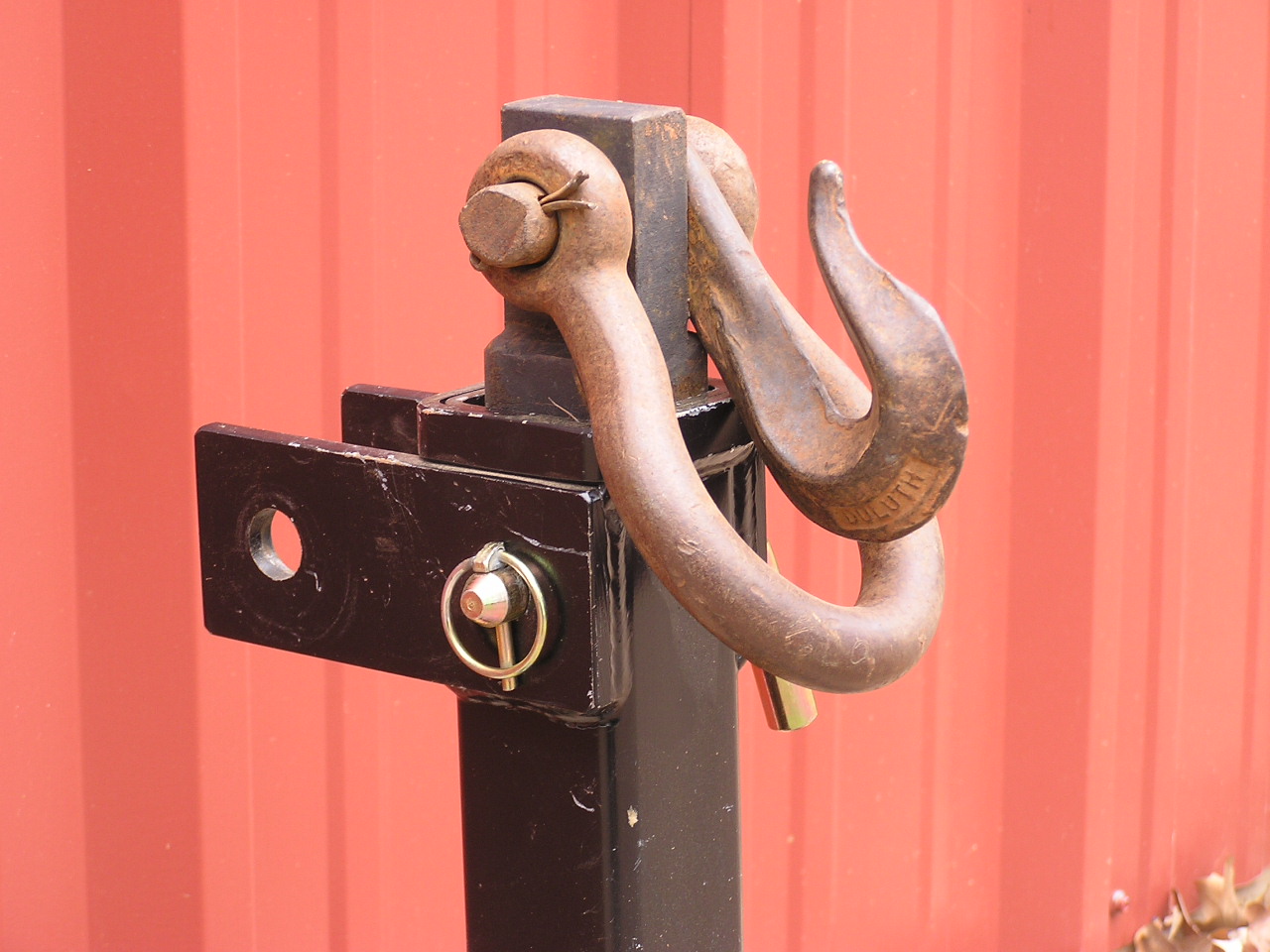

This is the one that I have:

Over kill is better. These attachments take a tremendous amount of strain and stress. It doesn't take much to really tweak them outta shape if they're not built heavy enough. Have fun and good luck with it.
