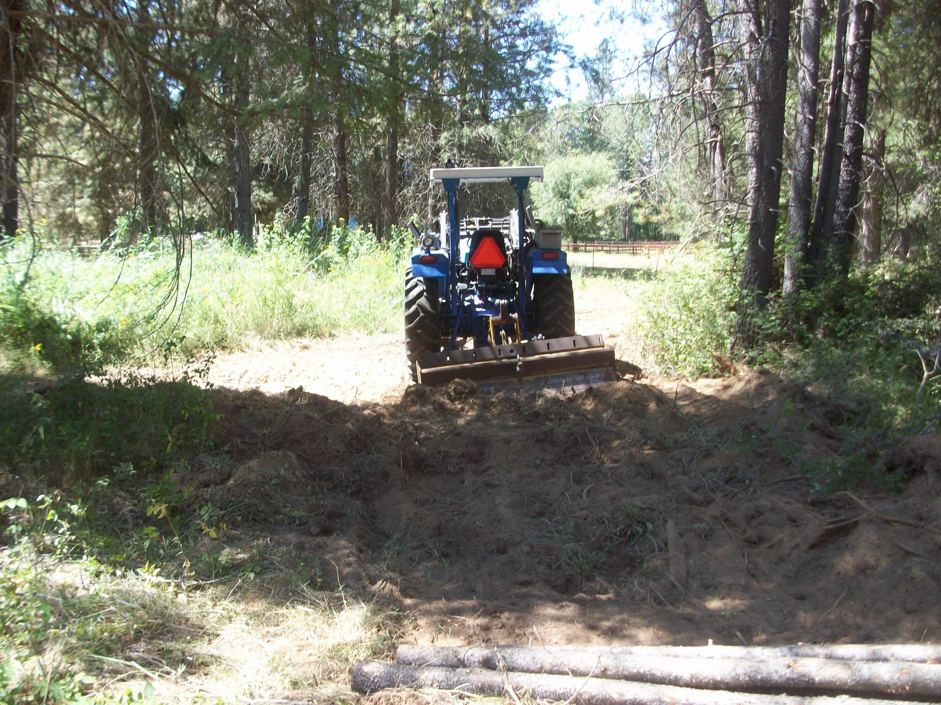

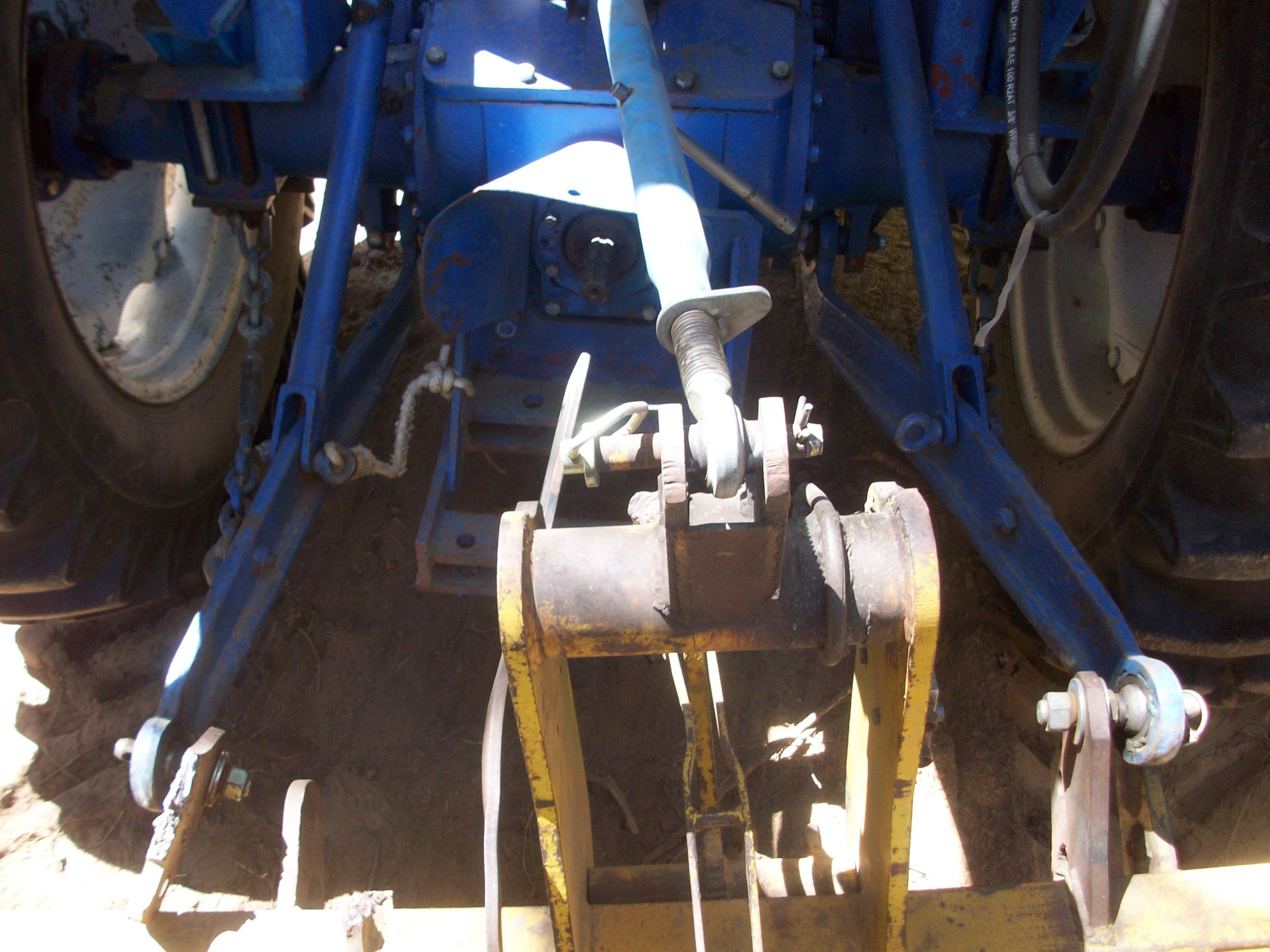

Pushed with mine the other day and caught a root- wife said the left rear tire (14.9x28) was almost 2 feet off the ground and almost backed over the left side of my old gannon boxblade:ashamed::eek:
Luckily i jammed the clutch in and the tractor rolled forward and dropped down. Had to look and thought I had mangled the 3 point.
Turned out it actually broke the welds the previous owner of the box blade had modified for pin placement on his 90 hp Case.
Had to grind out the welds and weld the mount back on .
Was happy to see there was no damage to the 3 point and will try to be more careful in reverse with the box blade.
