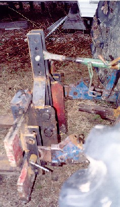

yea making the toplink mount adjustable is very helpfull, especialy if you dont have a hyd toplink, i made a set of forks a while back and at the time had no hyd toplink so i made 5 holes for the toplink, it worked nice to vary the tilt of them
