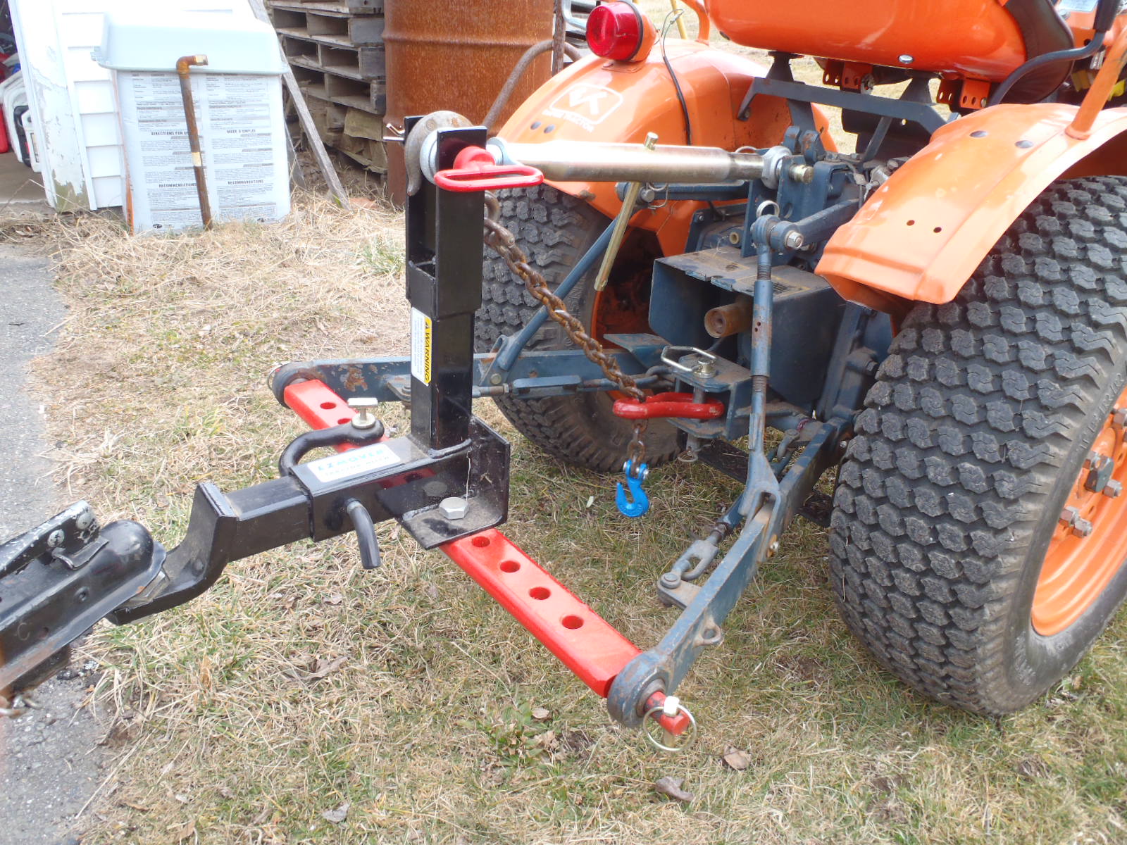

Since the 3pt has no down force, it's important to keep the tongue from lifting while you are moving. Here's how I do it:
   / 3 point hitch Draw Bar #18
Here's mine,the flat bar came with a Kubota - I added the top link.
The A frame of the top link lifts out so the bar can be flipped over.
More recently made another one from scratch - this time made the "A" wider.
As the hitch pin/ball don't protrude backwards the turning ability of Mk I is a little limited.
The big advantage of a linkage mounted pin/ball is that you can just back-up,lift and go. Just requires some common sense from the safety perspective.
