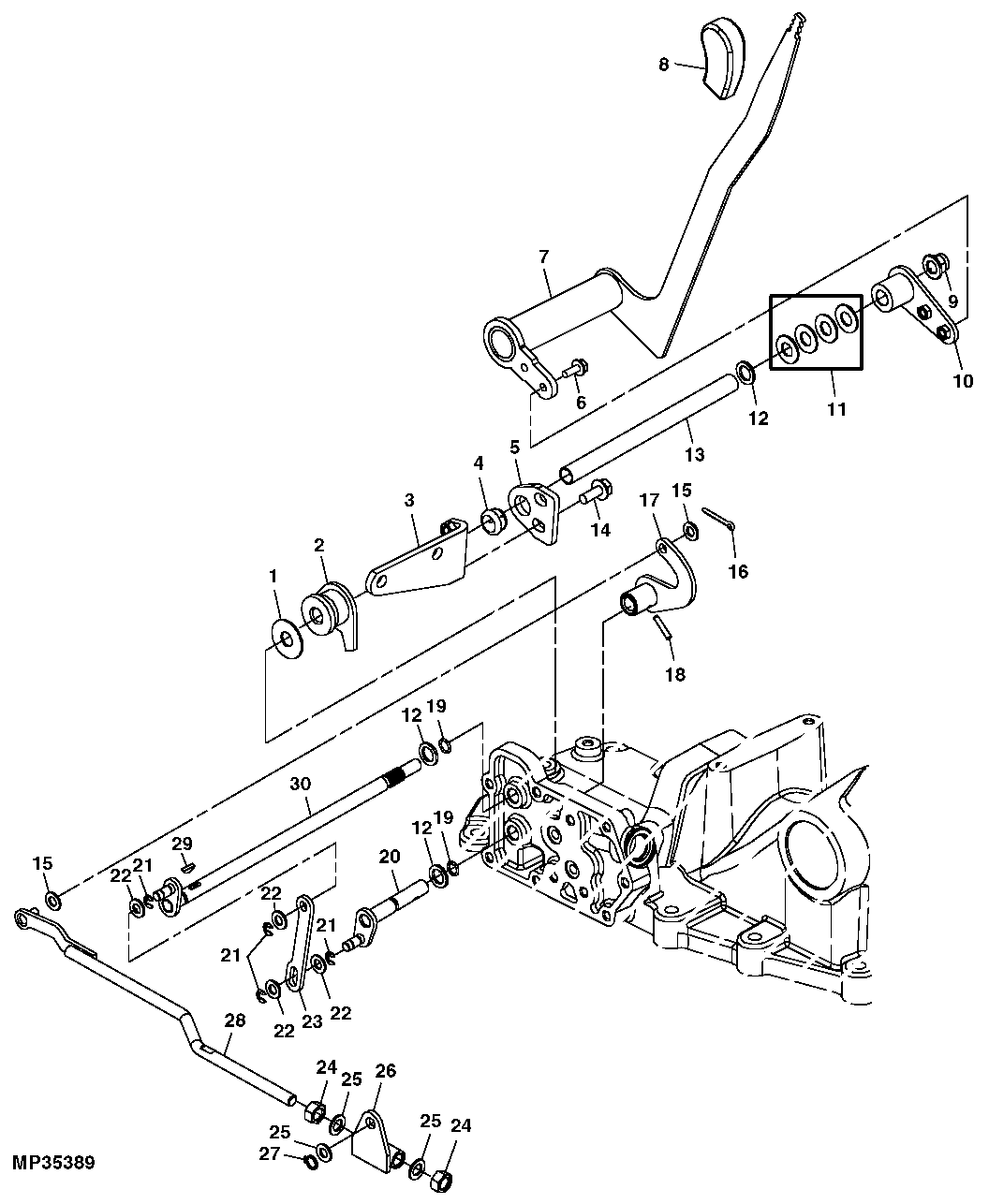

I have a Deere 3203 and have to tie the 3 PT control lever to the seatbelt bracket to keep it from falling. When its all the way up it will stay there but other than that it drops fast unless I hold the lever , it has nothing to do with the control knob under seat. 782 hours and this is my biggest problem so far.
I don't have a tech manual for your tractor but there has to be a way to put more tension on friction washer(parts key #1) or spring washers(parts key #11) so as control lever(parts key #7) moves only by pressure from operators hand.

Here's a link to the 3 ph/rockshaft schematics on the 4310. Under pictorial index, scroll down to 70-1 then down to 10,12,13,14-
