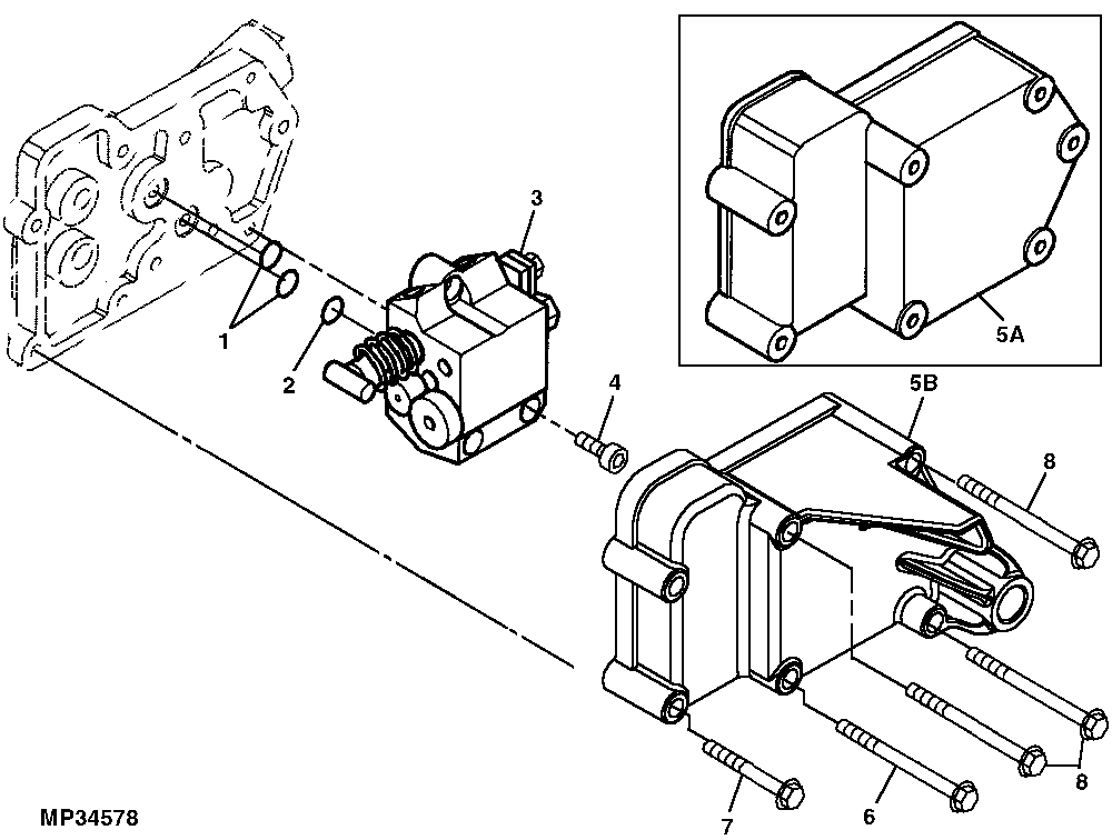

Well after playing around with it some more I am leaning towards the problem being the valve body seal. I've been playing in the snow some more and noticed the rear blade slowly dropping almost completely to the ground. I noticed that the 3PH lever did move down some (less than an inch) but the lever movement did not seem proportionate to the amount of drop that the rear blade moved. My gut feeling (and I have no idea what I am doing) is that pressure is being lost somewhere which allows the blade to drop down.
Now I just have to find out exactly what and where the valve body seal is and how to fix it.
Here ya go-
John Deere - Parts Catalog
   / 3 point hitch: How to keep it raised?
#24
Is the control valve #3 (part# LVA12134) in this picture (assuming it shows up on here). Would I need the whole part or is it the o-rings (#1 & #2 in the picture) that need replaced?
I am still going to see if I can tighten up the 3PH lever just to be sure that's not the problem but my gut is telling me there is more to it than that.

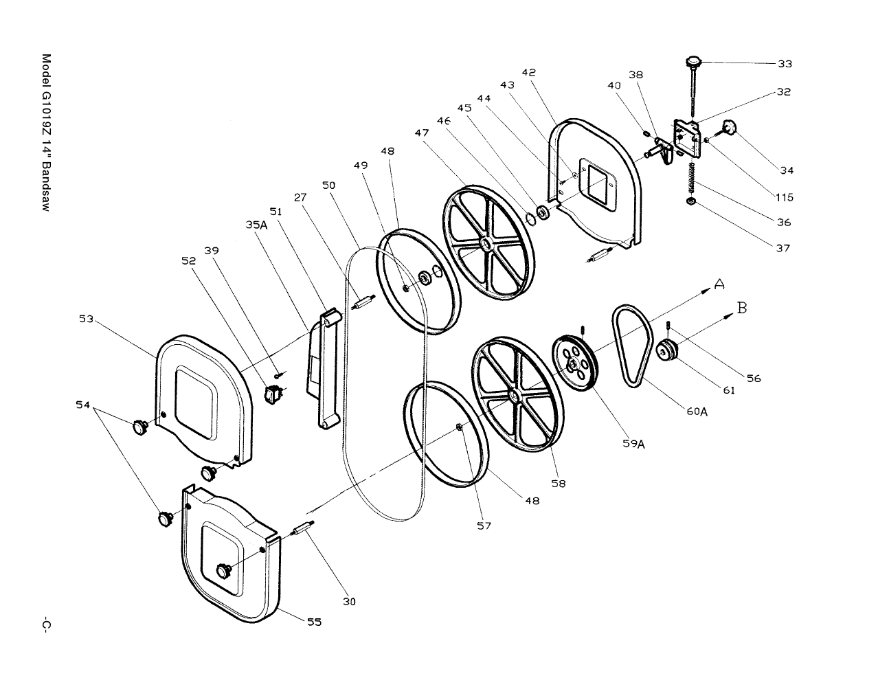

Disregard the band saw picture. I don't know what I did to put it on there.....or how to delete it

Is this what I should be looking at? It is the "Rockshaft cylinder head and piston" on the JD parts finder website. I can't seem to find the exploded view of the "Rockshaft Control Valve".

Here is the rockshaft control valve picture from their parts lookup site
http://jdpc.deere.com/pimages/MP34/MP34578________UN16JUN04.gif
Here are the corresponding parts to the numbers-
ROCKSHAFT CONTROL VALVE
Cart key PART NO. PART NAME QTY SERIAL NO. REMARKS
1 R28776 O-Ring 2
2 T26209 Ring 1
3 LVA12134 Control Valve 1 - XXXXXX (SAUER DANFOSS) (SUB LVA15586)
LVA15586 Control Valve 1 XXXXXX - (HEMA) (SUB FOR LVA12414)
4 19M8446 Bolt 3 M8 X 20
5A M136629 Cover 1 - XXXXXX
5B LVA12779 Cover 1 XXXXXX - (INCLUDES BUSHINGS)
6 19M7913 Bolt 2 M8 X 90
7 19M8319 Bolt 2 M8 X 50
8 19M8874 Bolt 3 M8 X 75
