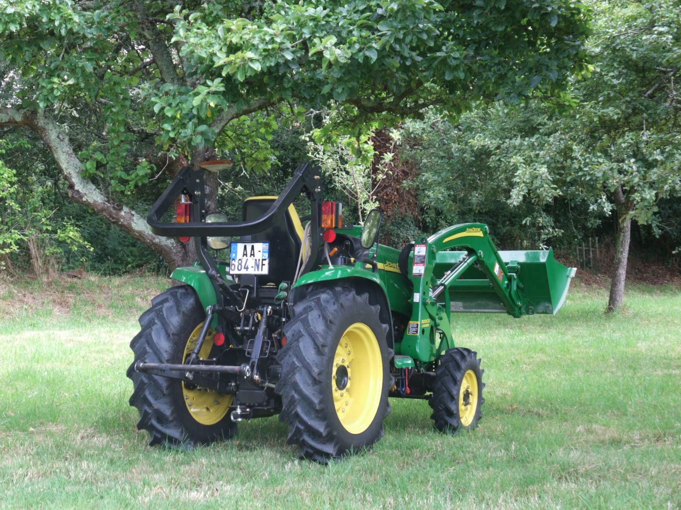

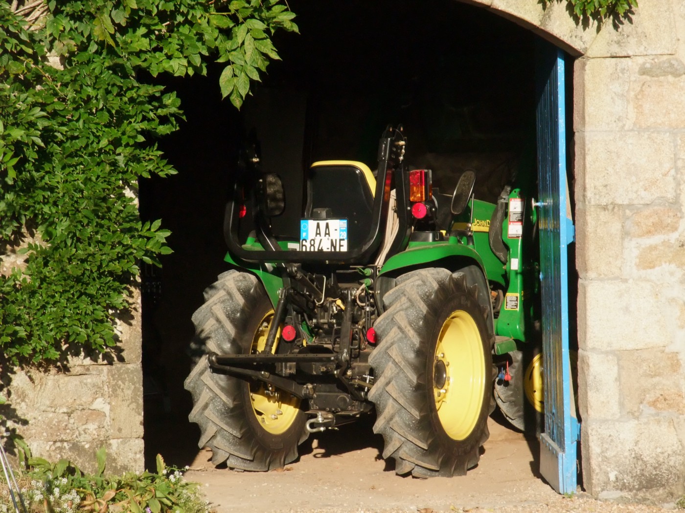

When mine will not be used for awhile I always lift them up. The manual even says this fills the cylinders with fluid and prevents corrosion.
My opinion is you are smart to leave them up when no implement is attached for this reason alone.
I don't think it was a silly question either.

Would I be correct in assuming the tractor Hyd pump will be working to keep the lift arms up? Ken Sweet
No, its hyd fluid locked in a cyl by a valve doing the holding. There is a position sensor that acts to valve in make up fluid if the cyl leaks down 1/4 inch or so. Most leaks are so slow that make up fluid is rarely called for ... but when called for the pump works for a short time to supply that fluid at the pressure required to raise the arms back to the set position.
larry

Mine are down when parked, as I normally have either an attachment or the ballast box on the 3ph. When parked, the attachment is lowered - for safety of anyone accidentally bumping the control lever. Also, to take the weight off the 3ph arms. When moving about, the 3 ph is up (again, because there is something attached).

Under the section on safety, my operators manual says this.
Before starting engine make sure rockshaft control lever is in forward (equipment lowered) position.
Do not leave an implement in the raised position when it is not in use. Always lower implement to the ground when tractor is parked.

I keep them up all the time as high as can be unless im using an implement dant want something to hit the ground and break.
