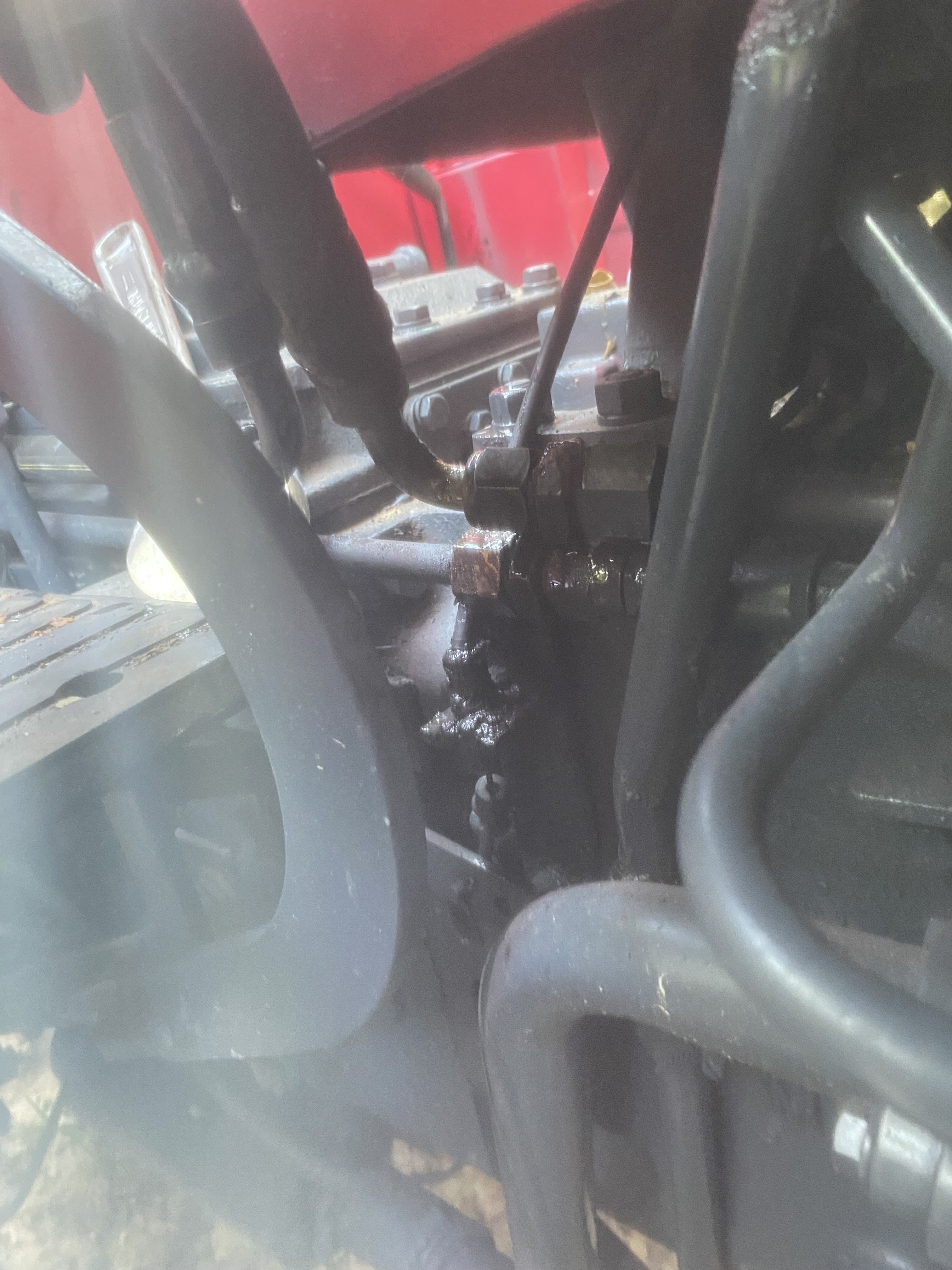

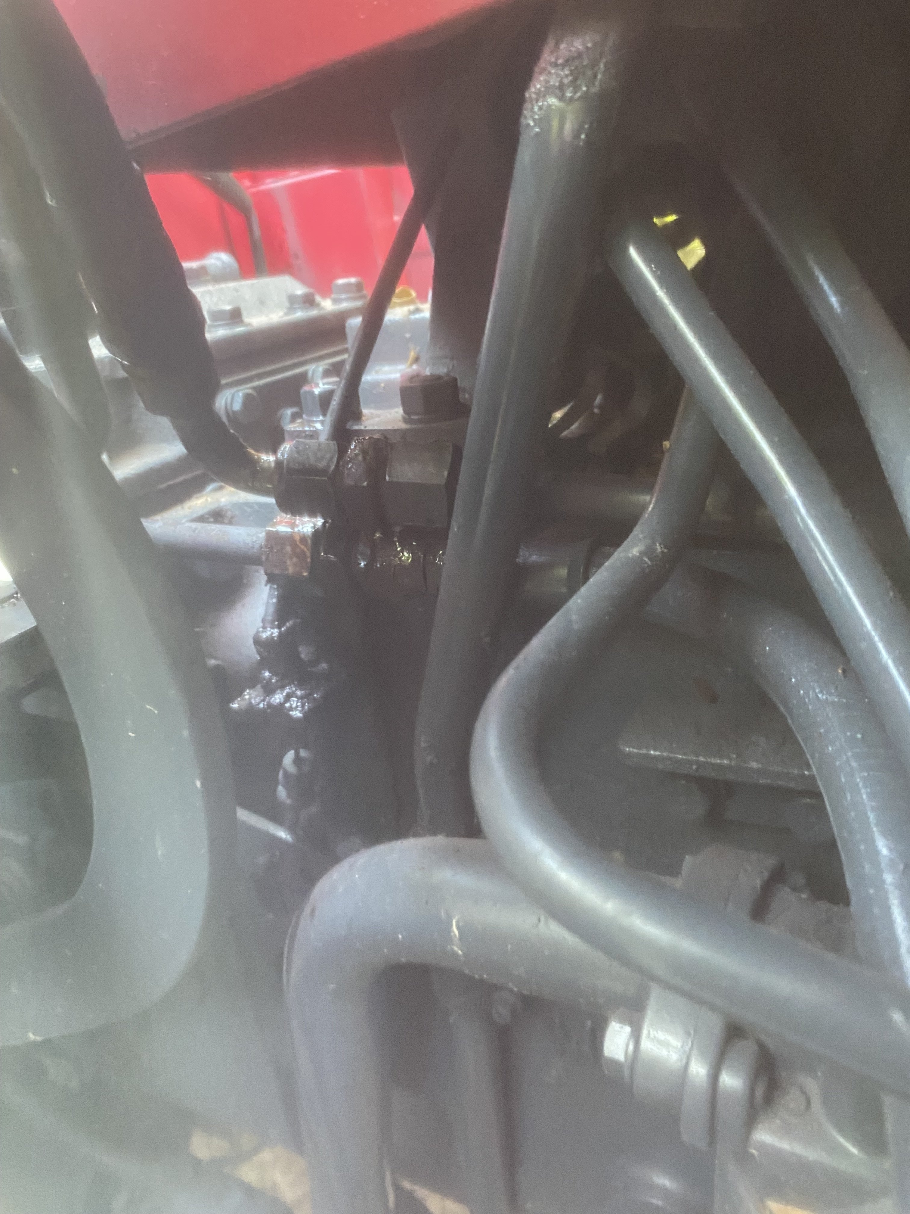

/ Mahindra 4530 help
#9
There is a line on the far left of the picture, it goes to the back it looks like, then there is 2 on the right, the middle one is pressure I think

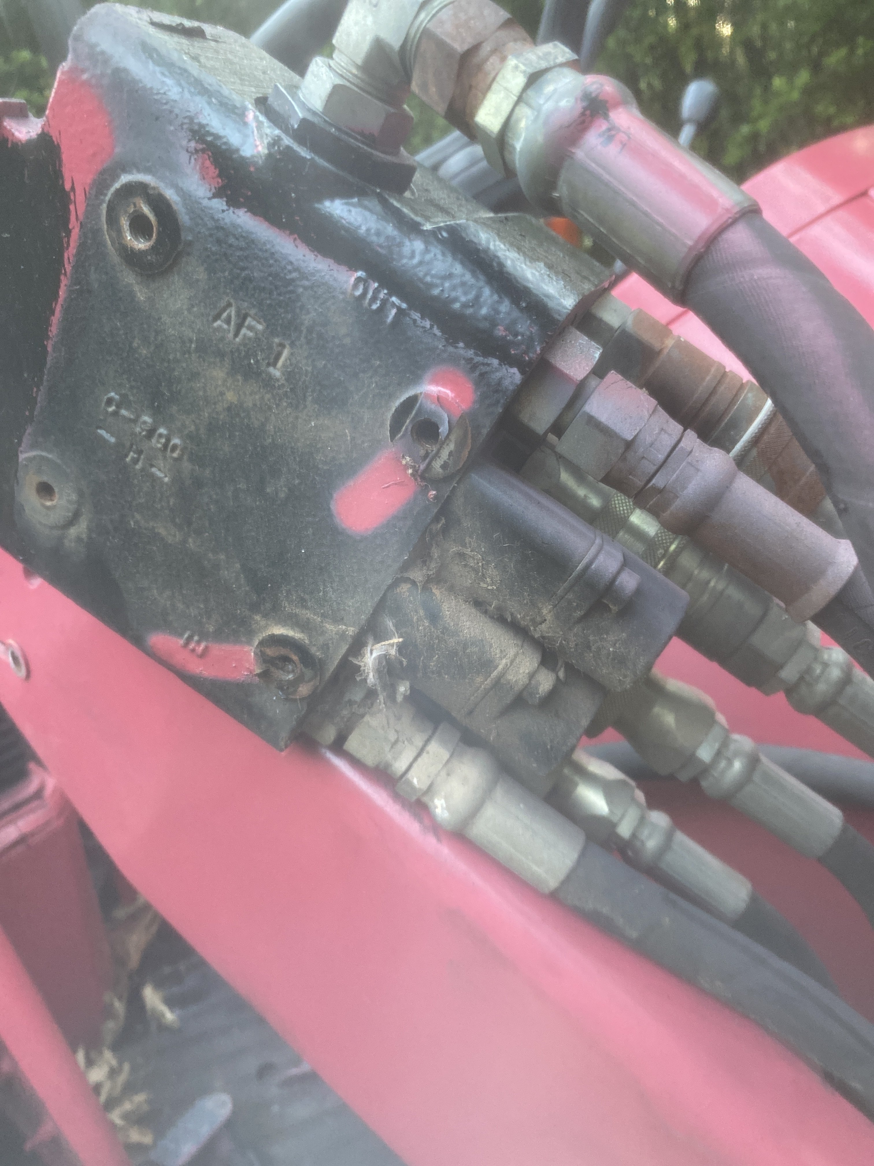

#12
I see there is a in and a out, also one hose on top that im not sure on, it doesn’t say anything
/ Mahindra 4530 help #13
Try to switch the two hoses on the out side and see what happens.

Just wanted to tell you thank you so much! This has worked! All I did was swap the 2 around
