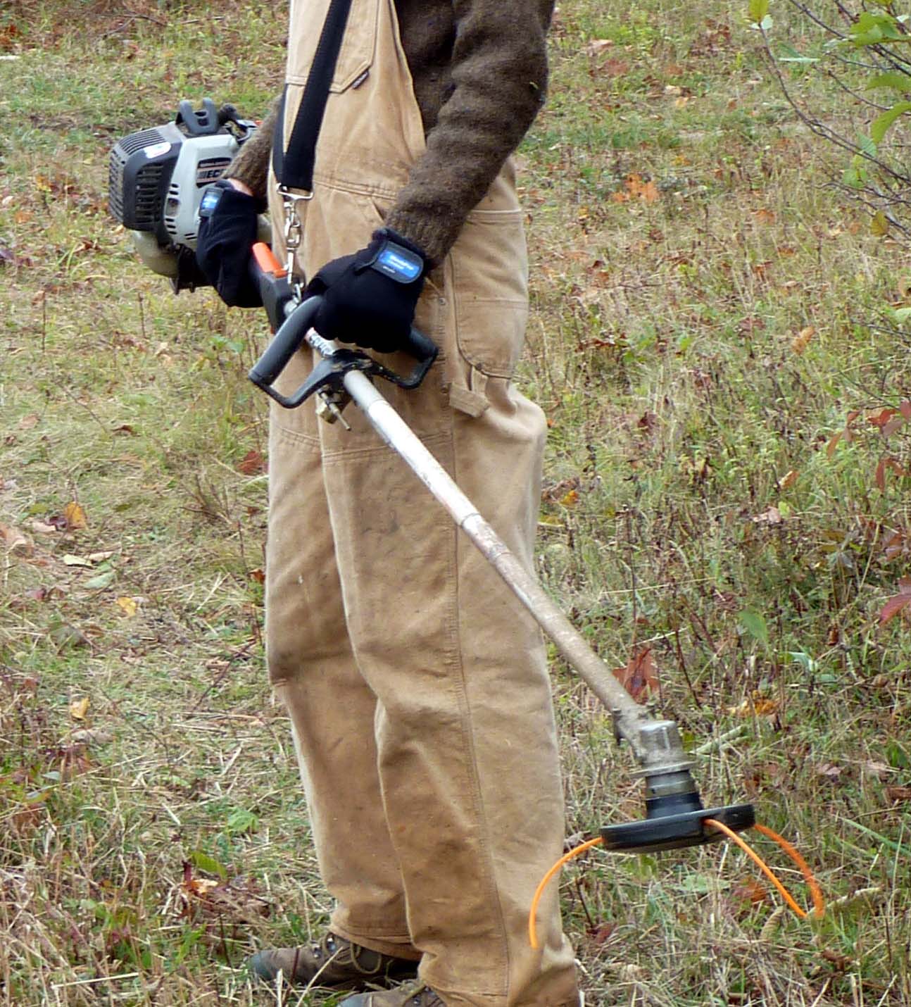

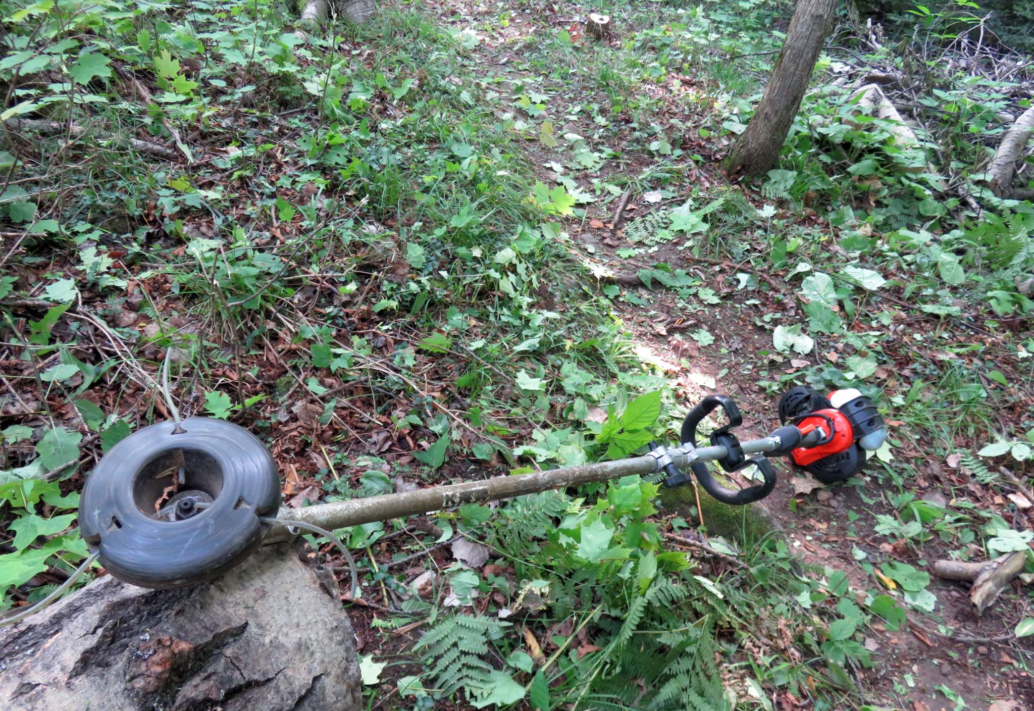

Looks like regular string trimmer plastic to me. We use the .155 version by the roll but looking to try .170 or 180 which is a bit harder to locate on our whackers. PHpaul do let us know which string you are using and do show its attachment system.

The string head is off a Craftsman walk-behind trimmer and the string is the heavy plastic with a square cross-section. Not sure what size it is. Edit: I went out and measured it. It's .180 measured on the diagonal.
I cut off a 6' length, cut it in half and thread it like this:
Leaving two approximately 16" pieces on each side to do the cutting.
