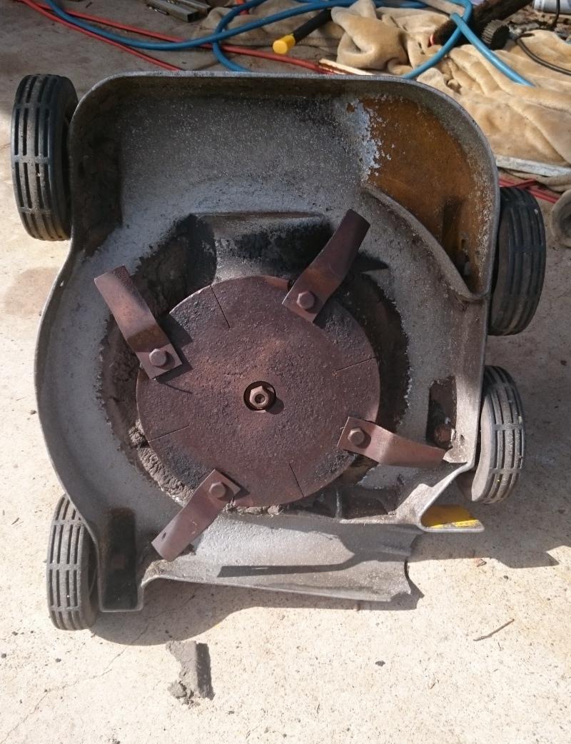

What kind of RPM are you shooting for? What would recommended be?
   / 3 point hitch string trimmer, Mark II #12
I'm not sure but will guess you mean this type of swinging mowing blades. But I agree, that stings do not need a shear pin.
I've been thinking about building something like this. Might go with swinging blades for a disc mower instead of string.
You don't need a shear bolt on belt driven mowers. Finish mowers don't have one. They depend on belt slip.
Yes that is kind of what I was thinking. A mini bush hog of sorts. I have an old 4' Befco finish mower I could use for a gearbox and some other parts.
I was thinking of the disc mower blades they sell at TS for hay mowers. A 6 pack is $9.99 and a pack of the shoulder bolts is $29.99. The blades are available in flat, CCW, or CW configuration.
I have one of those Craftsman walk behind trimmers but I would never cannibalize it for a project like this. I HAVE thought about just drilling a couple of holes in it and mounting the mower on a boom. The heavy trimmer line will last a good long time in any type of grass but it doesn't take much of a stick to break it.
I don't think anyone was suggesting a shear pin for the driveline. I was asking about something in the frame that would give way before something bent...in the event of daydreaming while driving through a gate, garage door, past a tree, clothesline, wife's brand new car, etc.
Ahh okay. I misunderstood the question. Guess you could hinge it at the transfer shaft or something and put a break away pin on the front.
