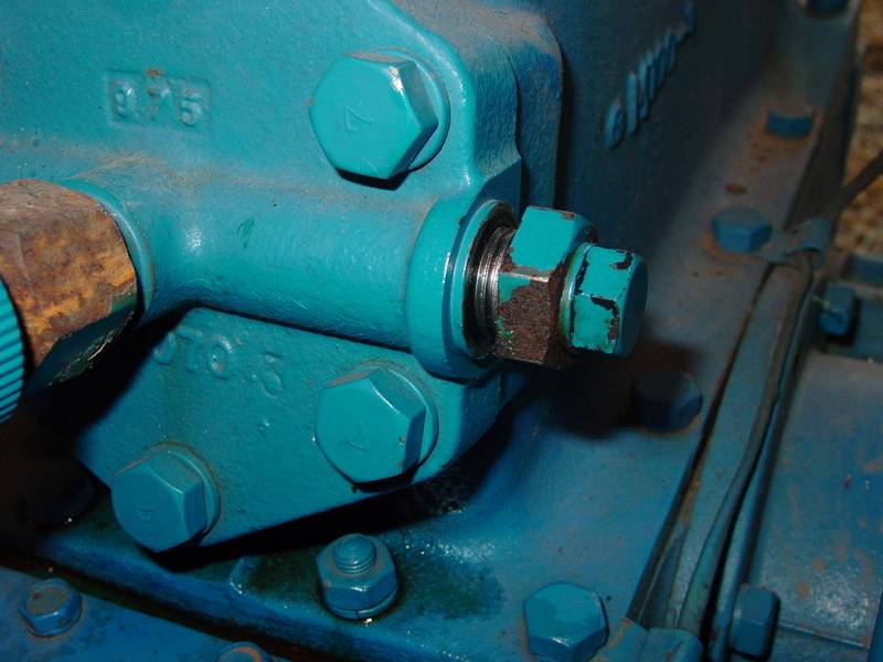

I guess I'm confussed... Isn't the valve assembly what you've pictured with the springs and ball bearings? More importantly, isn't this what I'm supposed to take out to run the test for flow?
Or am I supposed to take out the plug on the opposite side to test the flow. I believe this plug is where a pressure tester is screwed in so I'm somwhat hesitant to have it open with maybe 2200 psi hyd fluid shooting at me.

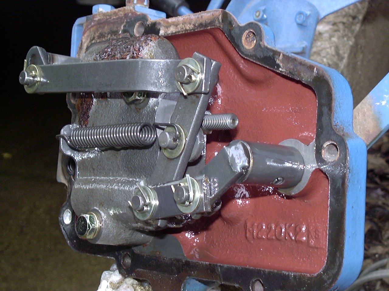

We use terms valves, spool valves and check valves kind of loosely. What i recommended not messing with is the spool valve. Look at the pic below.
you see the banjo connection, that is the discharge from the top going to main pressure relief device and the spool valve itself. Don't mess with that yet. in the previous post I showed how the valve looks from the inside of lift housing. The spools are highly machined rods with porting and such that it is difficult to open up and put back together without damage.
No, you will not get 2200 psi shooting at you if it is full flow. pressure is cuase by resistance to flow, I still don't stand in front of it or Pull " Curley":D with Moe and Larry watching. Conversely if you read 2200 psi does not mean you have flow. I can flow 0.1 gall/minute @ 5000 psi. Your tractor I think should have about 5-7 gpm so with the system open you'll get a heavy stream of low pressure fluid coming out. @ 7 gall/minute you put less than a gallon of fluid in a 5 gallon bucket.

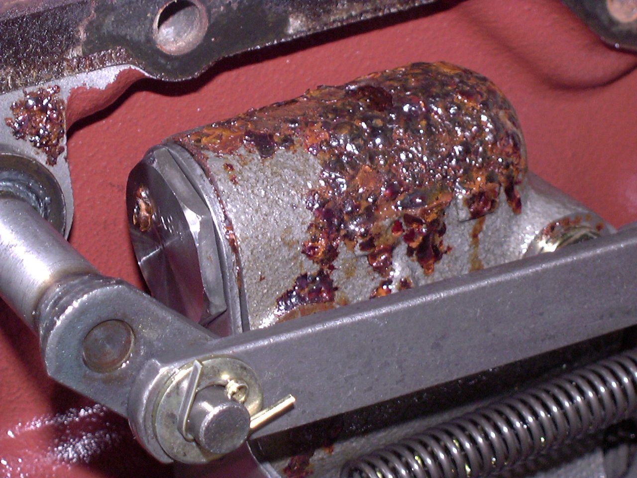

I did what he said here's what it looks like.
I'm trying to find out what solvent to soak it in and should have it back together later this afternoon.
It was really easy to take apart and JC is right about how great the engineering is on these tractors.

Hmm, What you have in the picture is 3 point lift spool valve. The thing I suggested not to dork up till as the absolute last option. Look at the pdf below that shows the innards of the spool valve. Taking it off is not what I'm concerned, it is putting together after cleaning without damage:eek:. I see evidence of moisture and rust on the spool but what's going on inside I don't know. What kind of solvent is he talking about as as I'm concerned with damage to orings if wrong solvent is used. If you just soak it in solvent it may just clean the outside but the blockage is in the inside of the spool area. As you manipulate the lift arm the two parts of the valve will separate ( the spring will be stretched) causing the spool to move in and out and that may be enough to spray wd-40 in there for a bit of soaking and then air to blow it out.
Now, does your FEL work? if it does , the tech is right about the flow and the pump , I don't think you have two stage hyd pump on 1710 and one pump does both 3 pt lift and implements like FEL.
If you really feel brave and adventurous, I'd take the tie rods and spring off, and remove nut #6 and #9 one at the time to remove spool#24 for inspection and cleaning if needed. I'll do the same for hyd valve #12. There is a bunch of nick knacks in there that you may not be able to buy individually and may be forcing you to buy the whole spool. I think that should run you maybe a little less than the hyd pump but still pretty pricey. I hope that guys would chime in with their opinion.

I didn't expect you back (or online) today. Wish I had waited...
What I posted before about his comments 'were' accurate as of yesterday. What he failed to tell me was I would have to take the thing apart; yesterday he said, take out the 7 bolts and soak it.
I called him today regarding what solvent to use because I had the same concern about the o-rings and he said gasoline or naptha. That's when he told me I'd have to take it apart.
I didn't get your response until just now so what I've done so far is to take off the linkage and remove the valve assembly from the mounting plate. I have not, nor intend to, jack with the 2 double nutted adjusting rods.
I couldn't get the 2 bolts (#6 and #9) off the front to get to all those very small and numerous parts so I'm soaking the whole thing. I doubt this will work in that on the top of the housing is a hole and that carmelized rust you see has made it down into that hole and the guts of the assembly.
Little bit of WD-40 on the outside and a dremmel tool and brass brush can do a good job on rust removal. Are you sure that the rust is all the way through ?? :( If it is... (hard to believe) I'm sure the spool can not direct the flow properly. look at the pic below., that is the normal safety relief valve that returns fluid in to the sump thru the spool valve. It takes 3 bolt and you can take the assembly off from the outside. you'll find 3 holes and 3 orings as I recall. I'd just spray thru those hole in to the innards of the spool , let it soak and get compressed air in there to blow and hope for the best:(
