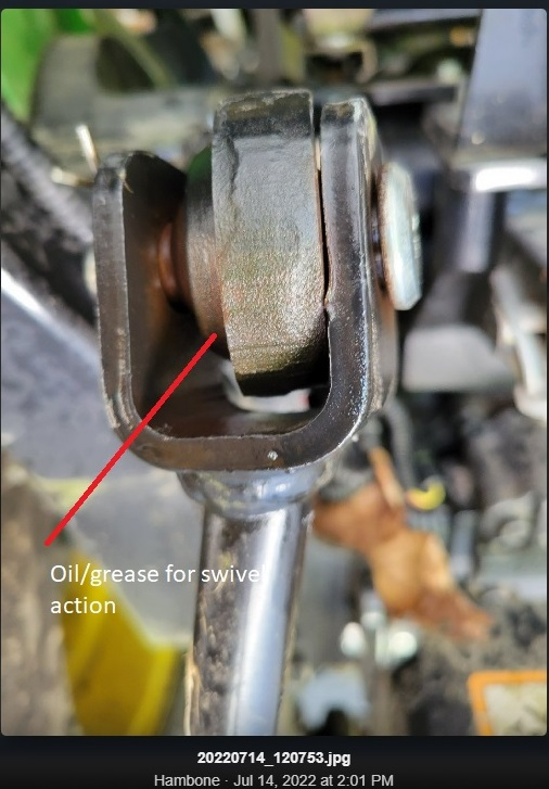

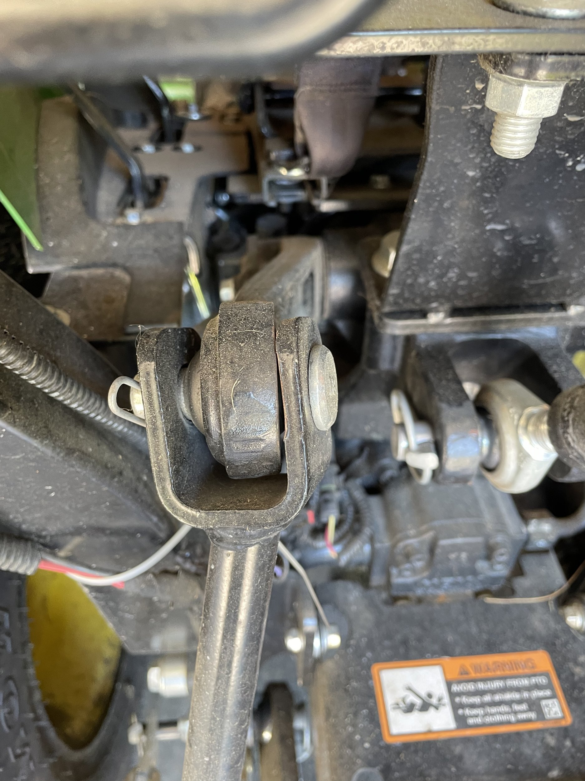

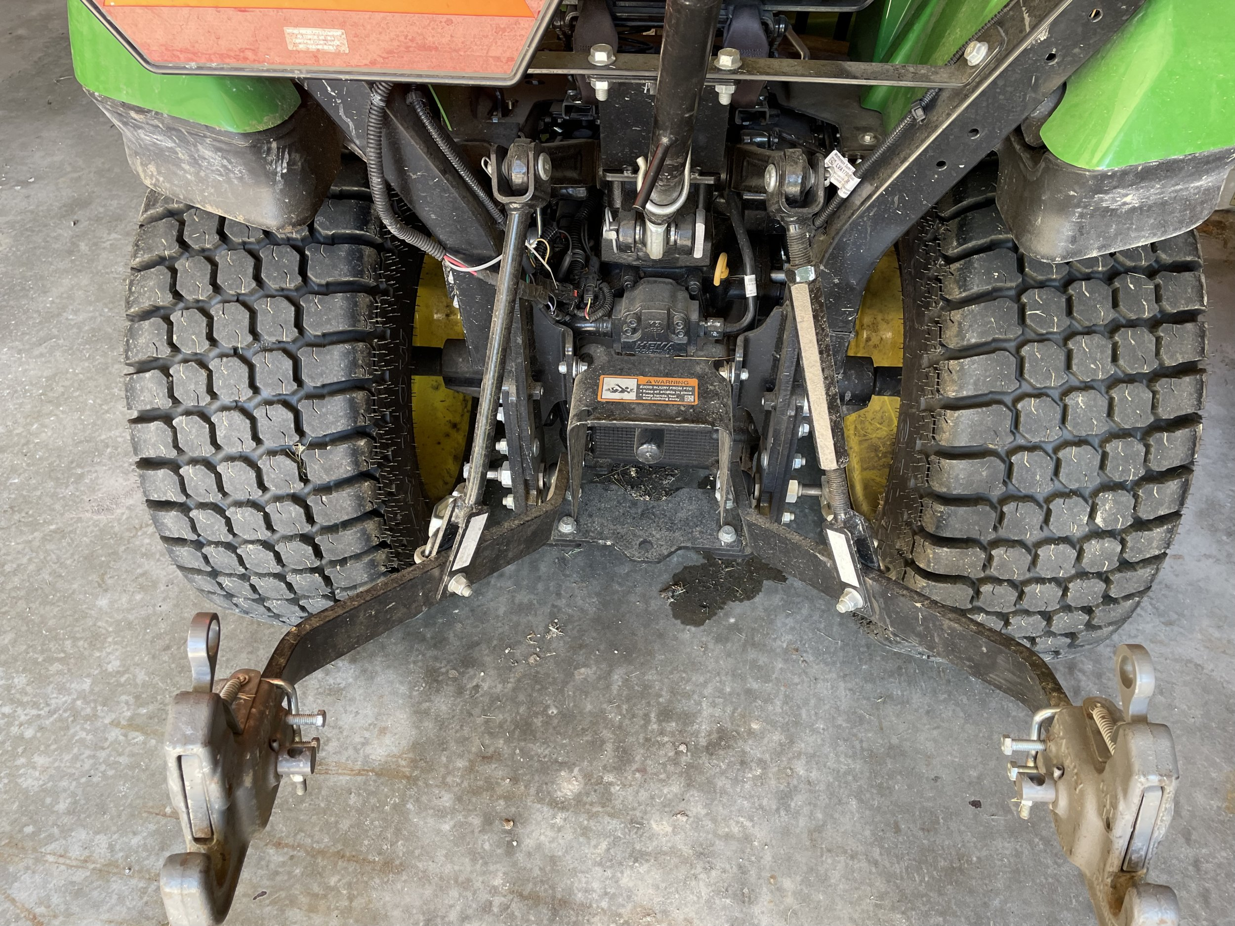

Hey Everyone,
I could use a little help, I think.
I am having issue with hitch not lining up right. I looked at it for a while and just couldn't figure it out.
I might walk out again and it hit me in the face, you all know how that goes.
It looks like everything is in a bind, not straight
Let me know if you need more pictures.
Any help appreciated 20220714_120744.jpg20220714_120713.jpg20220714_120718.jpg20220714_120738.jpg20220714_120753.jpg

I just went out and looked at mine. I was focused on the adjustable link on the right side. I thought your looked bent and cocked to one side. Mine looks identical. I don’t see anything obviously wrong.

See the top of left arm, cocked real bad.
Well it is pulling the lift arm that goes into top of case, then breaks of the bracket that goes to the MMM

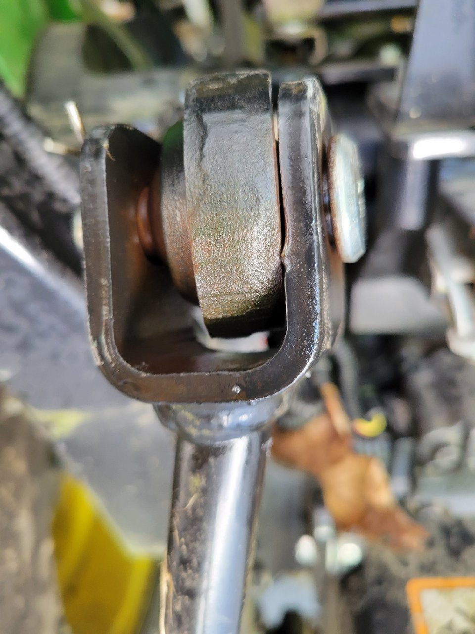

Looks like the swivel is not "swiveling". Needs some penetrating oil or lube.

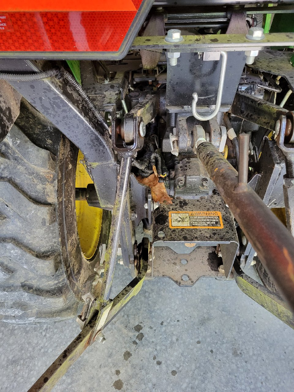

Here is mine. It does look like the swivel might be in a bind.
View attachment 754180View attachment 754181
Loos pretty similar to mine, thanks for posting!

As an experiment why don't you reverse your bottom arms/ flip/shift etc. Just to see if there is better alignment. The end configuration of the draft arms maybe mirrored though. I know Dodge Man's picture aligns with you set up. But just maybe the dealer install instructions were wrong or were not followed. Also check for binding/ full range/ if the new set up aligns better. Just a thought.
