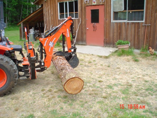

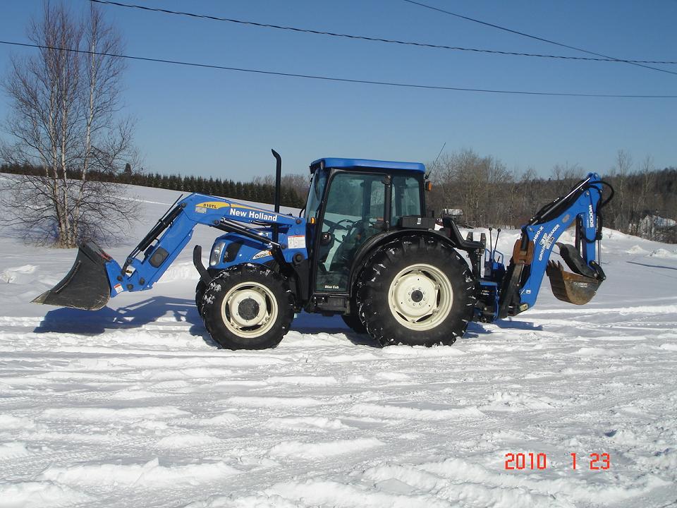

I have bought this tractor w/Woods 90x BH w/thumb. It's got a really rugged 3 point hook-up. Originally i planned on selling it(the back hoe), but I'm going to hold on to to it until summer. If i hang on to it, i might buy a subframe. I don't plan on doing any large amount of work. Just a few hours on my stuff, and got a feeling the neighbors will need a few things done. talked to equipment dealers, it seems it's a 50/50 deal on whether I need a subframe or not. Haven't priced a subframe yet either. I have run excavation equipment some. I know this is very limited in what it can do. I'm more concerned about being careful so as not to stress the"frame" of the tractor. Seeing as it doesn't have an actual frame,the mounting bolts on the tractor will be getting a good routine inspection. One thought i have is, i got a heck of a good deal buying this unit, might not be bad idea to put a subframe on. But it's not going to get many hours working the Hoe.
So.... to those of you that have experience w a BH like this, what do you think? Should i buy a subframe? Or as some dealers have stated i really don't need one?

I would say on THAT size tractor, I would not worry about a subframe as much. If it were me AND the price of the subframe is within reach, I would get it for piece of mind. Find out if there is one and how much it cost. Have to have all the pieces to solve the puzzle...

I have experience with subframe attached BH only. Dealers around here won't sell you a 3ph attached BH (Green, Blue and Orange). They say they've seen and had to deal with too many problems with 3ph mounted BH -- cracked/broken tractor frames. I'd recommend getting the subframe if you keep the BH -- peace of mind and no worries when using the hoe.

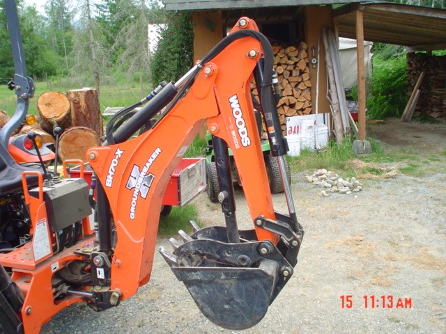

Perhaps the people to ask are the ones that repair tractors or dealers. My tractor came with the backhoe and sub frame. You can use the 3 pt backhoe but from what I have read it can be harder on the tractor. Guess a bit is on how it is used by the operator. :D

It's pretty well-known that attachments that can apply big forces to the tractor can wreck the tractor. The damage isn't cumulative - forces are either absorbed with no damage, or there is an abrupt failure because the strength of a part is exceeded. For light digging a small 3-point backhoe may be ok forever without breaking anything, especially on a hefty tractor. Anyone with a 3-point bh that has never broken the tractor will say a subframe isn't needed - and that's true by definition, so far. But anyone who has seen a broken housing is easier to convince of the merits of a subframe. It connects to the tractor in more places so the loads are spread out. The fact that any 3-point backhoe hasn't broken the tractor yet doesn't guarantee it won't tomorrow. My 2 cents Dick B
