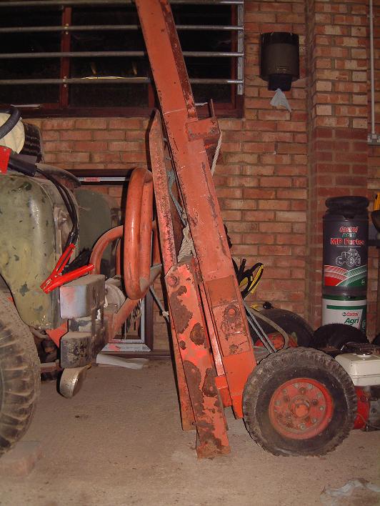

I will try to photgraph the fork lift and post it if I can work out how attach the photo!
   / 3 point hydraulic fork/bale lift #13
Attached is a picture from the side, the forks can just be seen folded up resting on the front of my landrover bull bar, as you can see the lifting frame is resting on the ground so that even with the wheels the forks will go to gorund level

That's a lot bigger than mine, with a higher lift, but I get the point.
I was out at my property today, but it was in response to a minor problem, so I didn't leave from my shop, so I didn't have my camera. It took a good part of the day to resolve my problem, so I didn't even take the time to look at my rig. I'll be headed back out there next week; maybe I'll be better prepared.

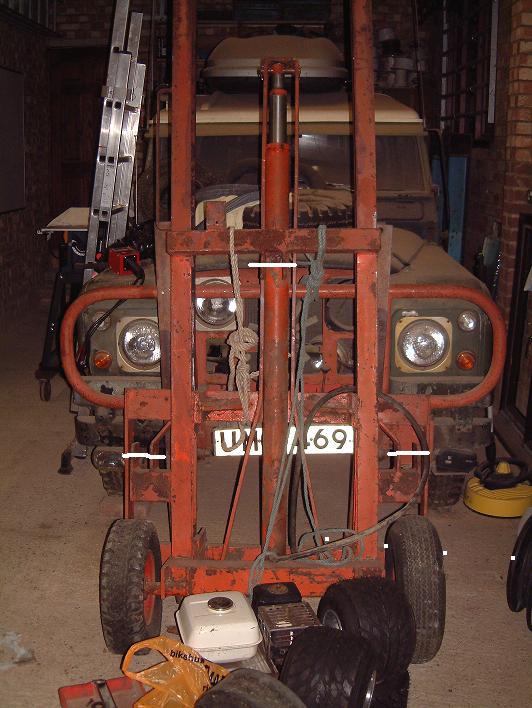

HI
finally a view facing rear as though sat on the tractor. I have marked in white the 3pt cat2 connection points. The overall height of the lift is 9' and the forks lift to about 8'. the ram is a double piston to lift it to the height.
I bought it cheaply to convert to cat 1 and use it on my tractor, but due to size and trying to manouevre it around when not connected (as it is top heavy unless connected to the back)have not yet done so. I am thinking of just using the slide carriage and forks and putting these on the 3pt linkage and doing away with the frame, anyway another project for one day or other if i get round to it!! /forums/images/graemlins/laugh.gif
