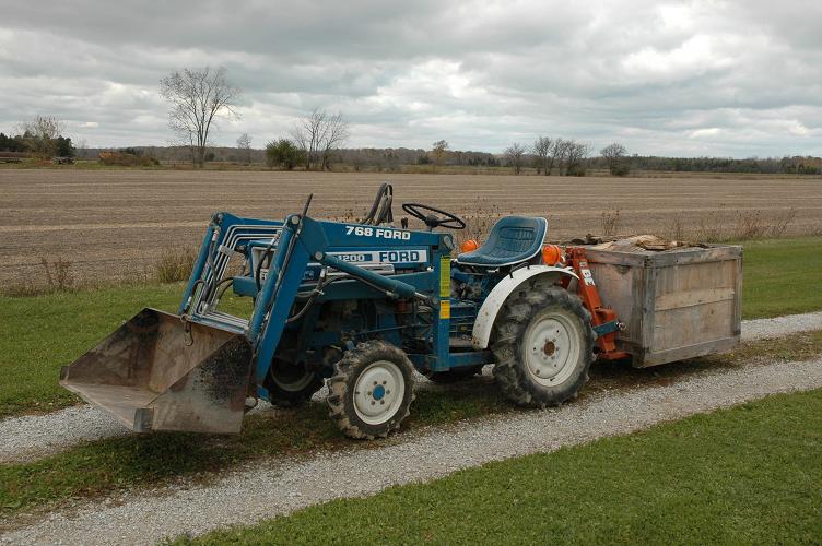

Not sure if the picture appears but I have a 1200 that I recently picked up, great little machine, I pick up just under a face cord of hardwood with a 3 PT pallet forks. I want to start a thread on my new purchase but have not had time to get the picks and stuff together.
