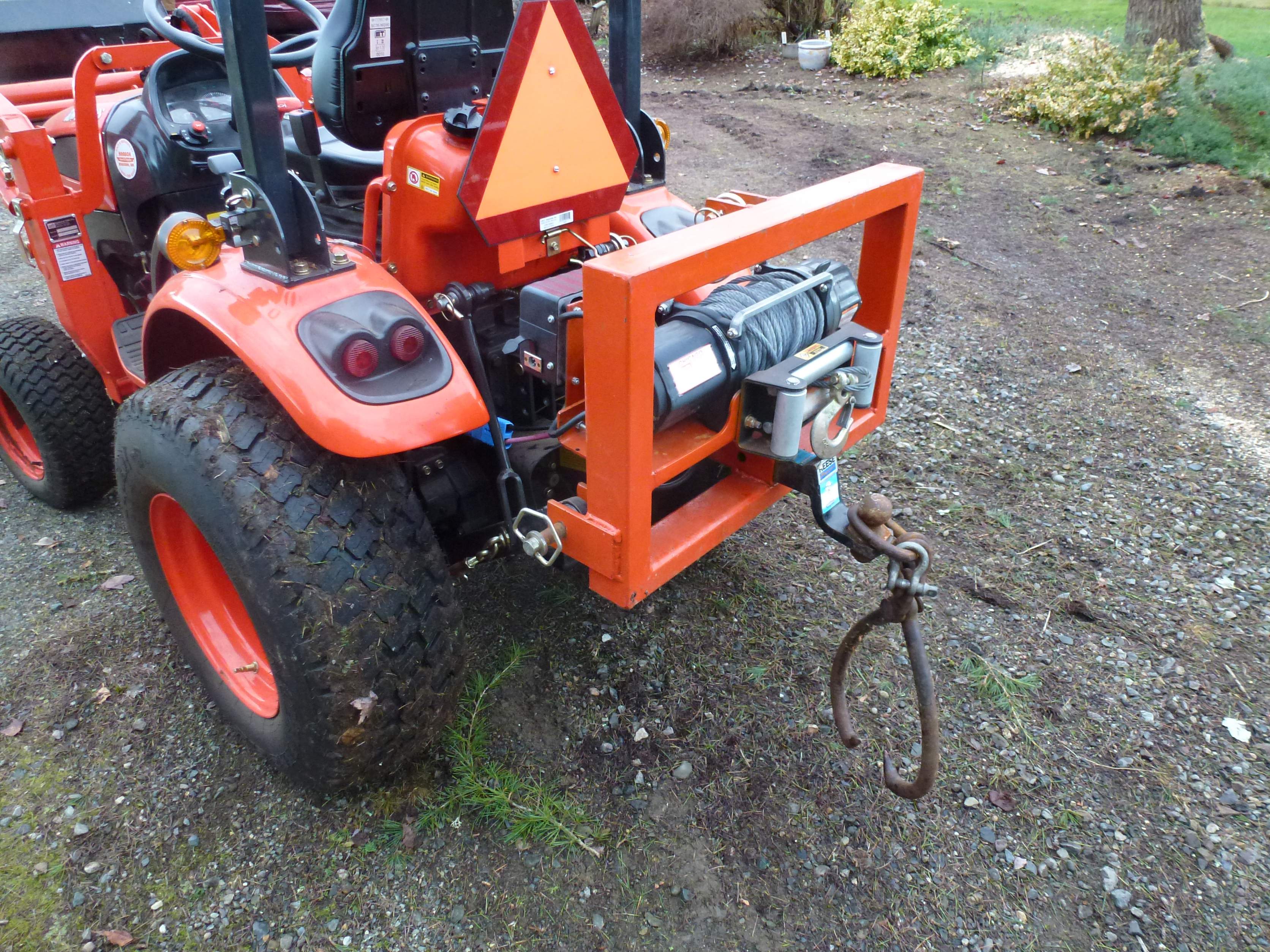

randall in ak and nd 181.jpgOne for the wife's K20. 10,000lb electric. Handy with the 2in receiver for a trailer.

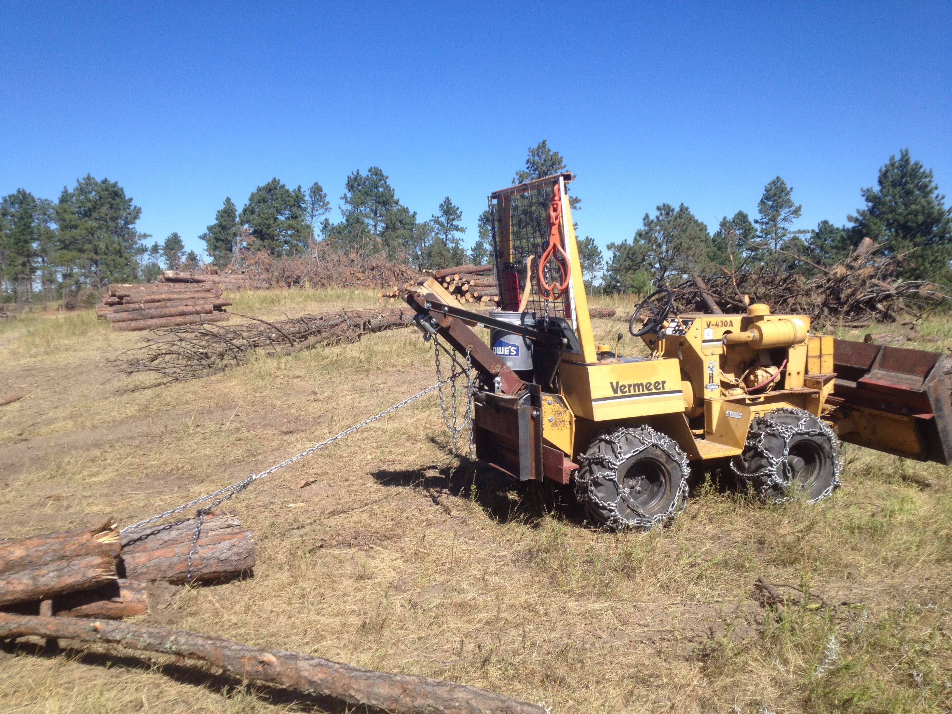

I almost purchased a winch skidding setup for my tractor but had second thoughts about tearing it up in the woods and working on uneven terrain. I decided to build a small machine just for skidding that also had a 6 way blade for cleanup duty and a low center of gravity. Started with a Vermeer trencher and a hydraulic winch. Added a boom, foamed the tires, and chains.

You need to start a build thread on that. I have a mini loader made from a trencher.
How slow is your machine? ?
