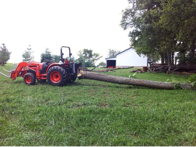

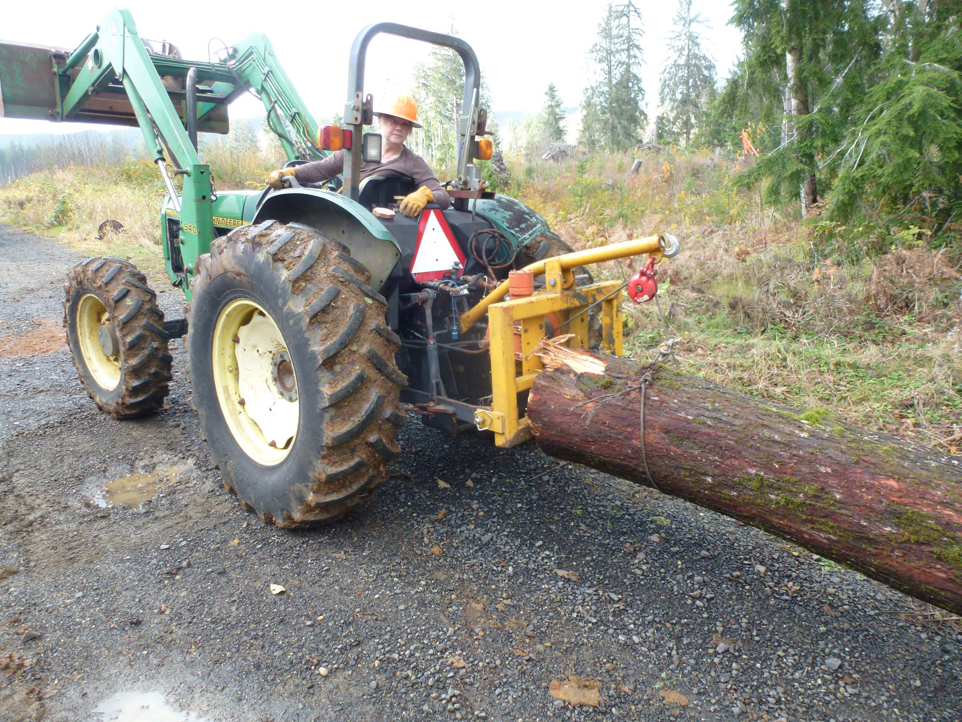

Bruce and notice that large skidder doesn't have a u-joint hitch, it's tipping by just encountering resistance pulling in an arc.
Wouldn't take much to roll an ATV with the u-joint hitch, probably ought to have rotation pinned so anti-rotation feature is optional. My ATV suspension is quite plush, it can't take much weight in the rear. May need a steerable dolly but that's just "more stuff" to build & transport - but it is towable.
   / 3-point log lift & skidder on small tractor #13
That large skidder doesn't have a u-joint hitch, it's just encountering resistance pulling in an arc.
Wouldn't take much to roll an ATV with the u-joint hitch, probably ought to have rotation pinned so anti-rottion is optional. My ATV suspension is quite plush, it can't take much weight in the rear. May need a steerable dolly but that's just "more stuff" to build & transport - but it is towable.
Not following your line of thought here at all.

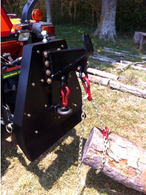

Here's my set-up. I like choker chains because it applies straight line load on hitch... Not a bending moment.

You're right, ignore all that, I am mixing up a couple methods (wheels at the front of the log).
Papaperk I like those keyhole thingies. I still might just do it simple like you're doing.
   / 3-point log lift & skidder on small tractor #16
You're right, ignore all that, I am mixing up a couple methods (wheels at the front of the log). Papaperk I like those keyhole thingies. I still might just do it simple like you're doing.
Those are grab links made by CM. I think northern tool sells them. Also the slip hooks are made for choker chains. You can get them from Baileys. Really works slick!

The skidder is basically popping a wheelie with the steering wheel turned to the right.

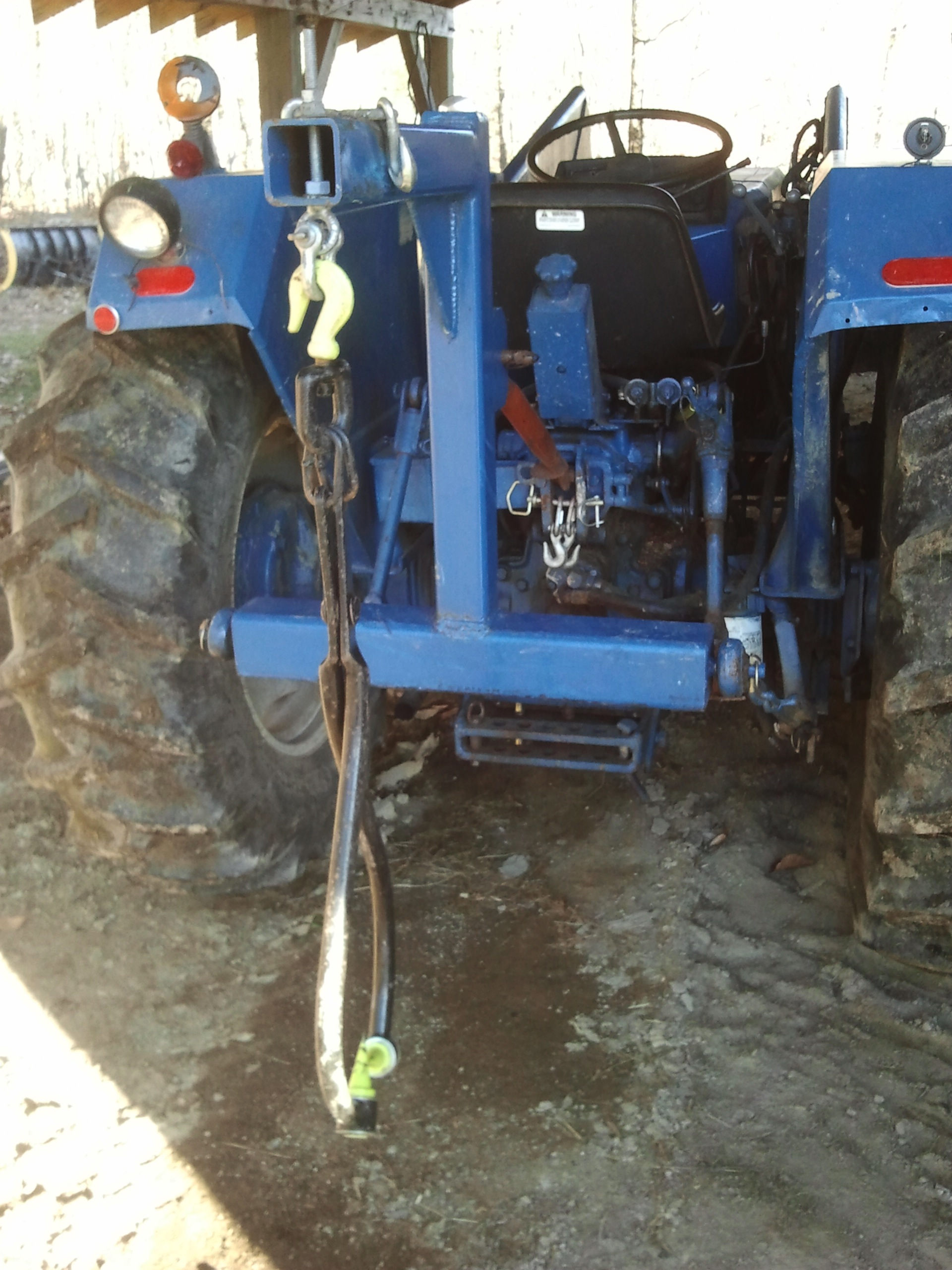

Here's what I have been using for several years (photo from my old B2920):
Also has a 2" receiver on the bottom.

S219 thats a beefy unit. I should have welded my receiver on the bottom like yours then it wouldn't need the gussets (on my little b2710). But I had some kind of a wild hair. But those fellas sure gusseted yours!
I wonder how much lift capacity the burliest CAT1 can produce.
