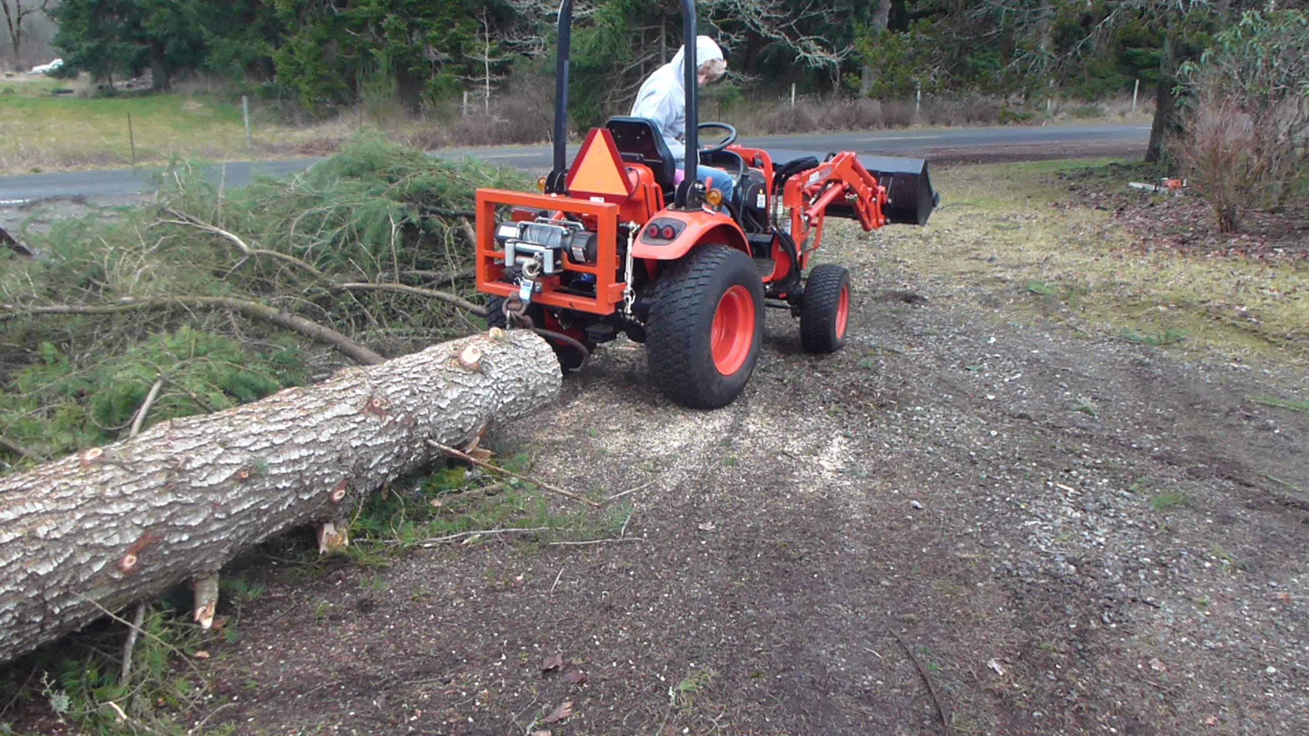

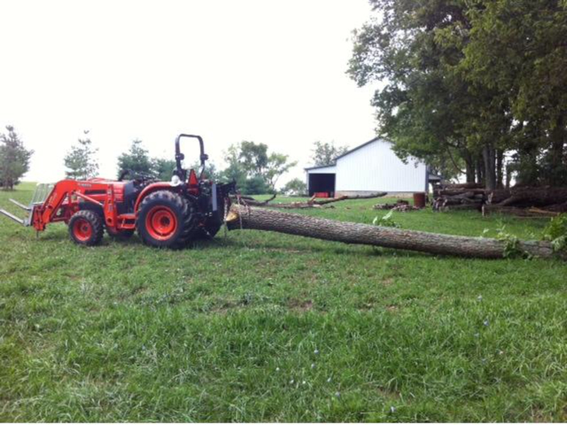

I think I put this up before, but will again because it truly works great. With the boom pivoting across the top of the frame and works as the top link it can lower to the ground and when lifted it gets right up there. I can use tongs or the winch in the frame with the small pulley you see here.
the larger unit is hyd and the smaller rig is electric, but without the boom. Both have easy hitches for trailers and chain hooks on the main frames.

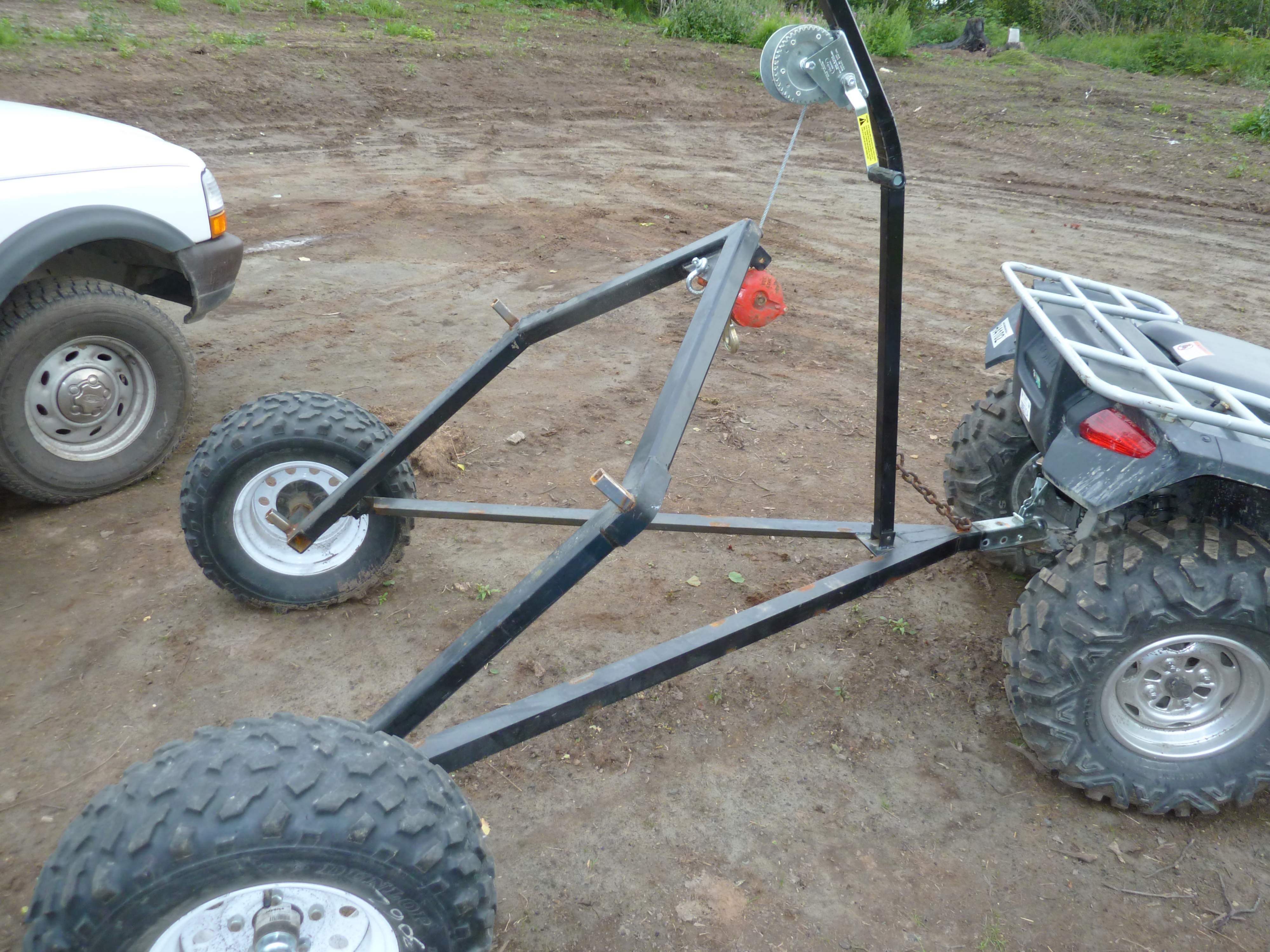

Log skidding arch is a great way to go; I have one I made for the ATV. It worked really well up to 24" diameter logs. The one thing that makes an arch "second" to a farmi-type winch or "high-lead" cable is the difficulty backing up to a log on the slopes. The small arch I made was light-enough for me to detach it and walk cross-hill or down-hill to a log for the hook-ups.
Log arches have few limitations; Dozers use them
https://www.google.com/search?q=doz...yD4u_sQTl-ILwBw&ved=0CCoQsAQ&biw=1067&bih=457
and even steam donkeys that dragged them-self through the woods from pad to pad.
https://www.google.com/search?q=ste...DHpHKsQTtwICYCg&ved=0CDUQsAQ&biw=1067&bih=457

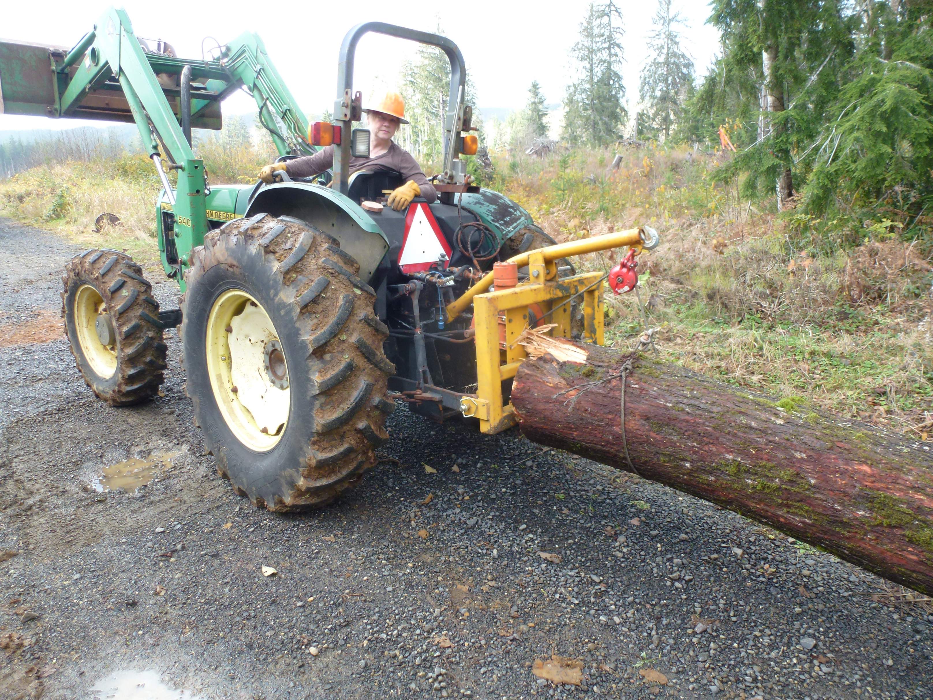

Yes, arches are a good way to go it you can maneuver ok. this is what I came up with. when the winch it pinned to the top of the frame it is stable to winch a log up. When I put the flatbed on the arch frame it becomes a dump trailer.

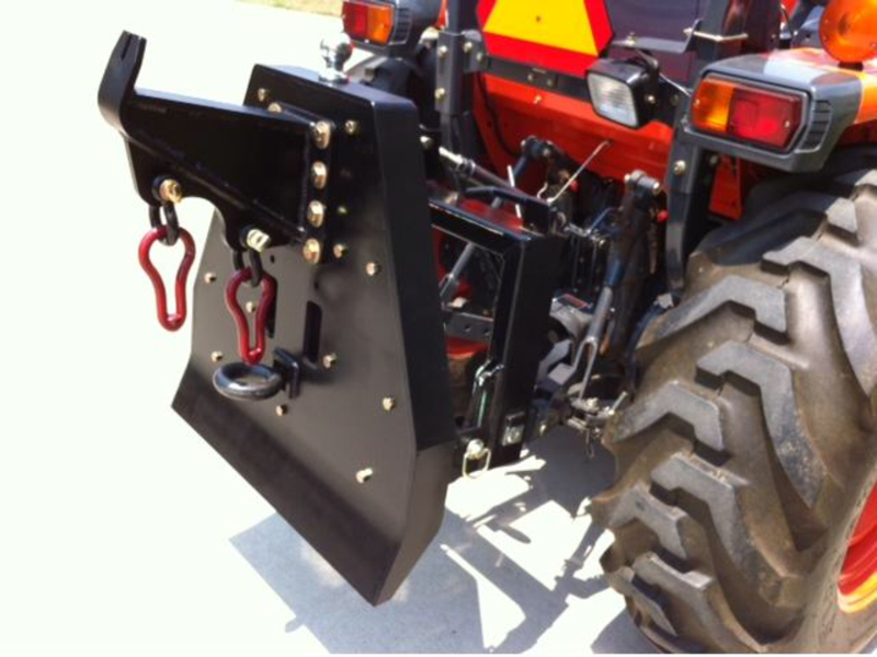

Here's mine! Also serves as my ballast box. Around 550 pounds.
