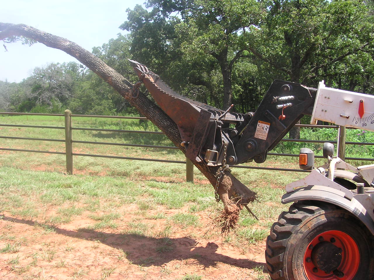

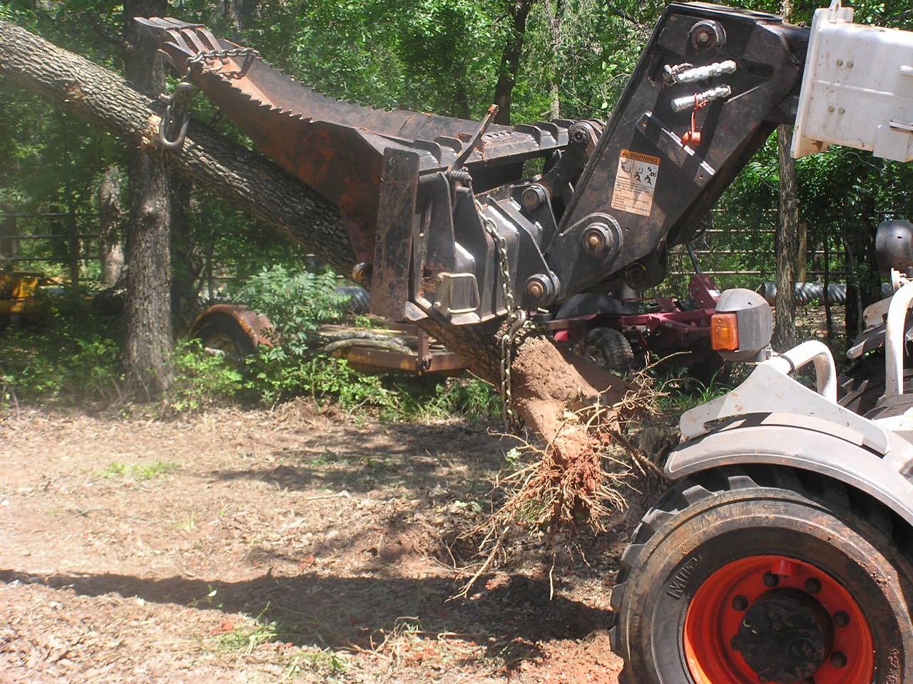

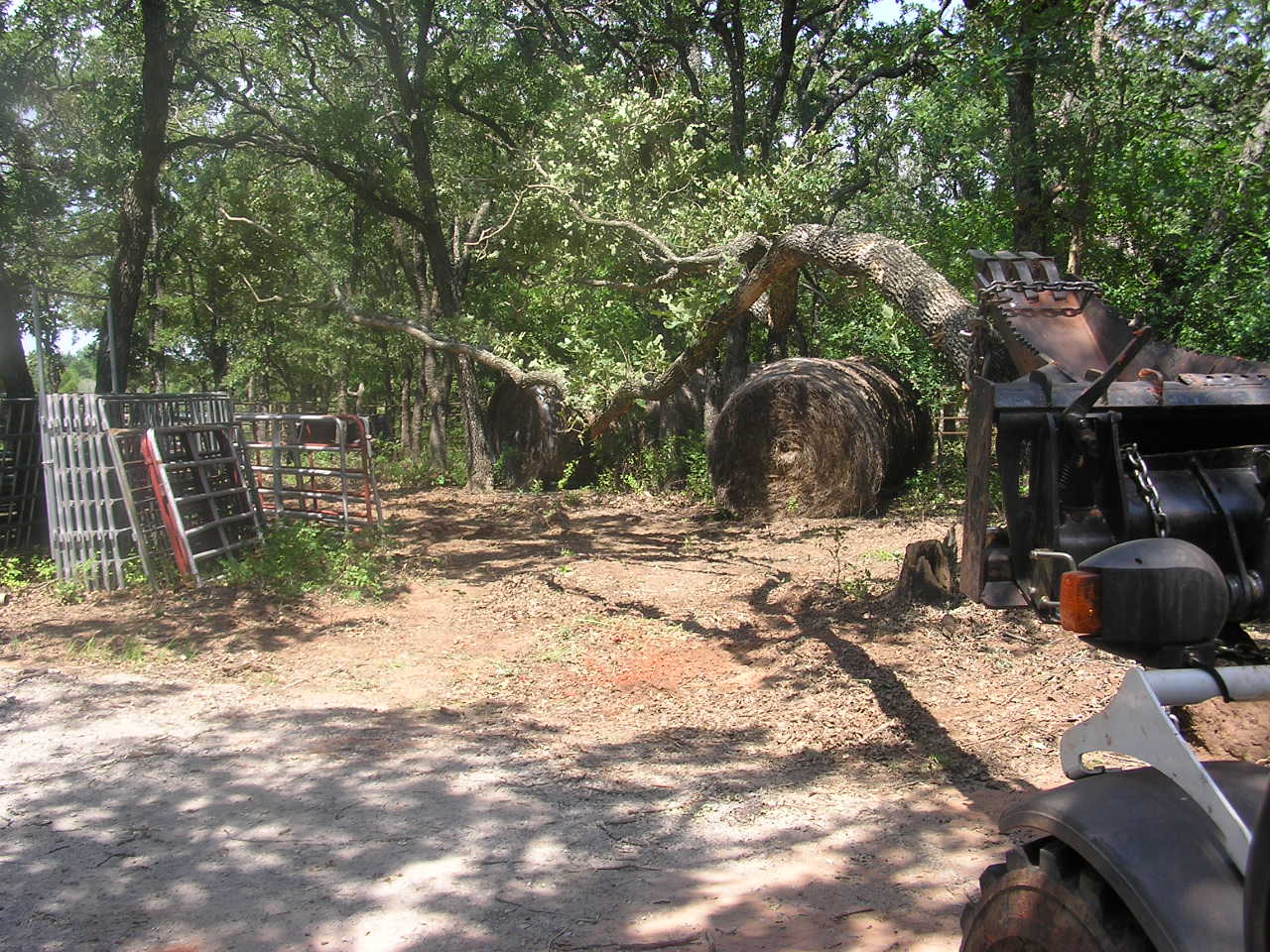

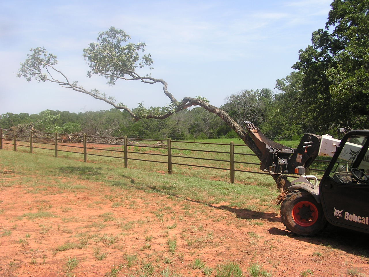

Not a 3 point log skidder, but I thought I would show another way to do it, with the stump bucket.

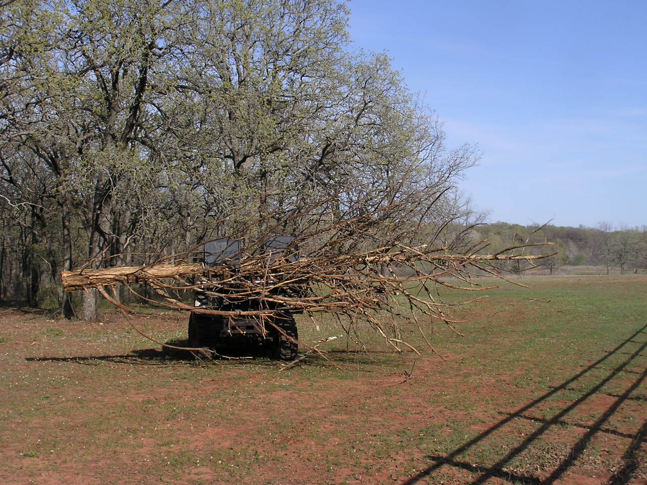

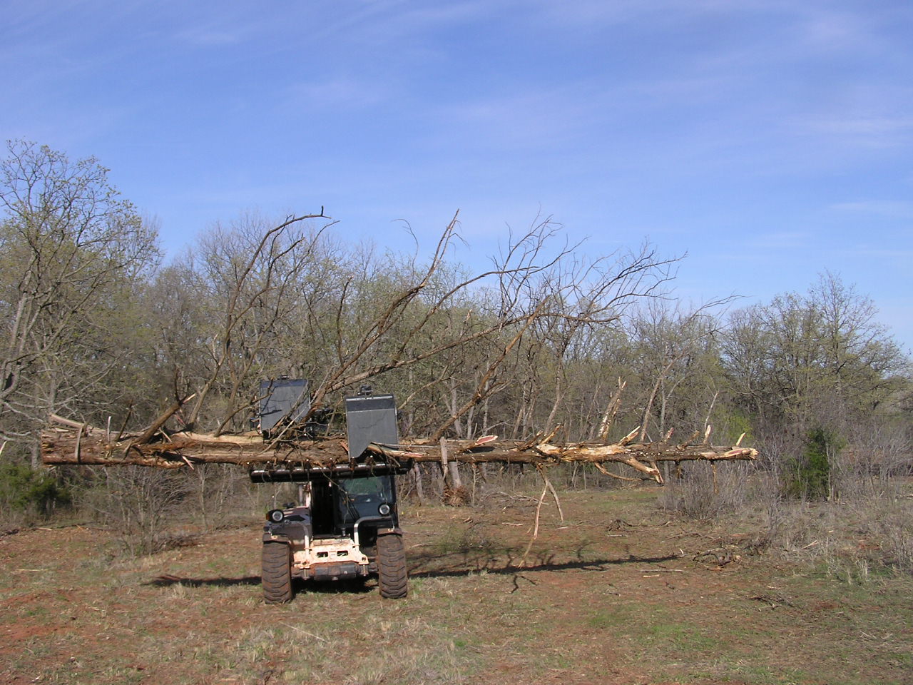

After I drag the big ones out of the woods, I grapple them to the burn pile.
The V417 is 6' wide, 6.5' high and 13' long. Tire size is 14x17.5. Top speed is 15.5 mph, drawbar pull is 7,000 pounds and it will lift over 5,000 pounds. With 4 wheel steer it works good in the woods.

That is awesome! I can't see a winch; is that a winch too?
Thank you!
No it doesn't have a winch. It does have counter weights on the back side of the plate.
