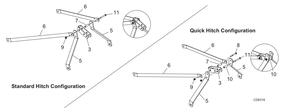

OK, can a swinging top link be added to any 3 point brush hog? Or does it have to be built with the swinging top link already in place?
I have a neighbor that swears a toplink, mounted to a traditional 3 point hitch rotary cutter, saved his life. He said he was mowing up a steep hill and the tractor front end slowly started to come up and the toplink stopped the upward movement for a few seconds until he was back under control of the situation. Ken Sweet
I'll bet it had one when new. If you have bars going down to the rear from the top of the hitch, you can cut and add a link or put a link in front like the style mine has. It can be in two different positions, depending on your hitch.
I have heard of this and if your tractor is light in the front end, it is best to be careful. The flip side is bent mower linkage if you cross a severe dip and you don't have some kind of slack. I have bent the linkage several times when using a rigid top link. I use a swivel link as well as a foot of chain on the end of my lift straps which I shorten. A short length of chain in place of the top link works very well.
