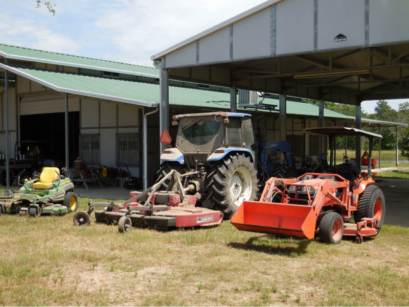

Pulled an 8' Mohawk behind a Ford 5000 for about 10 years in mostly open pastures. Backing it in under low tree branches was never an issue. Present ranch has heavily wooded pastures so our present 8ft. (On NH TL-100A) and 5 ft. (on Kubota B2710) 3-point cutters work better.
We cut the big open areas with the NH and 8 ft. cutter, then get closer to trees with Kubota and 5 ft. cutter, or the 72" MMM on the Kubota. Occasionally take the JD Z820A ZT to get under trees as required. We essentially have 4 cutters to work with.
