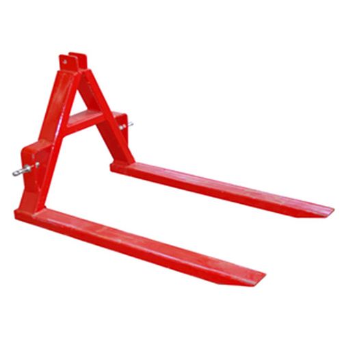

I wonder if anyone has any experience with these 3 point pallet forks for my L3200:
Pallet Forks, Pallet Fork, 3 Point Pallet Forks | Agri Supply, 72511, 3 Pt Palle
These are only $160. I realize it is totally different than having a real set of forks on my loader but I'd probably be looking at upwards of $7-800 for a set of decent forks. Maybe someday...
My immediate need is that I'm having about 20 panels (8' wide x 6' high) weighing about 240lb each delivered to make my 50' diameter round pen. I figure that I could slide the panels off one by one onto the forks, deliver them to the location where they could be staged to stand them up and then go back for another panel (or 2 or 3). Does this sound like something I could do with this attachment?
After this use, I'm sure I could leave a pallet on the forks and use it as carry-all around my 20 acre horse farm.
Any ideas or suggestions on using this type of implement or this one in particular?

I think they would do your project just fine as long as you added some height to them to support the 6' tall pieces. I have these and they are hard to beat for the price.

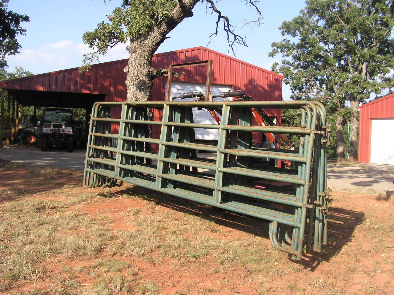

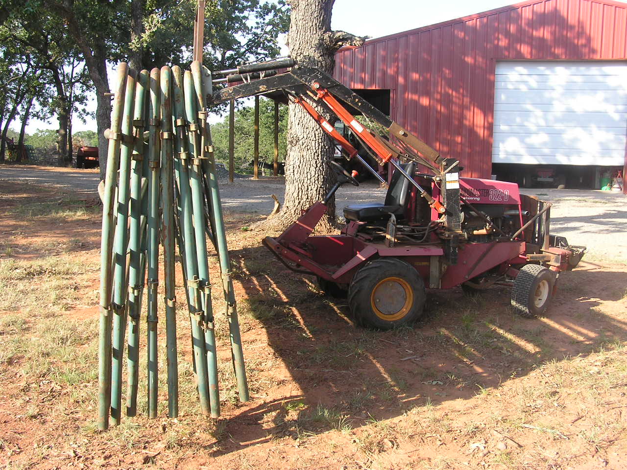

The best way to move panels is with the FEL. :thumbsup:
Some 16 footers on the brush forks.
You could remove your bucket and use a short chain on each side of the quick attach to carry 2 or three at a time.

With some slip on fork extenders you could lay the 6' high panels on flat (laying down). Note also you're going to be balancing 8' wide panels on two forks 22" apart. (ehh, 37" hanging off either side ain't so bad)
