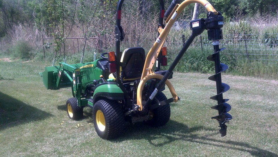

I picked up a 3 point auger (tractor supply...on sale) to install some fence posts. I got it assembled and on the tractor and did a few test holes tonight. I have a 6" auger, this is mounted on my Deere 1020. The biggest problem I see is the auger wants to screw into the ground pretty quickly. The soil is slightly moist but not wet and I am not into heavy clay, mostly topsoil. I was surprised how fast it would suck into the ground once you got past 8" deep. I am running the engine at 1,000 rpm or slightly above, I can't imagine how fast it would suck into the ground at a faster rpm. Is this normal? What do I need to try to keep it from screwing in so fast?

As I lower it into the hole I am also constantly pulling it back up but once it get over 8" down, it really want to "go home" pretty fast and it bites in pretty solid screwing into the ground, I quickly lift it and it pops up pretty hard, nothing like the sandy soil in the videos online! Would a slight higher pto speed help...like maybe running the engine at 1,400-1,500?

I've had good luck with our TSC PHD running it just at above an idle and lowering it slowly, using the TPH to control its tendency to "auger in". This is in sandy loam with fairly high levels of clay.

First thing, simply control the depth with the 3pt hitch control lever. Unless it's pulling the front of the tractor into the air,:eek: you should be able to control the depth with the hitch control lever. Never down more than a foot and raise, down a foot and raise. You do not need to come out of the hole, just raise a bit, then back down for another foot of digging.
Second, try doing this at an idle, not just above an idle, at idle speed. "If" the tractor will not do this, then bump the engine speed up slowly. You want to drill the holes with as low of an engine speed as possible.

for me, i run the PHD as others have said, low idle speed, go down a little bit then bring it up some then back down. and once i reach my mark, i may up the RPM's some with a few up and downs to help clean out the bottom of the hole.

As other posters have mentioned I also use the 'drill & withdraw' method. I had to put 100 4X4's in for our dogs' fence in the woods - not an auger friendly place. I ran the tractor at about 1000 rpm and would go down about a foot OR until I felt the auger grabbing something (like tree roots) then withdraw it. Our soil here in Connecticut is mostly gravel (glacial till where I am) with a goodly share of potatoes of all sizes.
As my auger was only 3' long I went to a local machine shop & had a 1' extension made out of solid steel rod. That allowed me to get true 3' holes easily for the posts without the need for cement at the bottom.
The long pipe wrench to unscrew the auger is another good suggestion. Fortunately I only needed it once. All the other times I was able to GENTLY rock the tractor back n forth to elongate the hole & extract the stuck auger.

Thanks for all the reply's. I did several holes today, nice and slow on the rpm and it worked much better. Stalled the engine once but overall low rpm and down slowly worked well. Thanks, Tony

A little late but for future searchers. I have a BX22 and the first time I drilled a hole it went straight into the ground until it hit bottom.No reverse on the PTO so out came the shovels. I learned as I went, less RPMs, raising and lower the auger. Still had it take off a few times.
I was drilling about 40 six inch holes for a fence. My buddy and I came up with a solution, we use a standard 2 ton come-a-long (CAL) and a length 6 or 8 foot length of 3/8 chain. Double loop the chain around the ROPS (Gasp) and use a hardened bolt to secure the ends together about 2 feet from the ROPS. Then place the CAL in between the chain and the boom hook on the PTO boom. It works awesome. I let it out about 5 rotations on the CAL gear each bite and let the auger drill in. It still takes off sometimes but the tractor usually powers thru and pops the auger back up. A few time it actually bogs down the tractor but I can stop or raise the auger before it stalls the tractor. When your done just stop the auger, crank in the CAL and move to the next hole.

I will add that for me, the key to not burying the auger in too deep is to simply let it dig down a foot or so, then quickly bring it up with the three point lift. If the soil is fairly dry, it will usually sling the freshly dug dirt off of the auger as it clears the hole. Then, it's ready to drop back down in the hole again and let it dig down another foot or so. Be ready to bring it back up again quickly and clear out the hole. Just repeat this until it digs down as deep as you want/need the hole to be.
