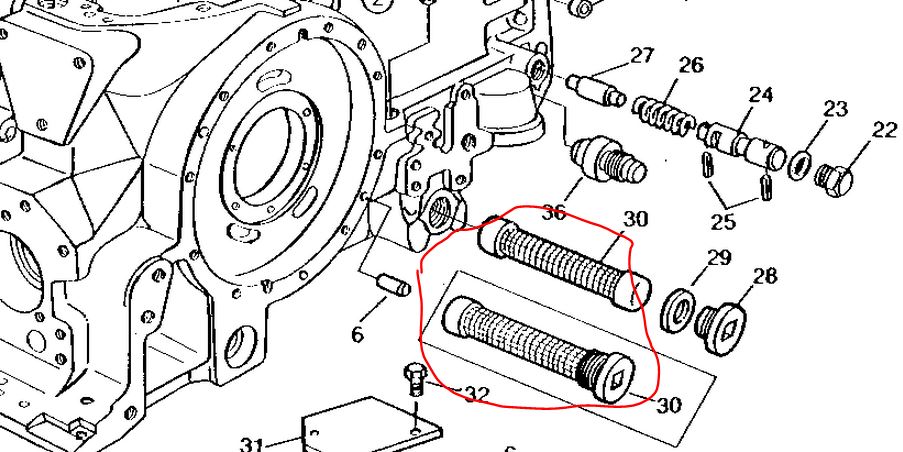

1st thing to do is look in hyd filler hole for spraying oil with 3 pt raised and engine running. How long since hyd filter was changed & check/clean sump screen(parts key #30)??

Jim,
Never changed the filter or checked sump/screen. Is that (#30) in the center of the 3 point lever quadrant? Cause there is one there that looks like that. I will have a look tonight when home from work.

To check sump screen(parts key #30) one must drain hyd oil or insert running shop vacuum hose in hyd oil filler hole

   / 3 point, steering, brakes, on jd 2020 acting up
Pulled trans/hyd filter, looks ok, but getting new one. I seen #30 below to the rear of the foot plate. need part numbers. does pn# AR75603 sound right? Also when i crank the steering wheel way right, the 3 point starts to lift and i can hear the pump screaming like all h3ll. crosses with fram c1721
   / 3 point, steering, brakes, on jd 2020 acting up #8
AR75603 is the hyd filter. You won't need a new sump screen unless your tractors hyd oil is very dirty!!!!! Sump screen PN is AR26375. It's possible the power steering is leaking inside the PS housing. I'd suggest to remove PS supply line and cap hyd line from frt pump to test hyd system.

Jim, doesn't seem too dirty, i have seen worse. However, when i pulled the filter housing, there were flecks of bronze/brass looking material in the bottom. not a lot mind you, but they were there. Going to remove and cap PS line as you mentioned and see what happens. By PS housing, you mean below the steering wheel near the shift controls, right?
   / 3 point, steering, brakes, on jd 2020 acting up #10
Bronze/brass particles are from brake linings(pads) which a little flakes is normal. I still think you need to check sump screen. Diagnosing problems on closed center hyd systems such as your 401 B will make you OLD & BALD headed like me.:eek:
