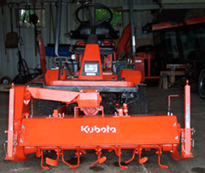

I have an older Kubota K420 tiller that I converted from 3ph to front mount. It works great. I can't remember who the manufacturer was but it was made in Italy. /forums/images/graemlins/smile.gif
