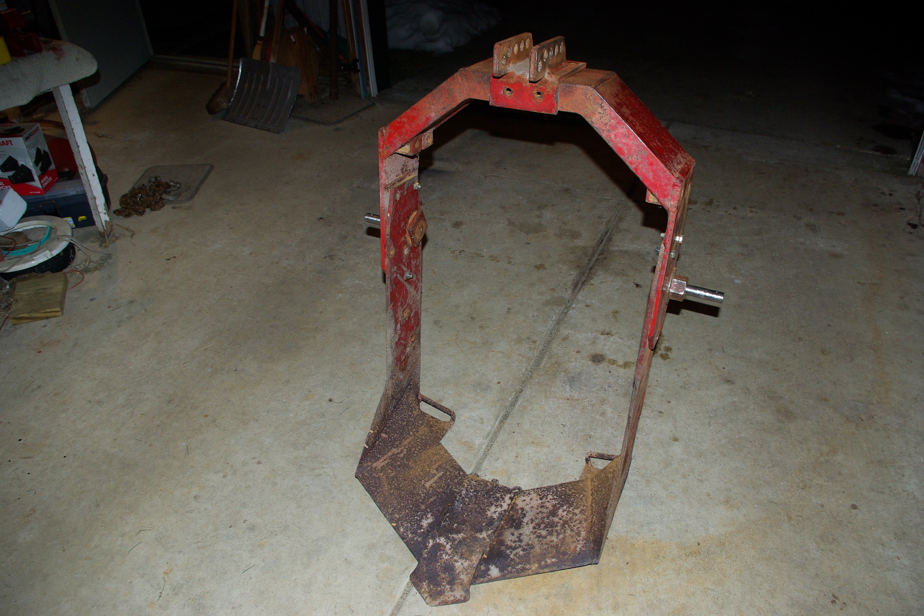

Came across this on CL and brought it home. It was set up similar to the orange one in mikehaugen's post with an approximate 90 degree angle and additional brackets to support the angle. The seller thought it had been mounted on a front loader and he remembered breaking the single top cylinder using it. There are no markings on it but some of the brackets I removed would have supported a Cat II 3 pt. eagle claw hitch which I think was a Case exclusive.
My intended use is a root crop harvester so it won't be put to use for a while, although I will try it out this spring. working width 23", working depth 16", overall heigth 34" It looks like a universal design to be either pulled, pushed or front loader mount. If anyone has further info on it, please advise.
The seller called it a tree spade. I have seen similar devices called: tree lifter, root cutter, root spade, undercutter, root crop harvester, and any combination of those.

I did some net digging and actually found the patent paperwork for this implement. It is listed as an "ADAIR DIGGER", early 1950's and is convertible from a front loader mount to a rear mount. All the nuts and bolts were square headed so the early 50's time line matches. The patent diagrams show a very elaborate rear hitch setup, due to the non-standardized hitches used by different companies. While sanding on it today, found lettering on the bottom side of the top "U". It had been painted over but appears to be "ADAIR TREE SLICER" "CHICAGO HEIGHTS, IL". Googled that and nothing. I wonder how many were actually made?

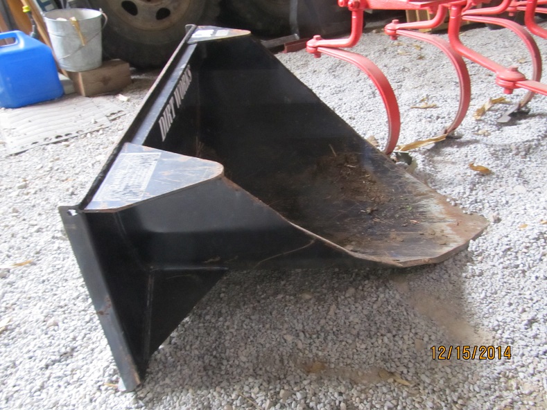

I recently purchased a smooth edge skid steer tree shovel. My Deere tractor has a QT loader bucket so I bought a QT to SSQA adaptor so I can use the shovel on either my JD790 o JD5520 loader. It works better than great. The 790 lacks power but with the 80HP 5520 I can dig out and move a smaller --5 ft--tree in mere moments. Just scoop and go. Seems like a rear mount would take forever and make a mess.
Here's a photo of the shovel by itself.
