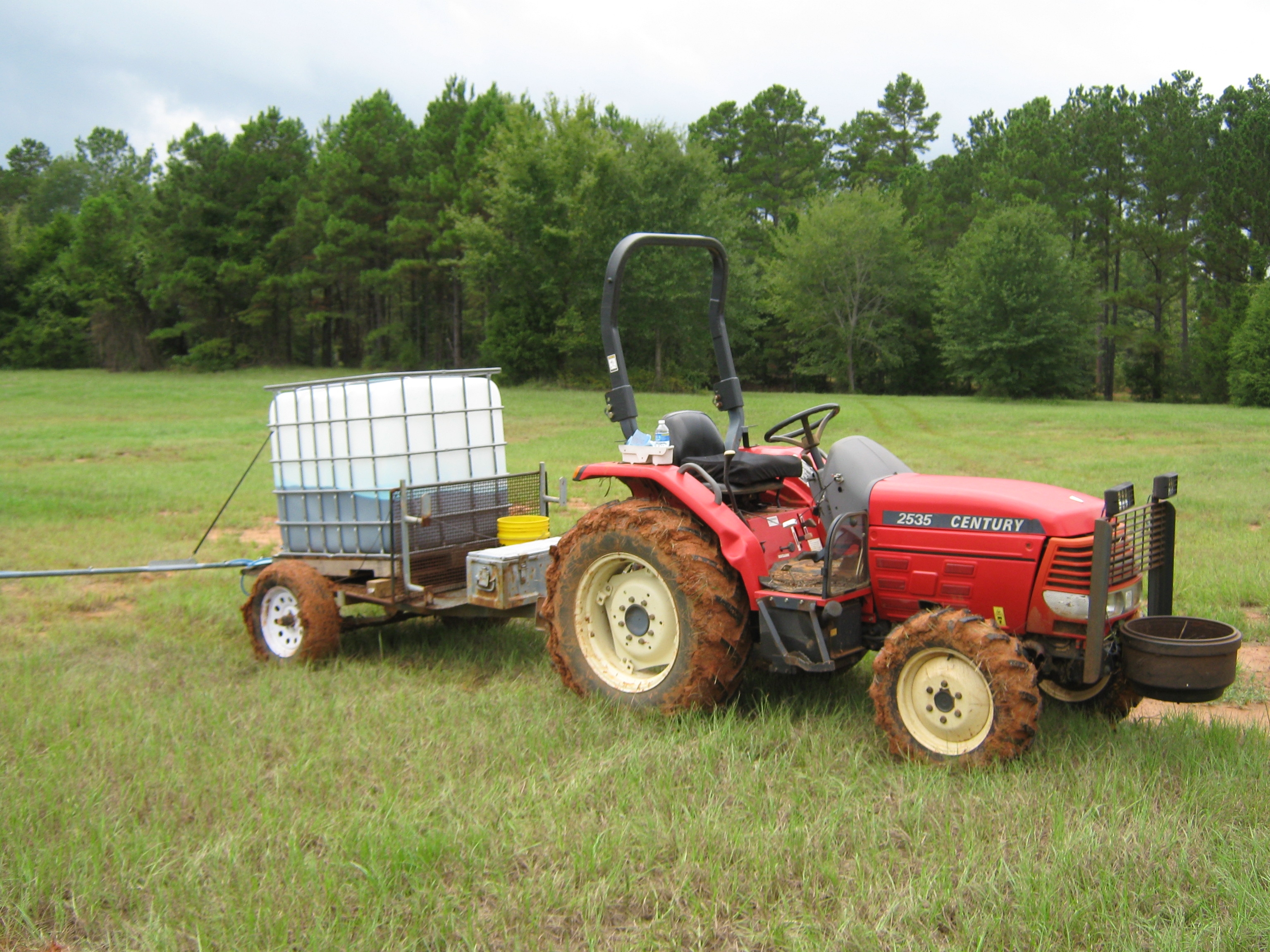

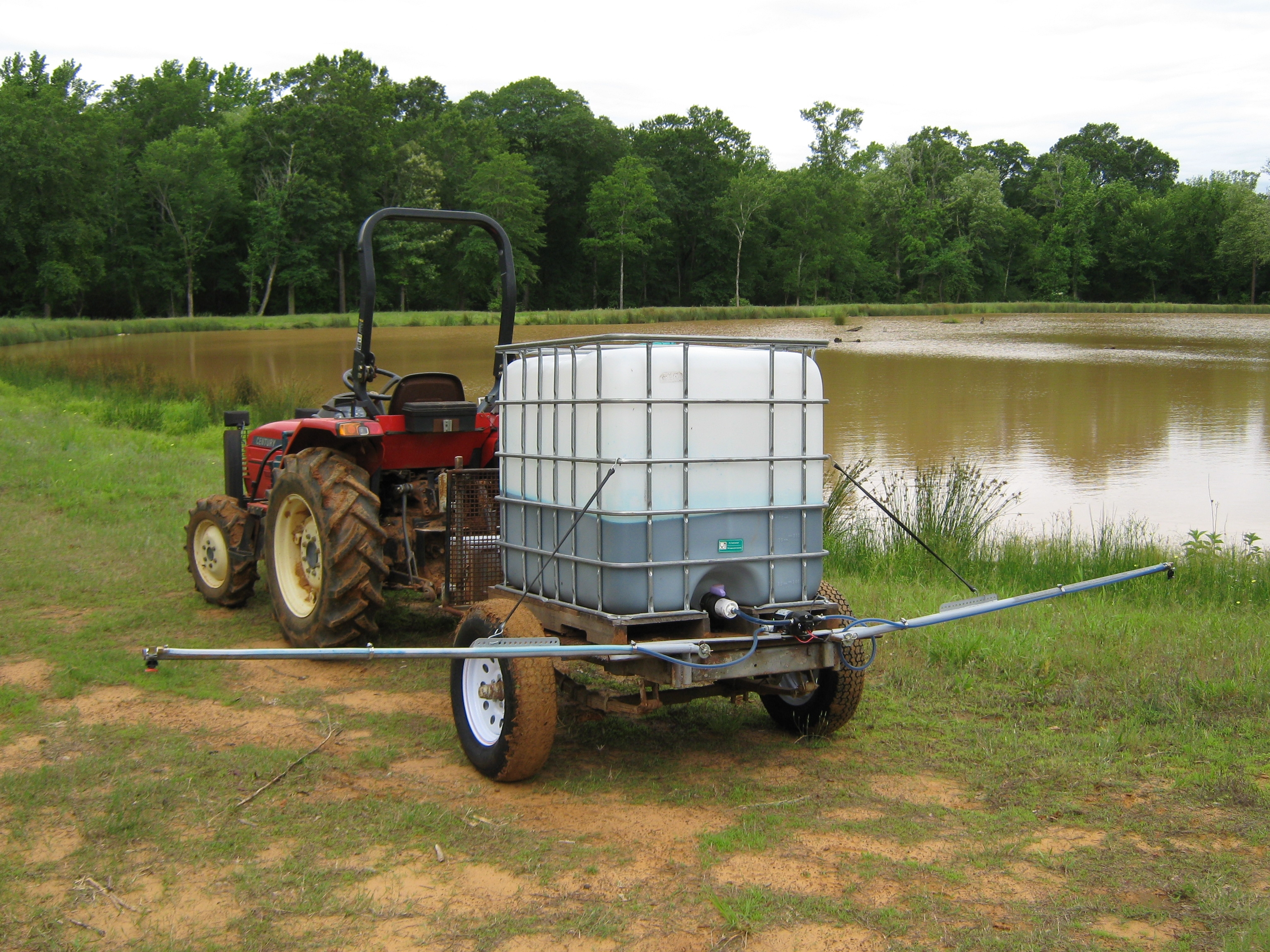

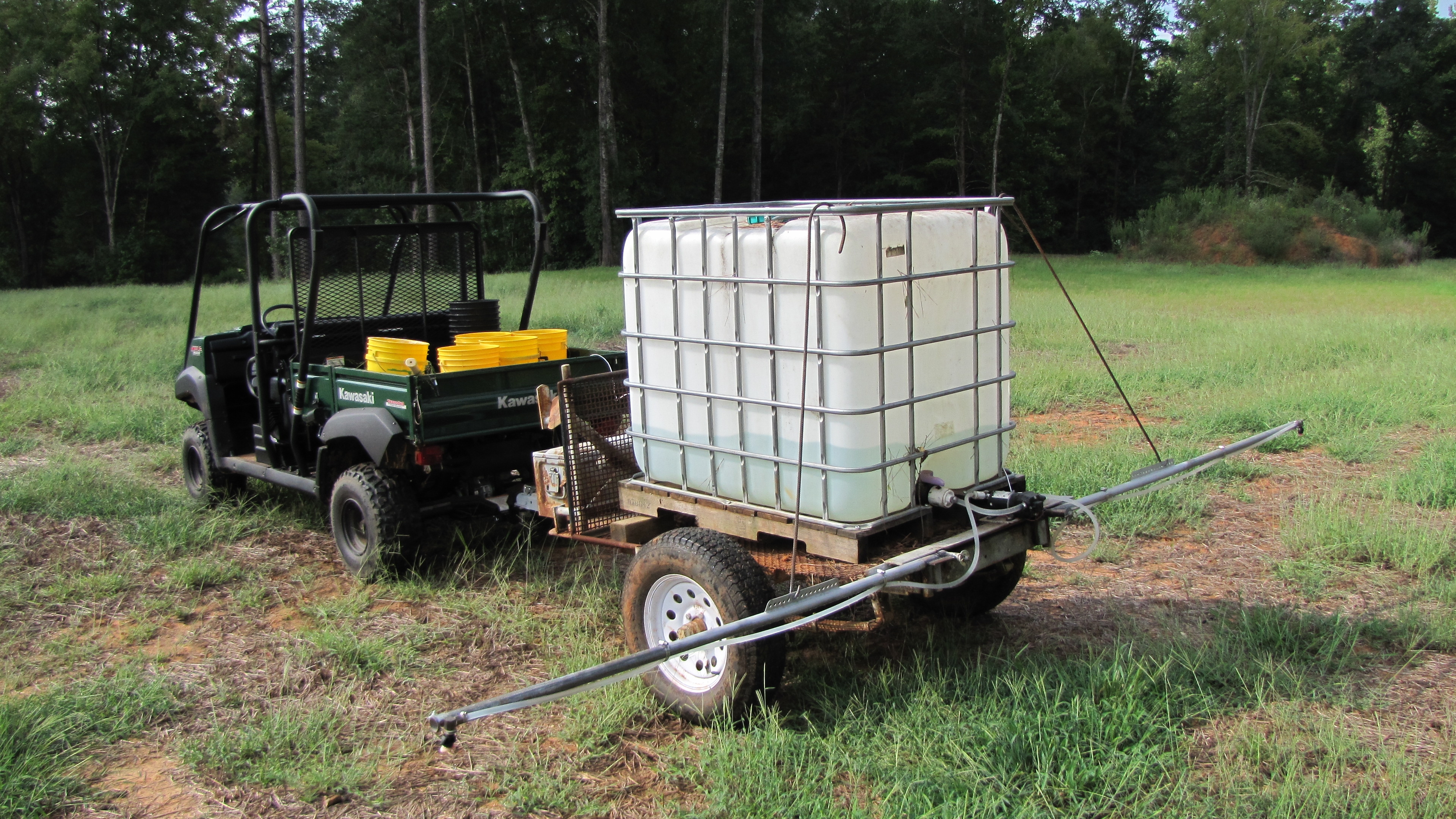

I put a 300 gallon tote on an old trailer that I found abandoned on my land. It needed new tires and a few modifications to make it work. I put some treated blocks under one side of the tote so it was angled at the back so everything would drain out. I like the trailer idea because I can pull it with my Mule, or a tractor that doesn't have anything attached to it. Usually that's my little 37 hp tractor.

I'm currently assembling a fire fighting trailer with two 230 gallon totes and a 2" trash pump. I could add a spreader bar and water the road but 500 gallons will hardly solve the problem for more than day.
Really takes about 2-4k gallons to make a difference in workability and dust control in my experience.

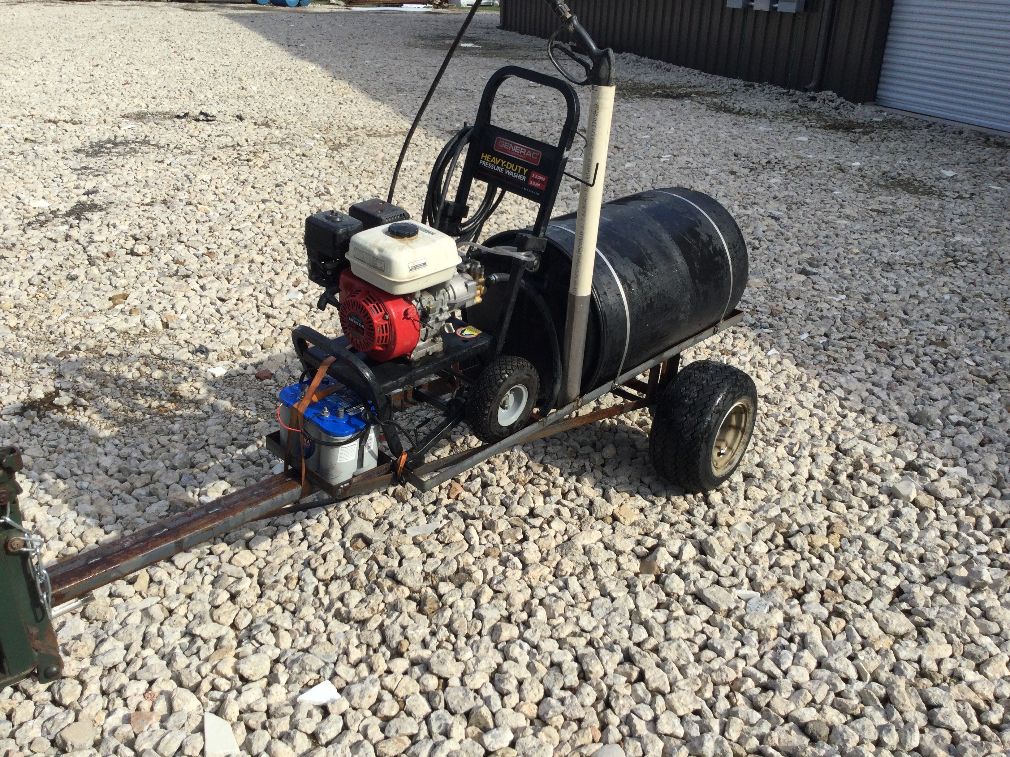

I would use a pump. You can get galvanized pipe and put T's in between each section and use power washing nozzles to create a spray pattern. This way you can make your spray bar as wide as you want and have as many nozzles that you want. I would think a nozzle every 12" would be plenty. It will be cheap and simple to make.

I have made portable pressure washers using 50 gallon drums. I use a 12 volt intercooler pump to prime, you don't need it after that, for my pressure washer. Might be able to wash a full size truck twice, if it's just dusty and not muddy...

On all of my power washing trailers, I set the tank up higher than the pump inlet so they will self prime. But my smallest tank is 150 gallons so there is some force there. I also always run a "T" valve off of the tank with one side going to the washer, and one side for when I just need some water, also allows for easy draining.
Is this set up just gravity fed?
