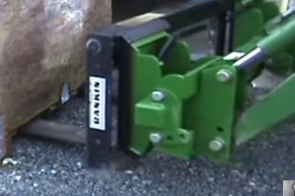

Hydraulic Cylinder Upgrade On John Deere - YouTube
This video shows what appears to be an SSQA with adjustable rollback angle.

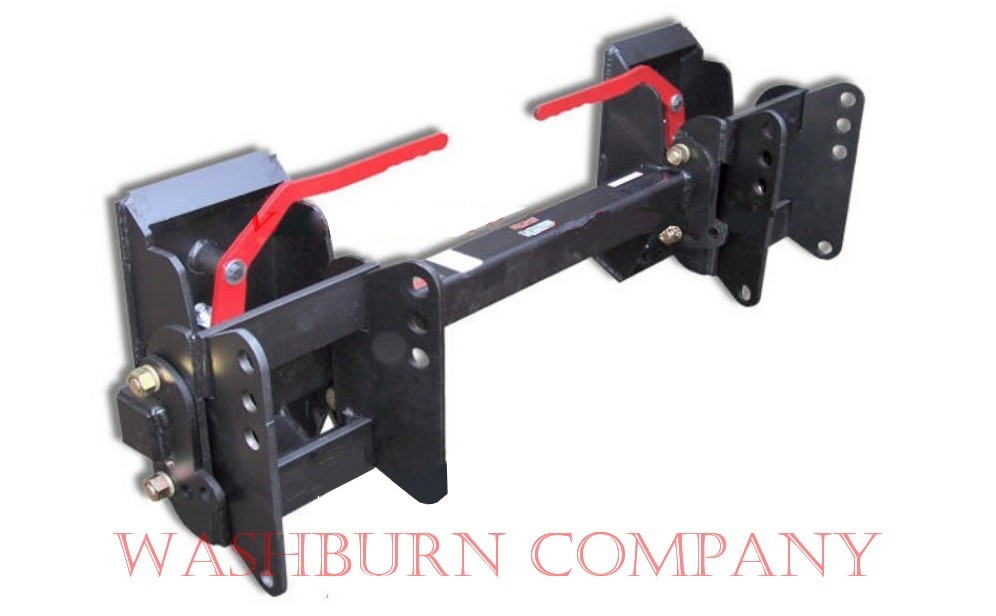

This is a snip of the SSQA that appears to be adjustable for the range of curl.
Anyone familiar with it?

   / 3 pt. attachents mounted to loader #26
I have the road boss with the skid steer adapter. It works great and can be attached in either direction. It is pretty custom to fit the road boss frame but something similar could be built for most attachments fairly easily.

I had previously posted pictures of it in a thread about adding rollback.
