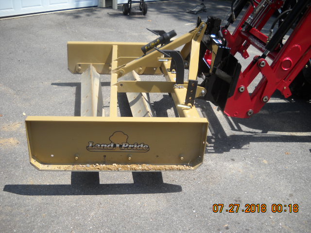

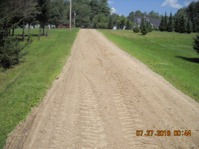

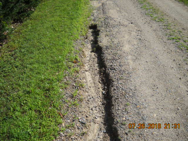

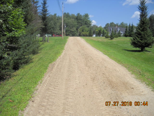

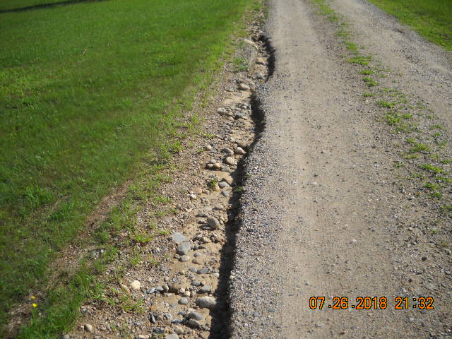

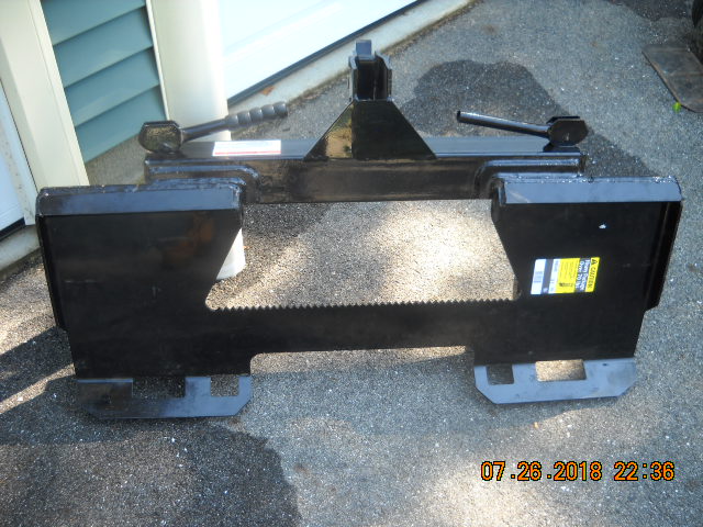

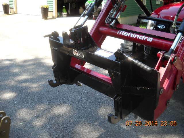

I have a follow-up to my post of 4/8/18. As I had previously indicated - I hardly ever remove the backhoe from my tractor and I think I have hit upon an idea to eliminate the following to grade my driveway: A. Remove backhoe B. Attach 3 pt hitch C. Attach land plane to 3 pt. D. Re-grade driveway with land plane E. Remove land plane F. Remove 3 pt hitch G. Re-attach backhoe. Therefore - I ordered 2 rear blades from Land Pride and attached to my land plane. Then I ordered (on Amazon) a 3 pt adapter with SSQA and today I mounted on front loader of my Mahindra 2555 and was able to drive forward to regrade my 600 ft long driveway. Did not use the ripper and drove slowly - but it worked Great!!

I have one of these Landpride SH35 which does exactly what you are looking for. Works well
https://www.landpride.com/ari/attach/lp/public/manuals/320-019pk.pdf
Andy

Hi everyone - Finally figured out how to post pictures. Here's some before and after driveway photos and also tractor pics with landplane. Thanks.
