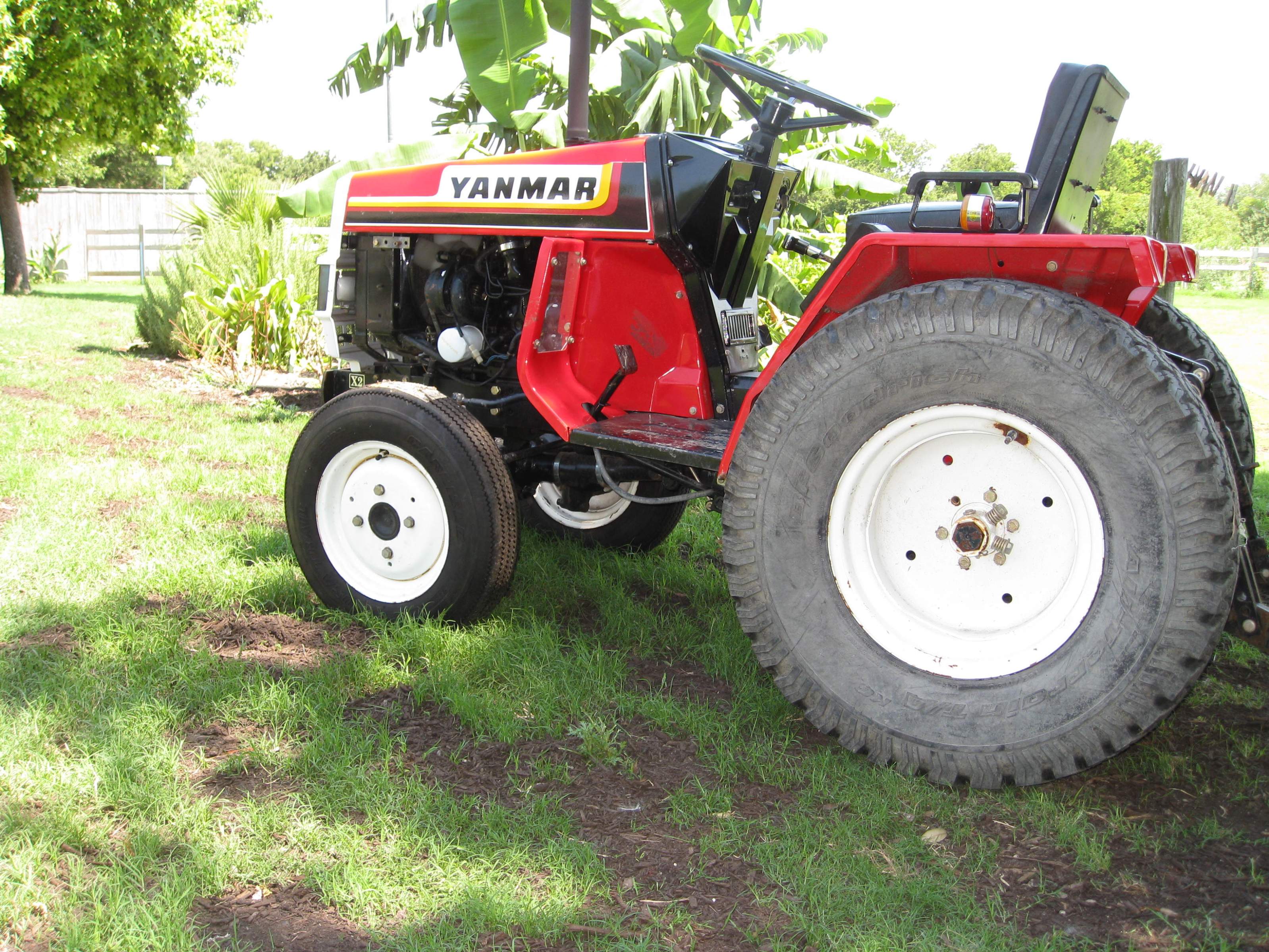

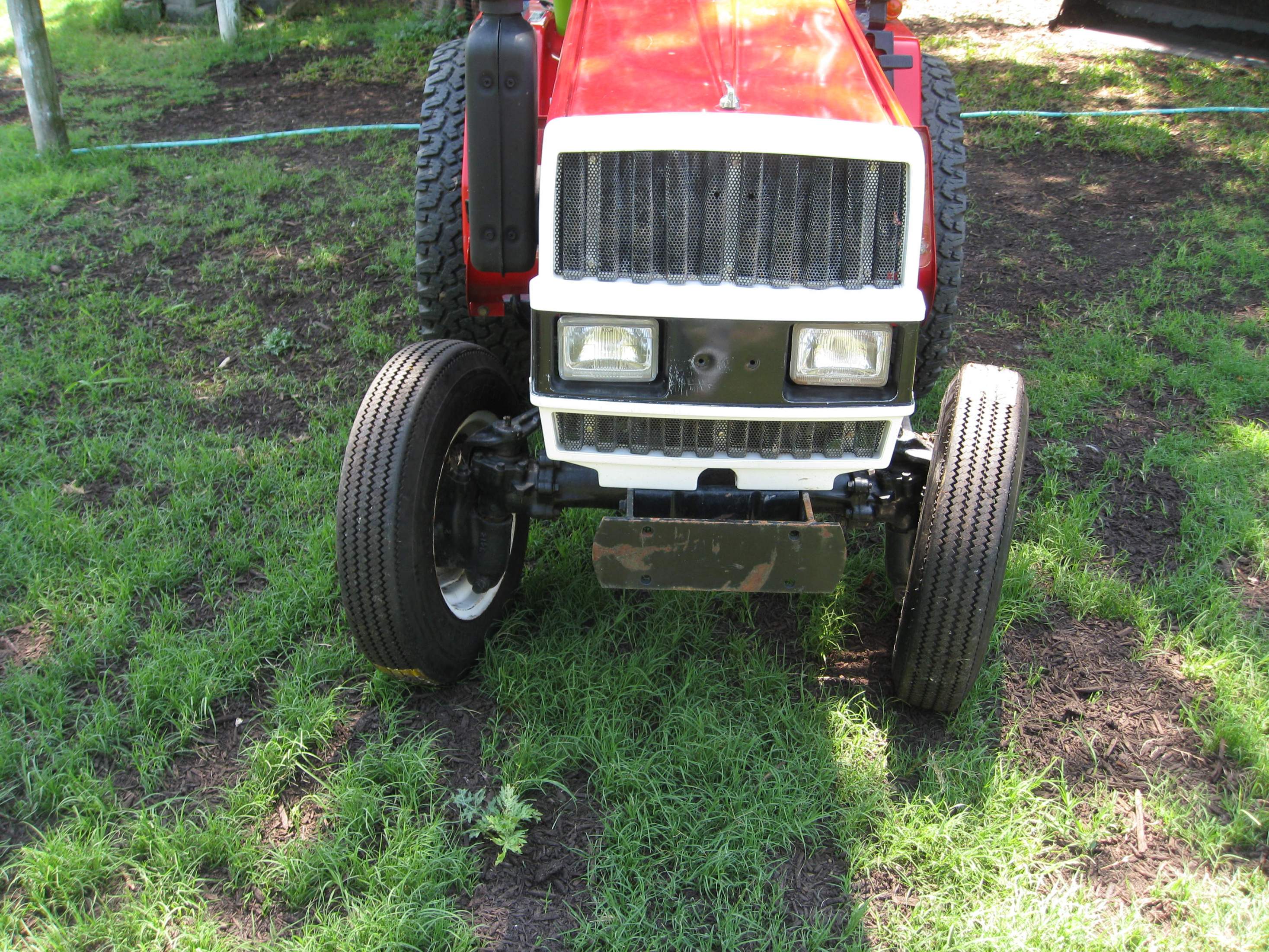

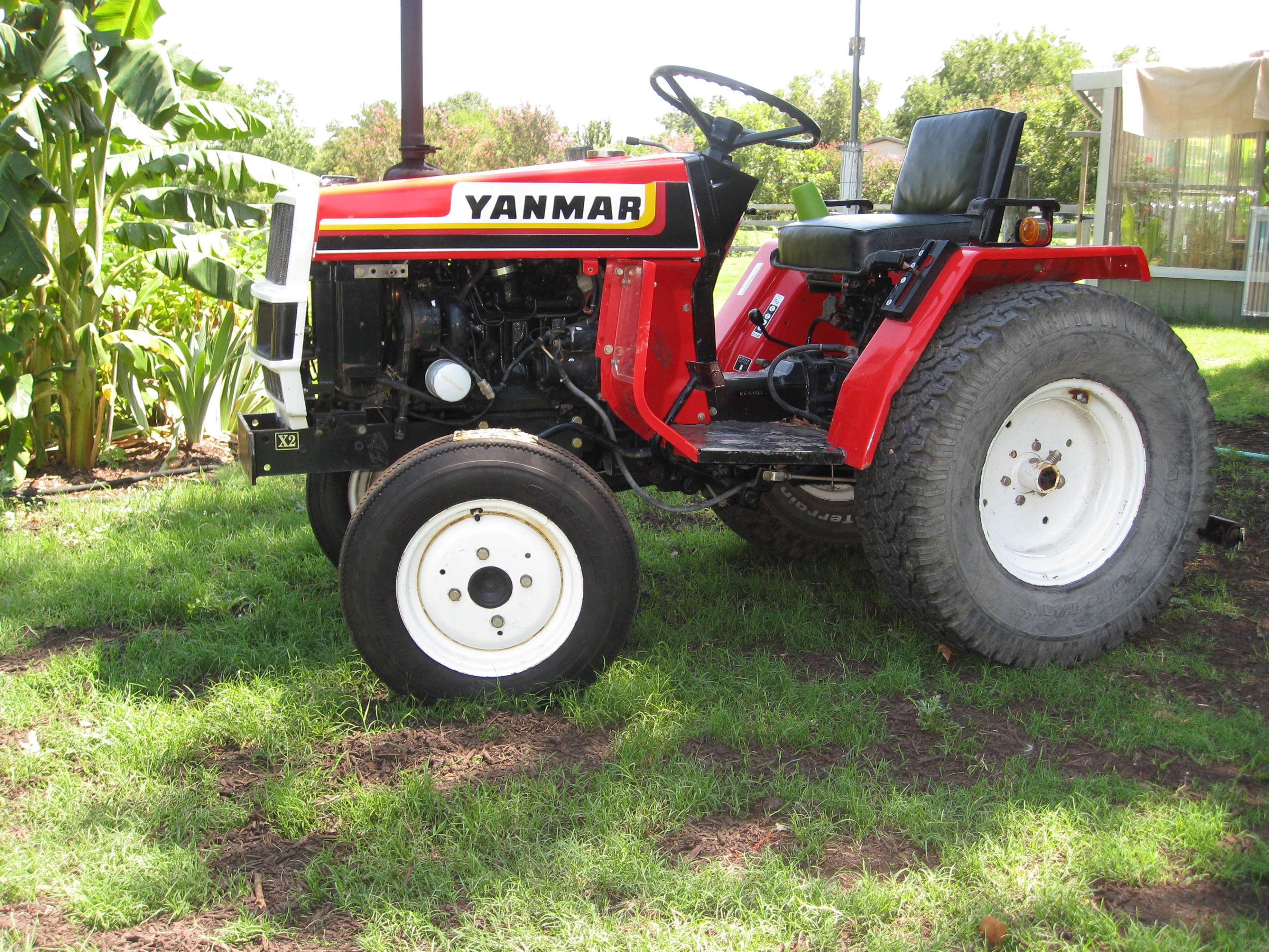

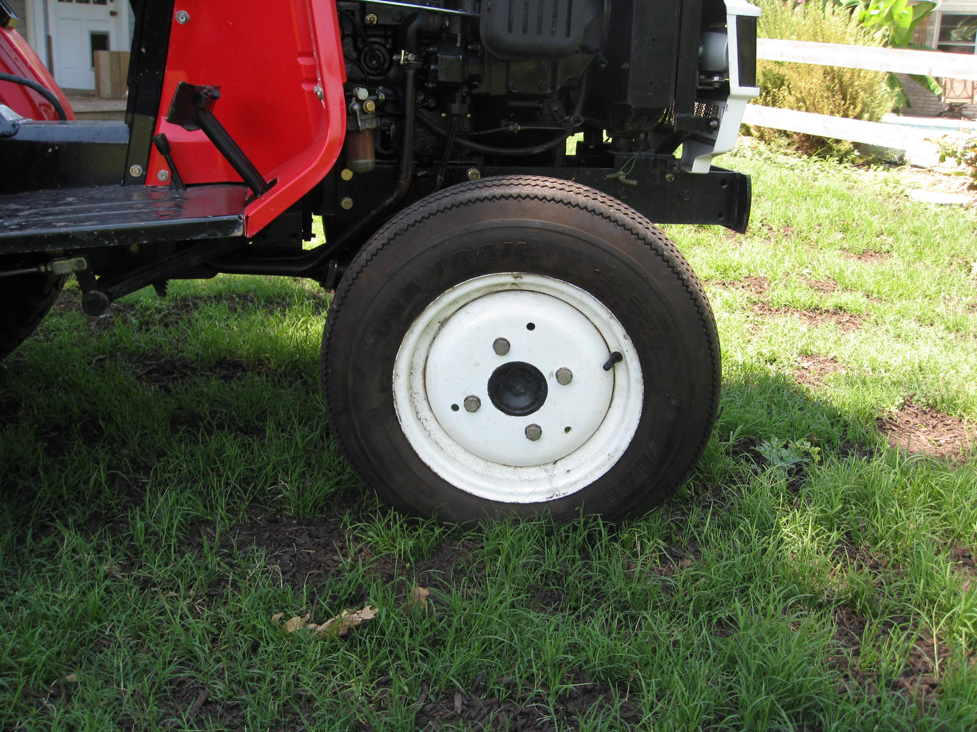

Hey Bob. The front tires I just had mounted seem to be a good cheap alternative to the ags that I replaced. The ags were really tuff on the lawn, and alternative tire selections in a 5x12 were pretty limited. I wouldn't recommend these if your "working" your little tractor hard and needed all the front traction you could get, but in that it's your wife's ride these might work pretty well for you too. The steering effort is way less than with the ags, and there is no bouncing of the tractor.
Trailer tires are about all I could find in a 5x12 road type tire, so I first got the Northern Tool trailer tire, a Load Star in the 5.3x12, Load Range C rated at 1045 lbs., but they were too short of a diameter by about an inch. So I went to a small tire shop and the guy had two Carlisle USA Trail in 5.3x12 Load Range B rated at 845 lbs., and they are within a quarter of an inch. Although I preferred the higher load range, I figured this would be about as close as I could get to the orignal diameter, and got them. He traded me for the ones I had and only charged me $20 to mount, which was a real hassle because of the rust inside my rims.
My cost in the two tires I traded was $37 each. Attached are pics. The little tractor is pretty dirty, we've been using it a lot for our lawn rennovation. I took the sides off to do some maintenance and it's been so hot I thought I would leave them off this summer, even I have no cooling issues.

Thanks again Ron for the tire sizes & great Pics . I might go that way as well As I cant imagine Her ever needing the 4 WD . Sure makes it easier on the grass as well as Our gravel driveway .
Those ole rear rice tires would rut the drive everytime She would move it . So the fronts would further cure the problem & I was hoping it might make it steer easier for Her, so thanks for verifying that .
Good Idea on Yours to savageactor7 , Simple but gets the job done . Thanks for the pics. :D . Bob
