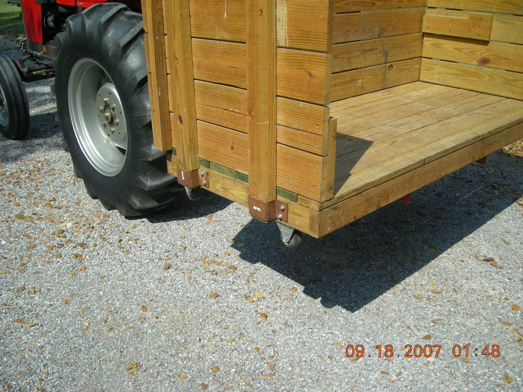

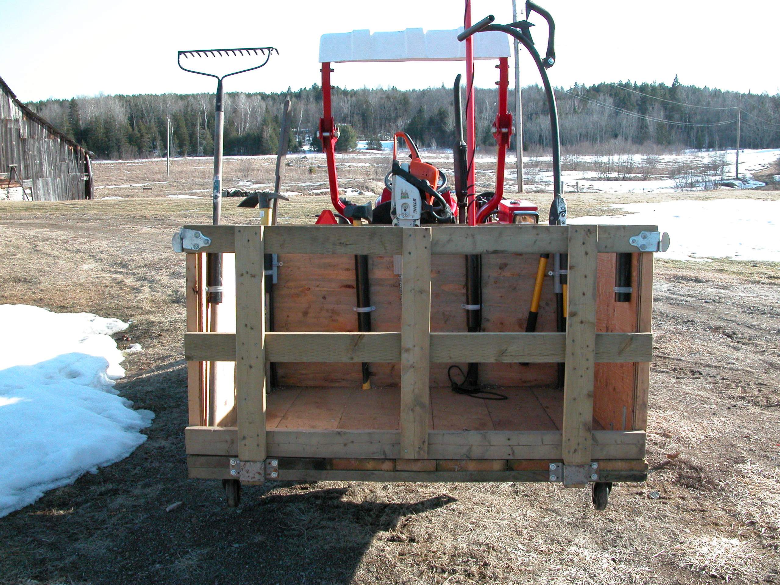

I believe using stake pockets on the sides will allow us to quickly add/remove the sides. However, what is the best way to secure the corners of the sides to the front boards in a manner that keeps the sides from moving around. More importantly, this mount also needs the flexibility to allow us to QUICKLY detach the sides from the front. Any suggestions? :eek:

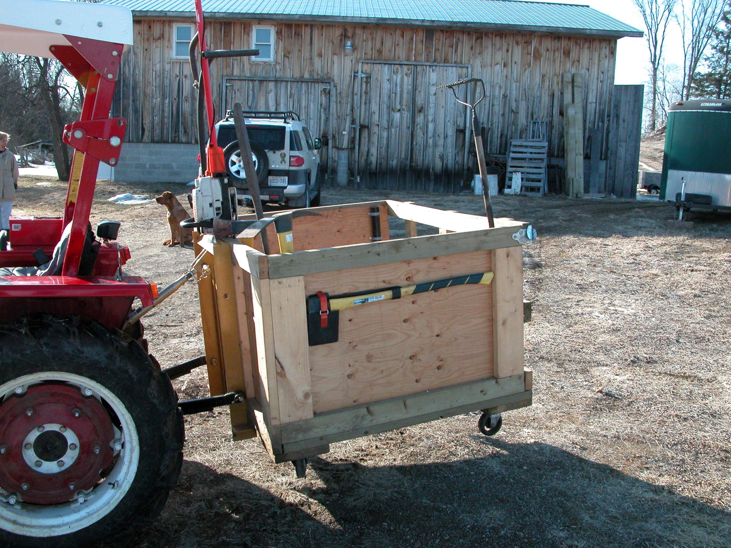

Here are pics of one I built using scrap PT pieces from the clearance bin at home despot, scrap conduit and pvc, a piece of vinyl decking for the chainsaw holder and four casters from HF to roll it around the shop floor.The back "gate" uses stake pockets and rack corners to attach. The frame is a TSC one with the top link hole annoyingly drilled for a cat 2 pin:(
It rarely comes off the tractor in spring summer fall
View attachment 135622View attachment 135623
Very nice studor , Thanks for the pics . More great ideas . I might actually start on mine today, :D . Bob

Trook -- find a set of rack hinges or connectors. You can see cheapies on the top corners of the "gate" on mine in the pictures. There are nice ones made in cast. You can also use hinges with a loose pin --- make a pin in an L shape that you can pull out by hand
regards
You could do something like this. I have a set for my trailer and they work well. The only issue is that I can't see to find them on the Northern Tool website anymore. They have the picture for them, but nothing else.
   / 3 PT Carryall box ? #46
^^^ those corners are sweet.
What are they even called?
I'd search for them, but its hard to without a name!
   / 3 PT Carryall box ? #47
Deadman
They are called stake rack fasteners or stake rack corners.

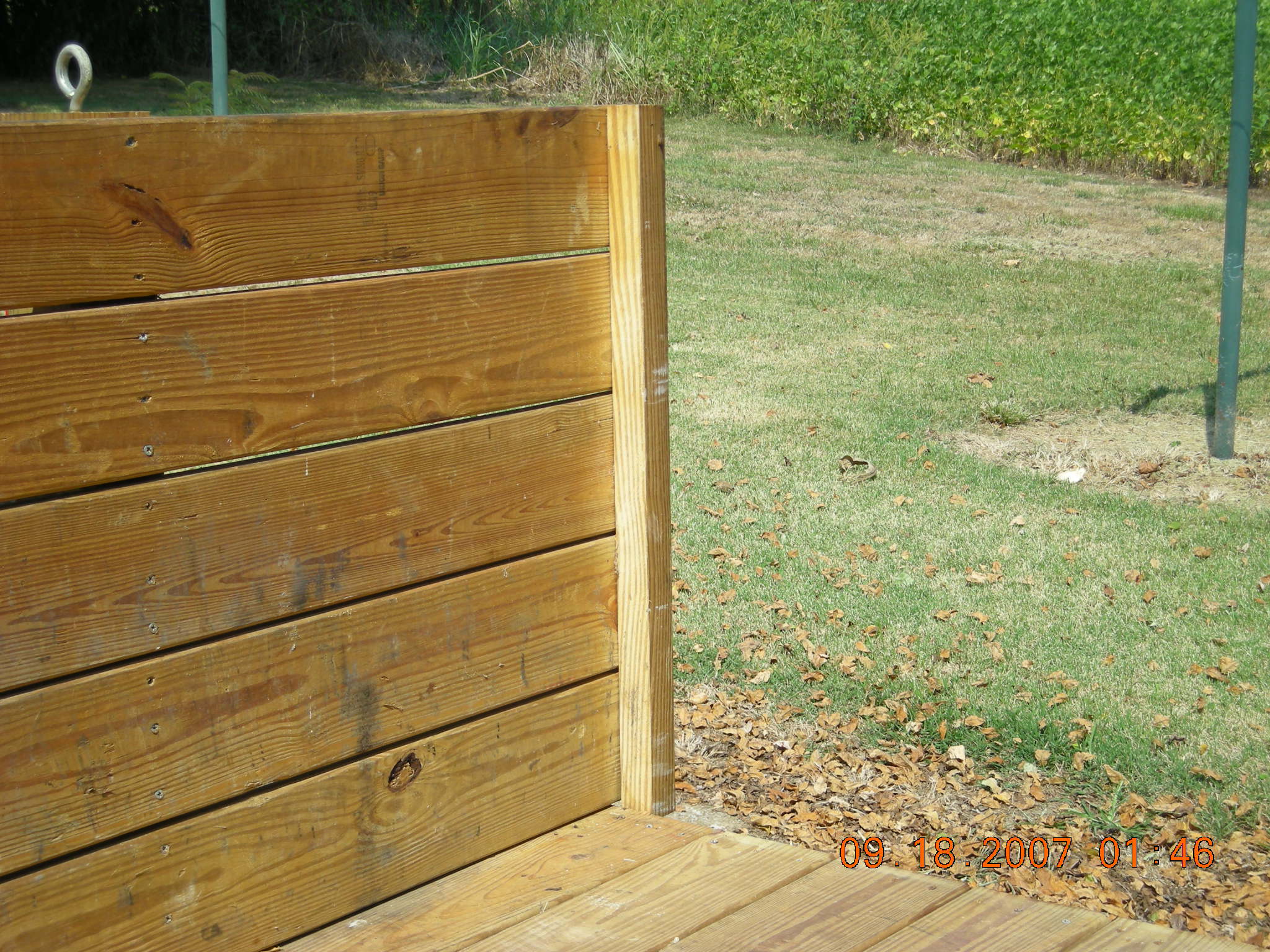

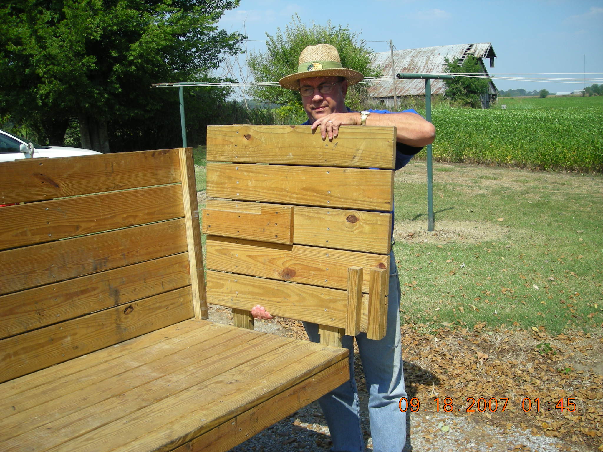

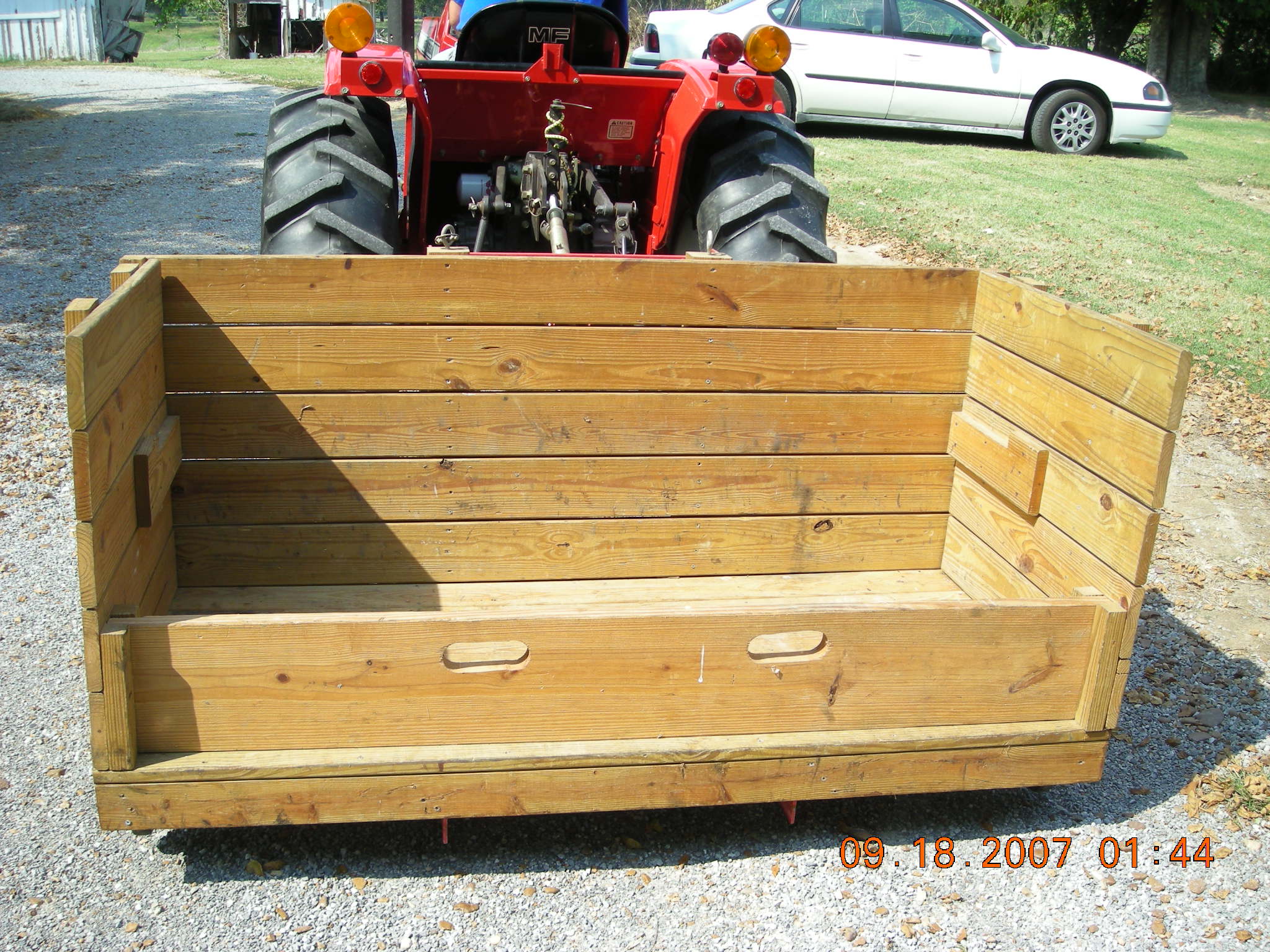

try this method for detachable sides ,easy and simple
Another nice design ae_ted , Simple & easy as You say . Thanks for the pics . I Love the seat as well :D .
