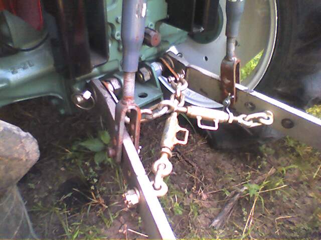

Sorry I didn't reply sooner, with the software and upgrade issues going on here, I just stayed away for a few days to let them get things sorted out. If I can figure out how, I'll post up a pic of mine.......this first pic is of how it was. You can also see the loops I made for the chains, and how they hook over the pins just inside of the arms.

The arms on my tractor won't fit that close to the center. There''s too much metal around the ball. Did you have to grind yours for clearance?
Leon
   / 3 pt hitch bent #27
Yes, actually, I did have to round the corners off a bit so they could pivot up and down, but I don't think it compromises the strength any....you can see it on the arm on the right.
One advantage of having the chains on the inside, if your pins on your implements are also on the inside because of the narrow track of the tires, it makes it easy to change implements without having to loosen the chains first.

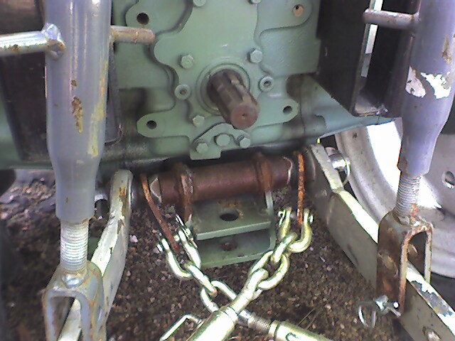

Here's a pic on my new and improved lower pivot arm pins. You can see the tube I threaded and welded to those ears. I don't think I'll be bending them anymore.............

I couldn't see how I could grind enough off my lift arms for them to fit close to the center. I decided to try to build some supports for the end of the arm as someone suggested earlier. I haven't mounted the sway chains yet, but here's a picture

I think your supports are a good idea, and will transfer most of the stress to the rod itself. You may bend it, but if so it's easily replaced.......
