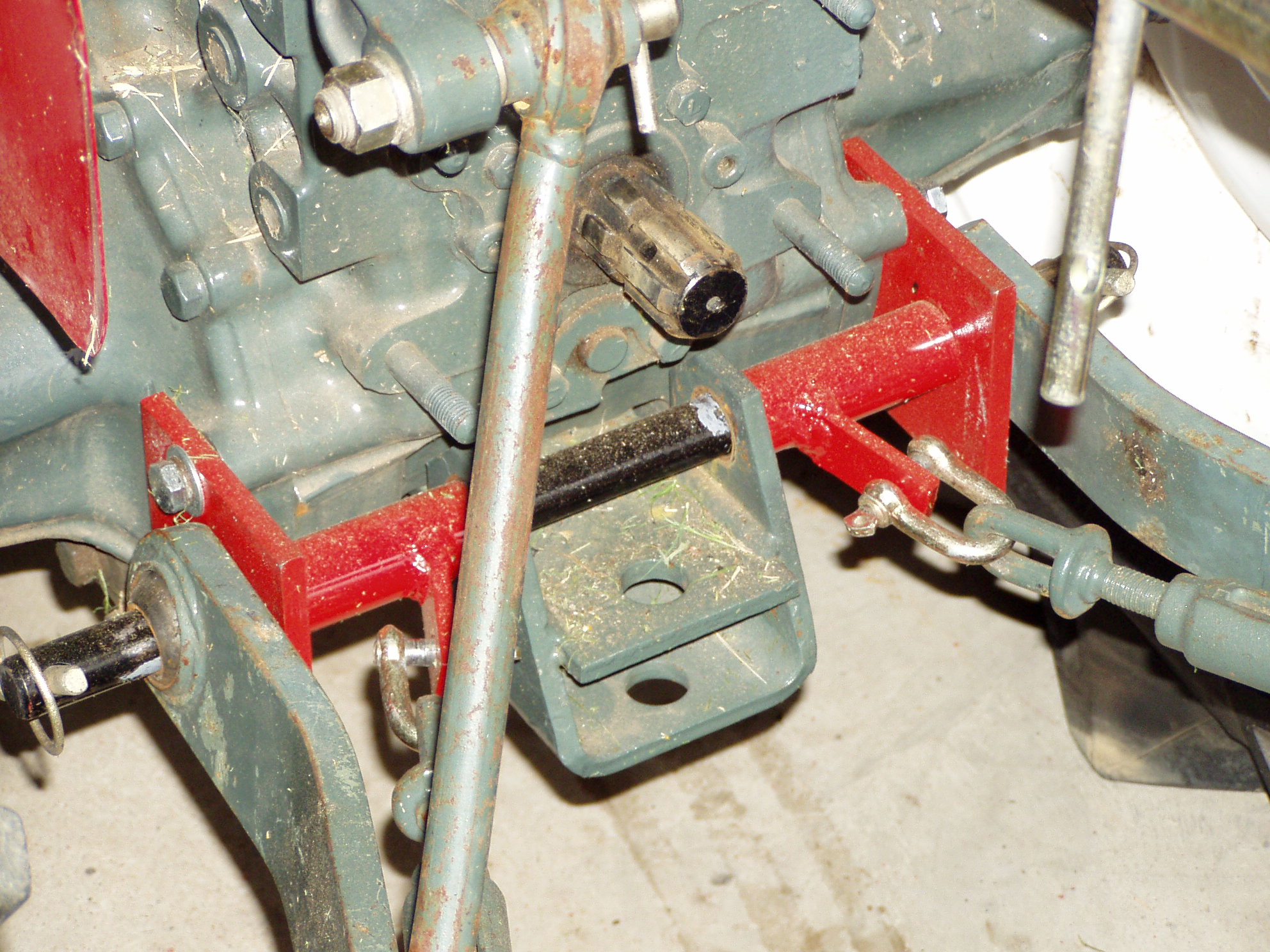

I built the new sway chain pivots and got the mower re-installed. It seems to work okay so far. Time will tell. The lift arms stay very close to the support brackets, so that will reduce the bending stress on the round bar. I've attached a picture of what I hope is the final configuration. Thanks for all the help in thinking this out.
regards,
Leon

That looks great, good job. My only question is with the sway chains almost at the same angle as the lift arms, do they hold the lift arms in OK? Seems like they would work better crossed, because the angle would be sharper.....
Good job on the bracket, that looks very strong and well designed........
regards,
Leon
Now all you need is to cut 2 more pieces of that pipe that the rod passes thru, and then add 2 washers to eich piece.. and use them as spacers betwixt the lift arm and the lynch pin.. keep those ars close tot he support rathern than moving out to the end.
Soundguy

The chains seem to be working ok. I think you're right -- a larger angle would work better.
I looked at a friend's Kubota 7100 the other day and discovered this setup is almost exactly what he has.
The axle trumpets already had flats ground in to support the brackets. I suspect there is a factory heavy duty setup that uses them.
I'm thinking of drilling another hole in the rod so I can move the linch pins closer in and limit the outward travel of the arms. I'd have to get a different style pin -- one that has a retainer on the side.
Leon

Just use a couple large washers and a spacer.. made from the same pipe the pin slides thru... should work fine... Way easier than drilling that rod for a hairpin or something else..
Soundguy
