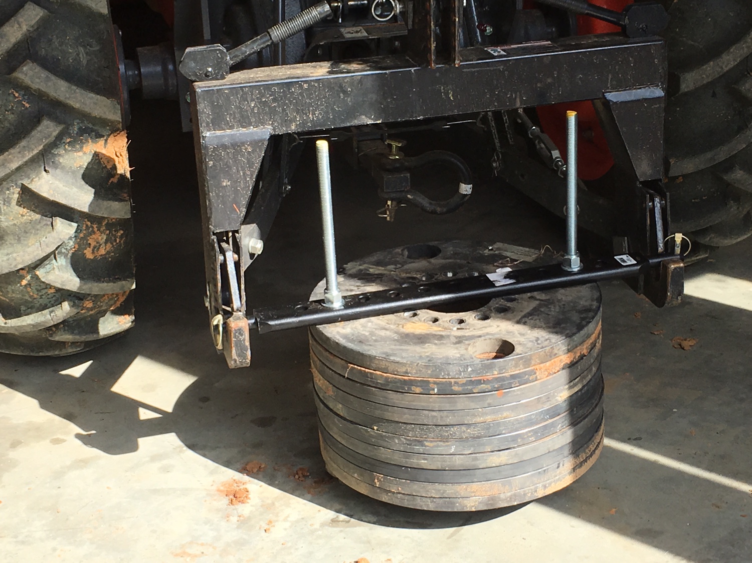

   / 3 Pt. Hitch - Extra Tractor Weight ? #15
This is what I currently use for f I don't have the box blade on.
Each disc is 64 lbs. I have 10 more discs but haven't gotten around to using them to up the weight as the 650 lbs I have approx now seems to be working well.
