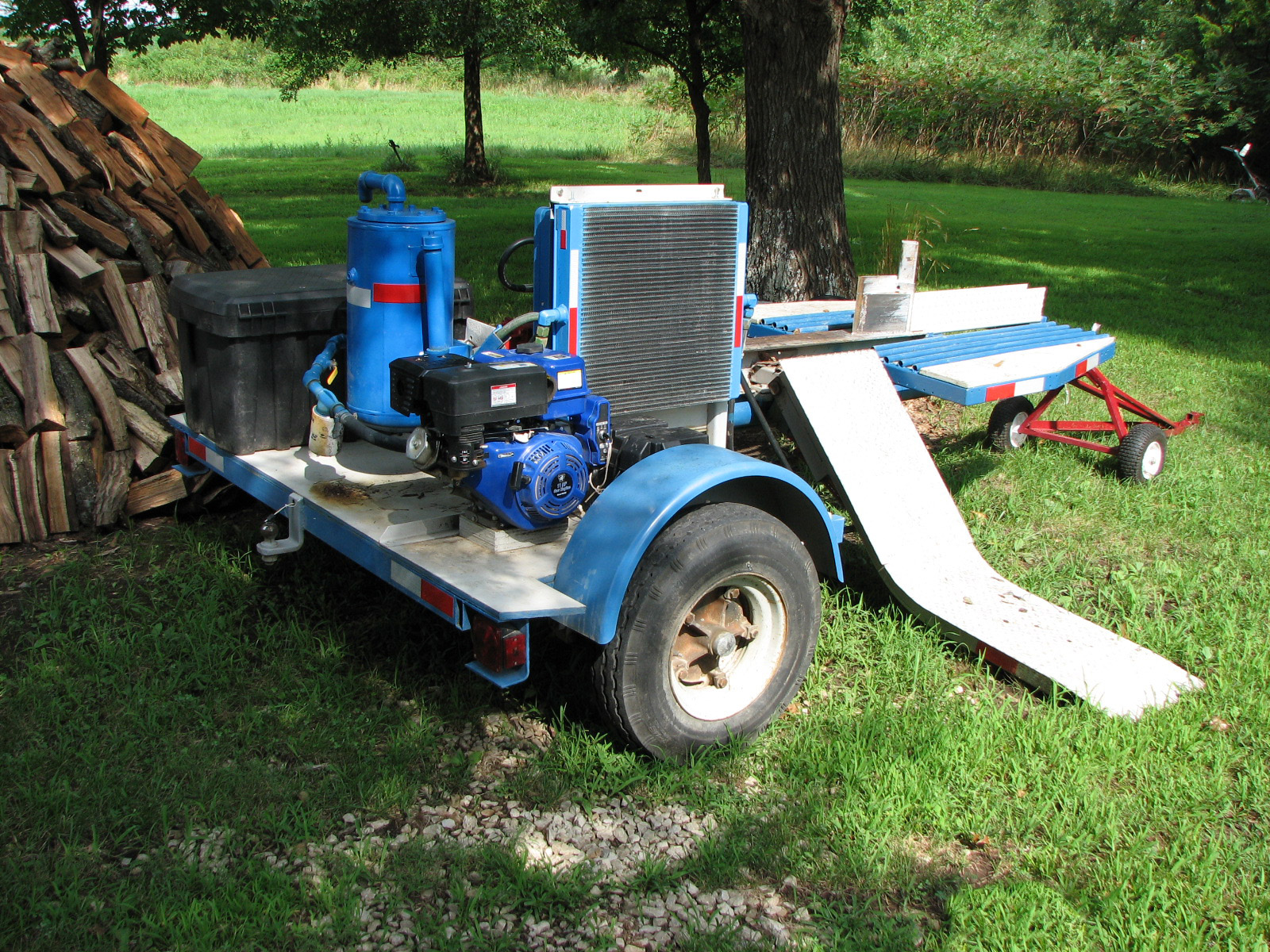

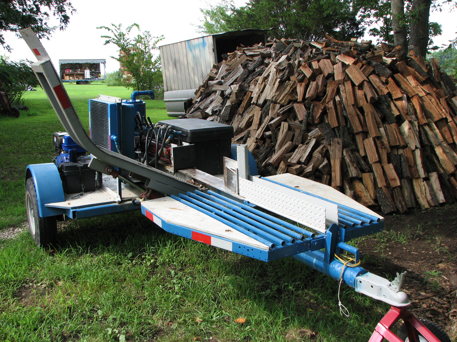

I started off with a piece of I-beam with 2 pieces of flat welded on one end with 3/4 holes for half a hing a wedge welded to the other end, an 8" length of 2" sq tubing which had a 5" piece of 3/4" pipe welded across the end of it that slid into the 3pt hitch mounted receiver for the other half of the hinge & a 4x24" cylinder mounted to the beam with the push plate which was powered by the tractor remote/valve.To raise the beam I would hook a short chain to the top of the receiver hitch where the center link connected and the push plate. When I extended the push plate it would lift the end of the beam off the ground.
Pro: 1 - Less than $200 invested.
2 - Very little time invested in fabrication.
Con: 1 - Length of hoses did not allow the hydraulic fluid to circulate from the hoses/cylinder & caused heat build up.
2 - Required someone to sit on the tractor to run the valve or you had to hook a stick to the valve to move it. If someone else was operating the valve you had to be very careful they made sure hands were clear before cycling the cylinder.
3 - Too much bending over. I while I liked being able to roll large rounds onto the beam while it was on the ground, my back said to find a better option.
4 - As many have said: higher fuel usage, wear on tractor, & it tied up the tractor.
So --- I decided:
1 - Once I picked the round up off the ground it would not hit the ground again until it hit the wood pile.
2 - It would be a stand alone.
3 - Have a log lift. No bending over to split!
4 - Dedicated horizontal splitter. (Wedge welded to beam.)
5 - Have out feed tables.
6 - Use a single wedge. (Elm & hedge - Not good candidates for 4 way wedges.)
7 - Be heavy & wide enough wheel base to pull a trailer with. (Carries the saws, gas/oil, accessories, & holds 1/2 cord of wood.)
Built my own using the initial setup. Added an oil cooler with box fan to allow for splitting in 100 degree plus heat. Later added a wheeled hydraulic jack stand. (Makes hooking it up a snap!) The 2" coupler screws out and a pintle eye can be screwed in or just leave it without any hitch to deter theft/ borrowing.
(The attached photos are before I moved the hydraulic oil filter to the suction side and added the wheeled hydraulic jack stand.)

Oliver, That is the best splitter I've seen yet.
   / 3-pt Hitch Log Splitter or Gas standalone? #35
Oliver, that is one heck of a splitter!!!!

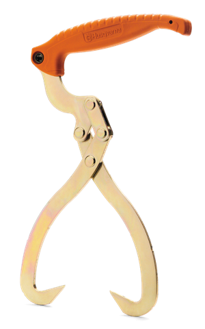

While we're on the subject of saving backs, these Timber Tongs (sometimes referred to s Lifting Tongs) are the best $35 I've spent on my firewood handling. You can pick up a round without bending down, using one hand. They release easily with a flick of the wrist. They are also helpful dragging longer logs around, or repositioning them for cutting.
They make both 8" and 12" tongs. I use the 8", since they are compact and easy to carry in the woods. The 8" model will pick up most 10" diameter rounds, and a lot of the 12" logs I run in to (sometimes with a bit of "persuasion").

i just ran into town for some errands and picked up their last 12" timber tong for $39.99 at TSC. can't wait to use them - thanks for the tip!
