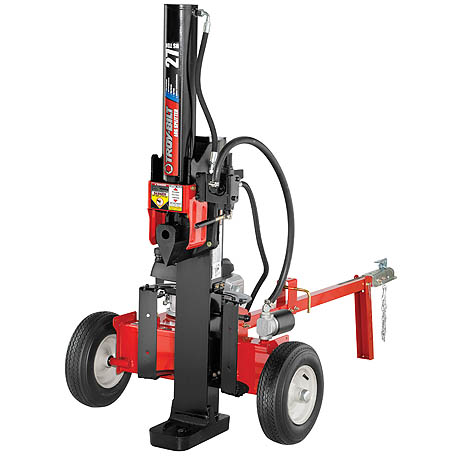

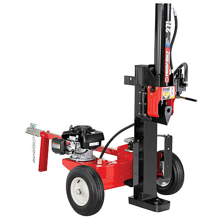

But having said that, I removed my log "cradles", cut off the splitter ends and redrilled them to flatten them out, then mounted 3/4" plywood log tables to them to make work better to catch and re-position pieces that need to be re-split.
I still have some more mods to make, because I made them extend too close to the beam, and bigger logs can catch on them, so I'm going to trim them back a bit and then [I think] add a raised metal rim to keep logs from vibrating off of them onto my feet.
galleryImage20120711085526_Zoom.jpggalleryImage20120711085427_Big.jpg27 ton splitter vert.jpg27 ton splitter vert 2.jpg
Probably the thing I'm least happy about on my Troy-Bilt from Lowes is the actual cylinder design. It's got a pair of round studs projecting from the sides [like old cannons had to serve as an axis of rotation to adjust the muzzle up and down] that serve to connect the cylinder to the beam unit. I have not seem many cylinders so equipped, so I don't know how hard it will be to replace it eventually.
You can see the round ends of the studs at the junction between the red log remover and the cylinder. The log remover being the piece that locks the cylinder from being pulled back out toward the stationary "foot" of the splitter on the ground [as seen between the wheels on the picture at right]- in fact, that was where the cylinder was when it was shipped [decreasing the shipping size].
Though I hope to be dead and long gone before the need to replace the cylinder arises.
