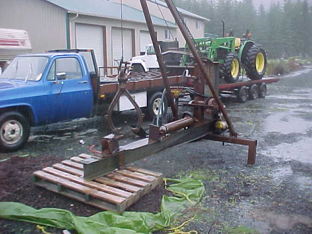

check inside the female side for a small o-ring. If it has the smallest burr or tear it will drip. I had so much trouble with mine I eliminated them and just went direct. Here's the one I built. It's been around awhile, but it takes on all comers.
