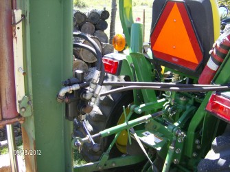

Mine is a speeco from tsc. I run it off of my power beyond for the backhoe. I really like it and have had no problems, nothing to maintain. But like others said, for the ability to change between tractors may be best to go with a pto driven pump.

Forgot to add. Only downside is that when I hook it up I have no 3 point hydraulics. I could plumb it so I did but it really hasn't been a problem. You can see it if you zoom in there is a hose disconnected.
