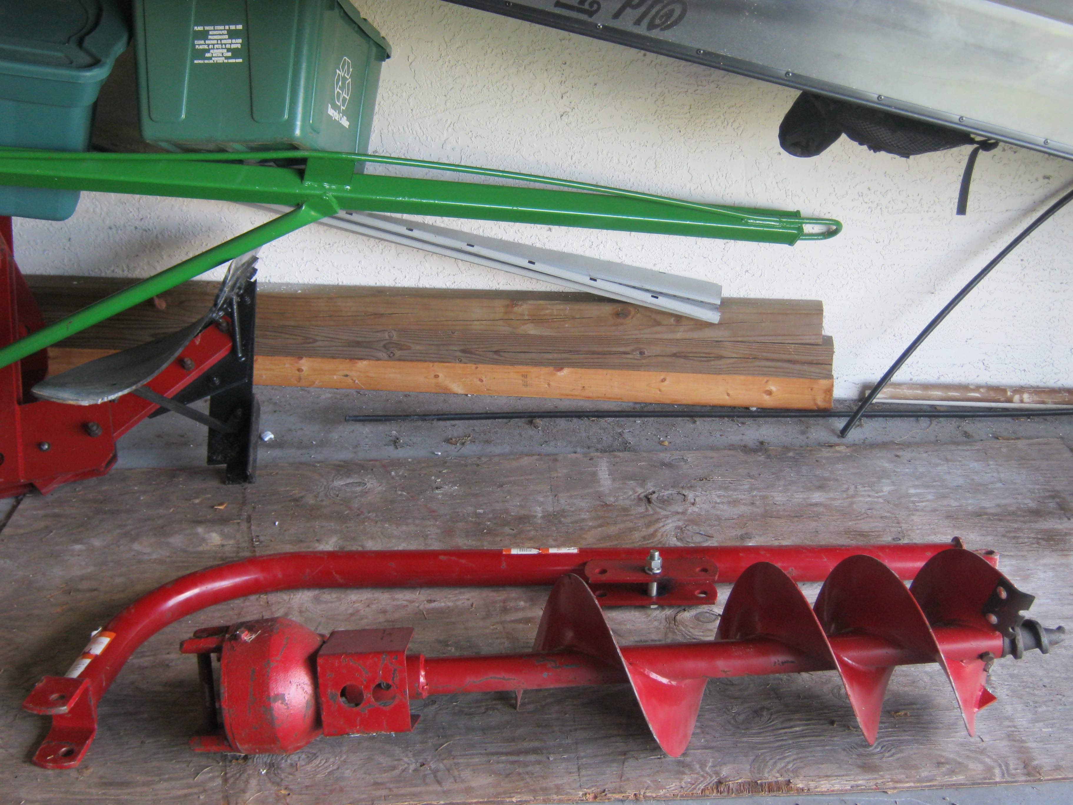

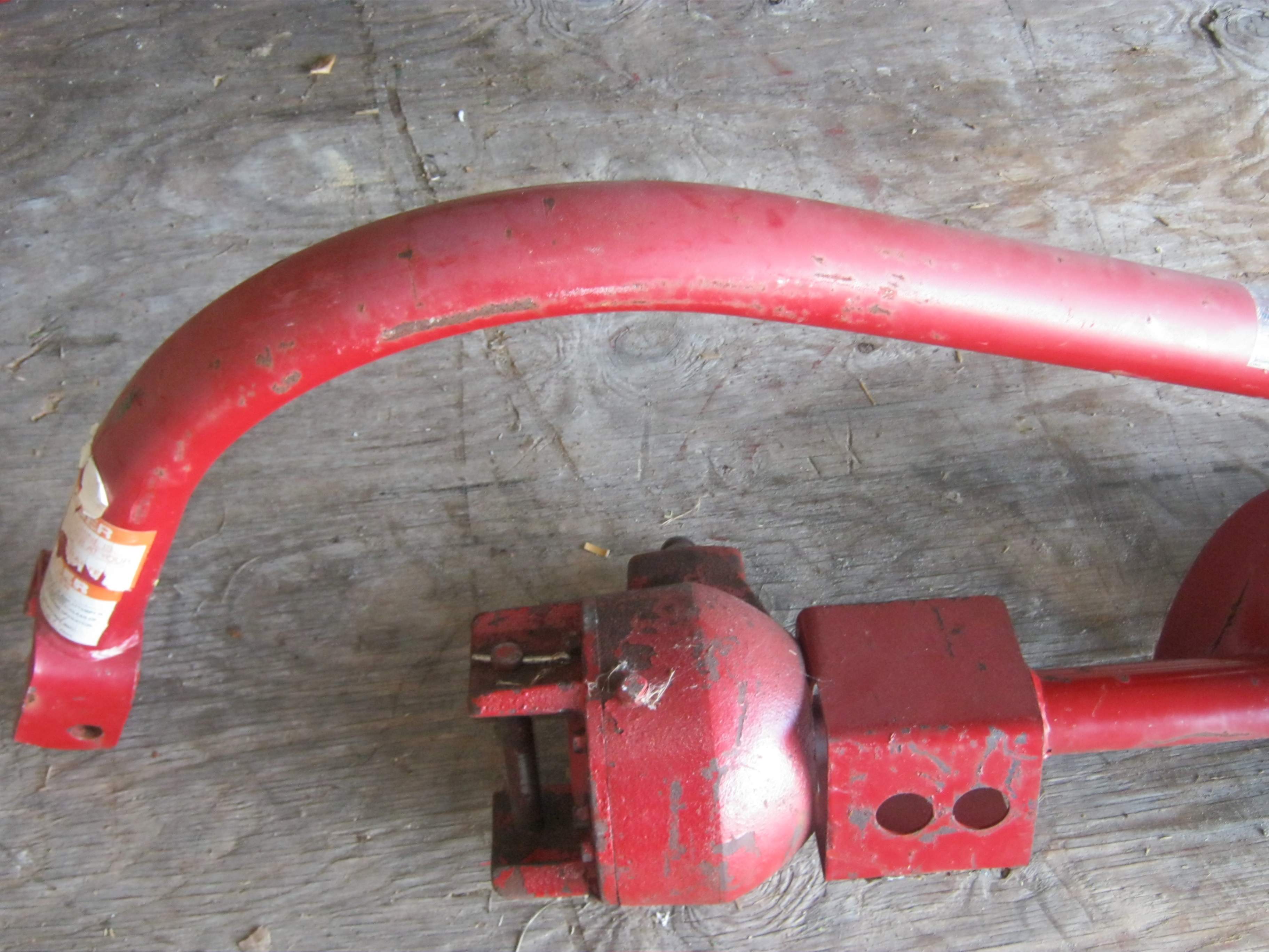

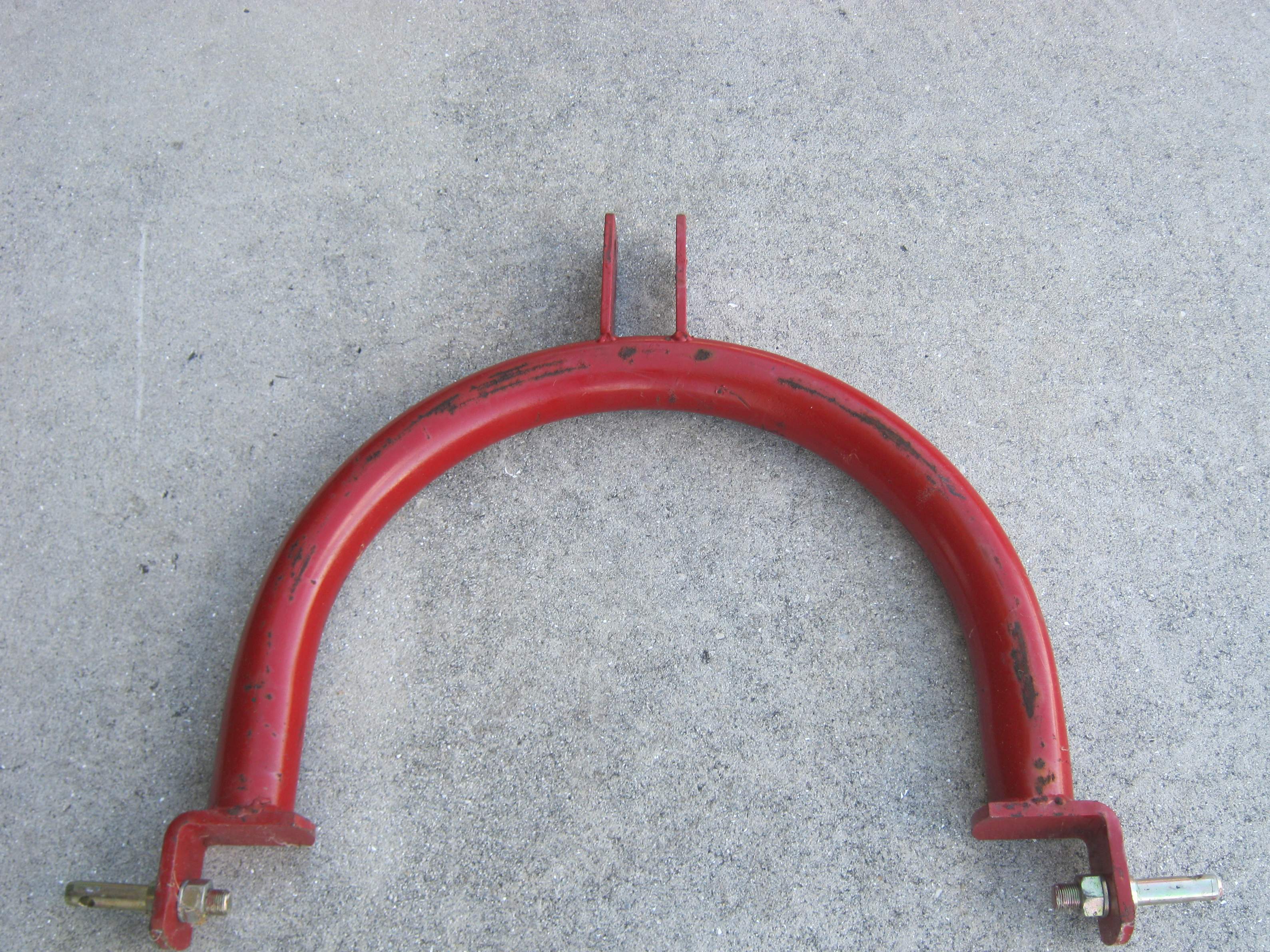

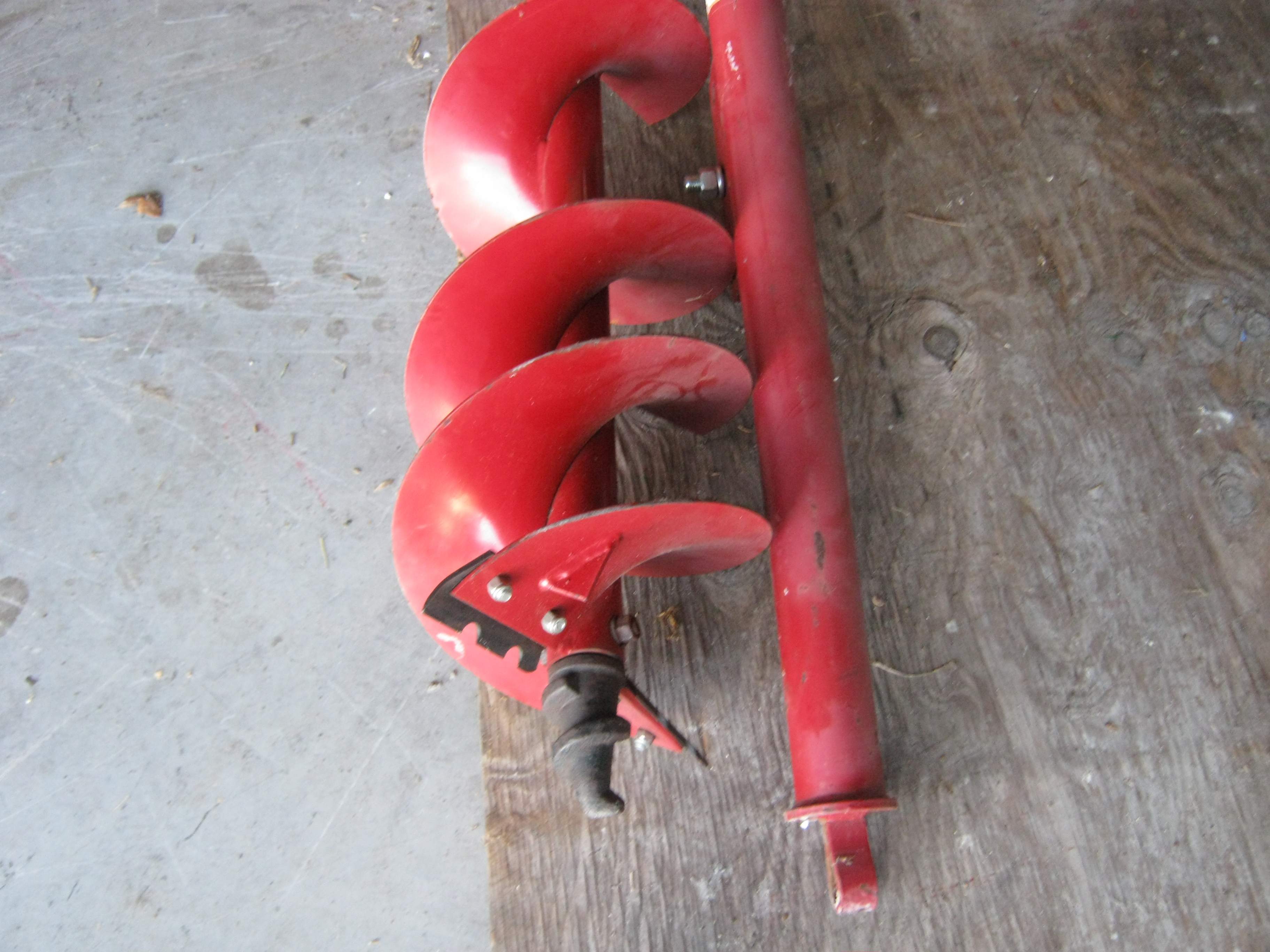

Ive never really been big on brand names if im not using it everyday. I bought a PHD for my tractor for $150 a few years ago. I don't know the brand all I know is that it is red. Came with a 12in auger which gives a nice whole for setting post. I would has I have dug about 300 post with it with zero issues. So it might be helpful to look for a used one that's cheap.
Heres an old red one I used to own with a 12" auger . If yours looks like this you have a World Agritech Corp or also known as International back in the day .......
Thats just like mine cept its a mite purtier than mine.
