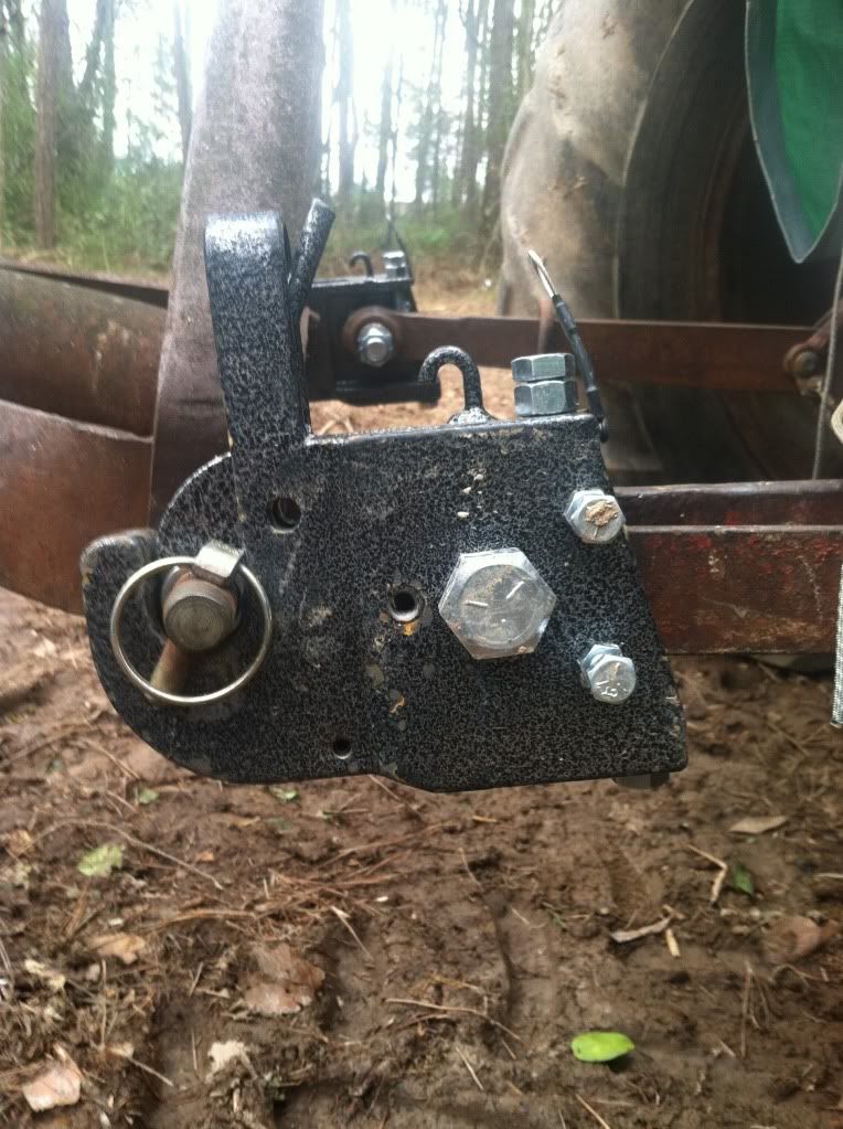

Well, I installed them on the old 8N this afternoon. Instalation was not as straight forward as it looked because the stabilizer bars kind of got in the way, but I put them on the best I could figure.
The bushings that came with them were about 1/8" to long to let the linch pins go in, but a little grinding and they worked.
I've gotta say, I was happy, happy, happy while playing around swapping implements around today playing.
We'll see how they hold up.

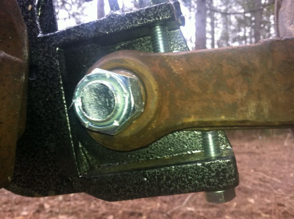

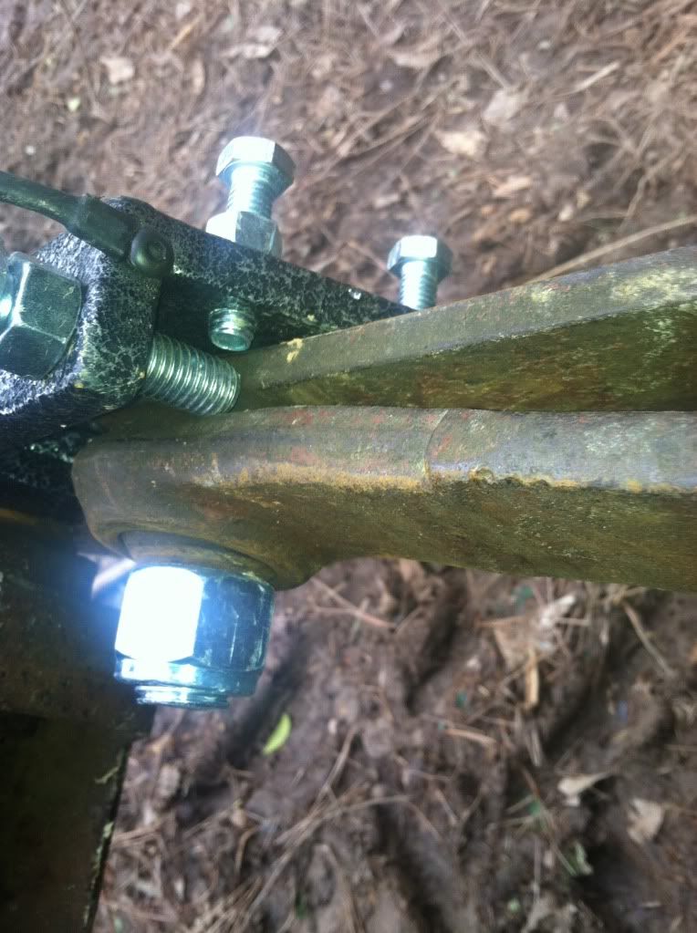

#13
Sorry it took so long to post some pics.
I've been happy with these so far. They were simple to install, but some of the bolts really don't do much of anything in this application. Also the very bottom bolt was to short to be able to use the jamb nut. Here's a few pics. If anyone see's something that I didn't install correctly or something that I can improve on (other than that lower bolt) please let me know.
These two bolt hit each other....

They look great! I think that you are going to really enjoy using them, and the time it saves. It's nice that they include the wire loop to hold the hitch open when you are hooking your equipment up. I have not had mine budge at all, and I have had some very heavy, and jarring loads. hope that you enjoy them!
   / 3 PT Quick Connect on a 8N #18
nice finish!

Spotco:
Thanks for the pictures. It makes it easier to see how these things attach. Not at all what I expected.
