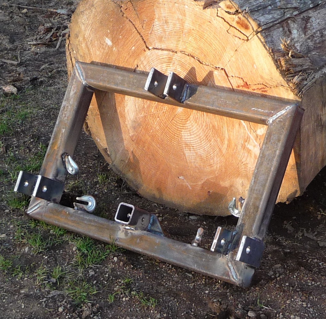

They are 1 1/2 Outside square stock, Is about 3/8 wall. Only use to move small pallets around, as my tractor won't pickup large pallets. lifting weight at end of drawbars is about 1600 LBS so will pick up about 1000 LBS. Is still handy to move things around like small buildings on skids just stick under one end wrap chain around and go.

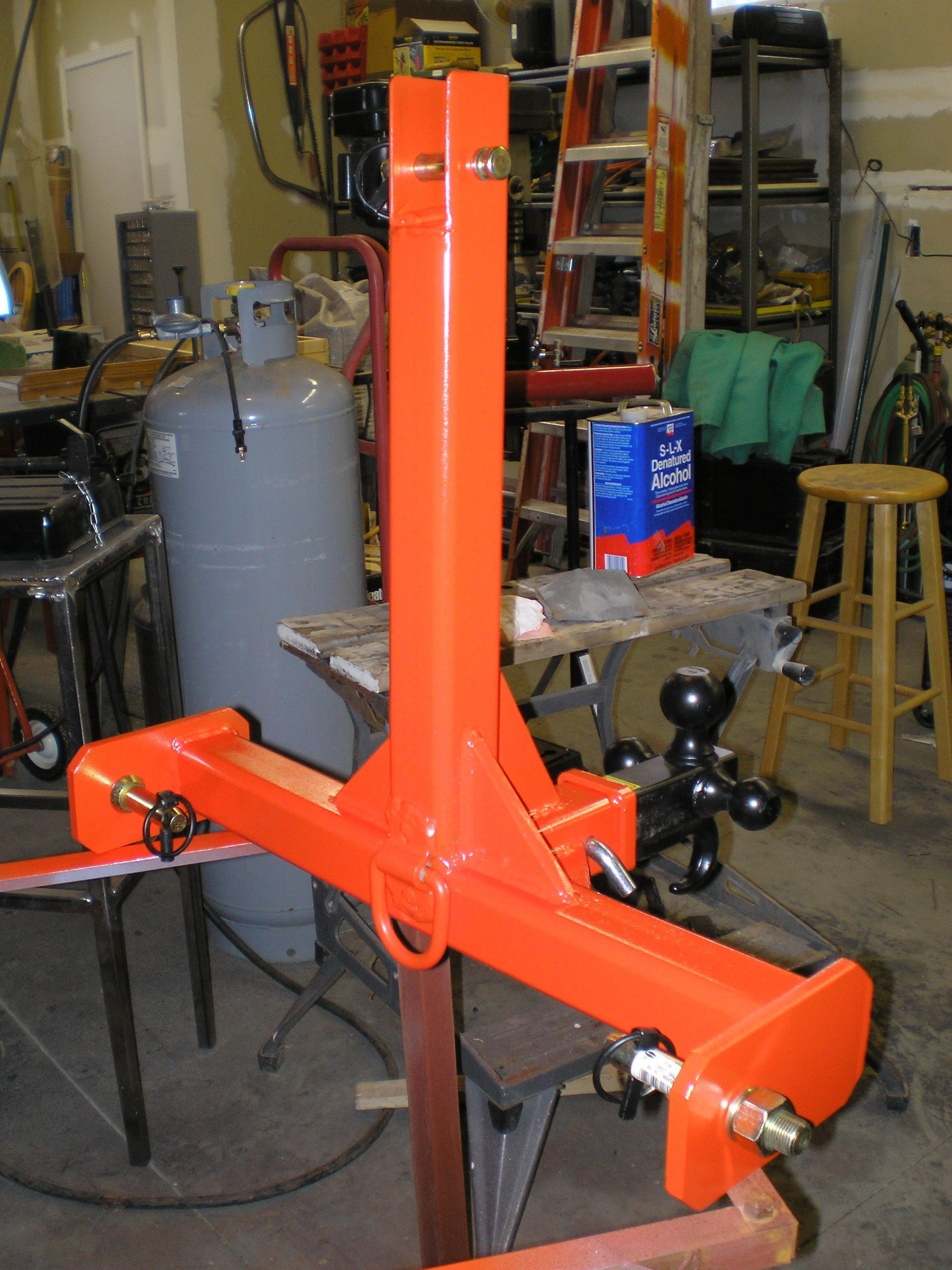

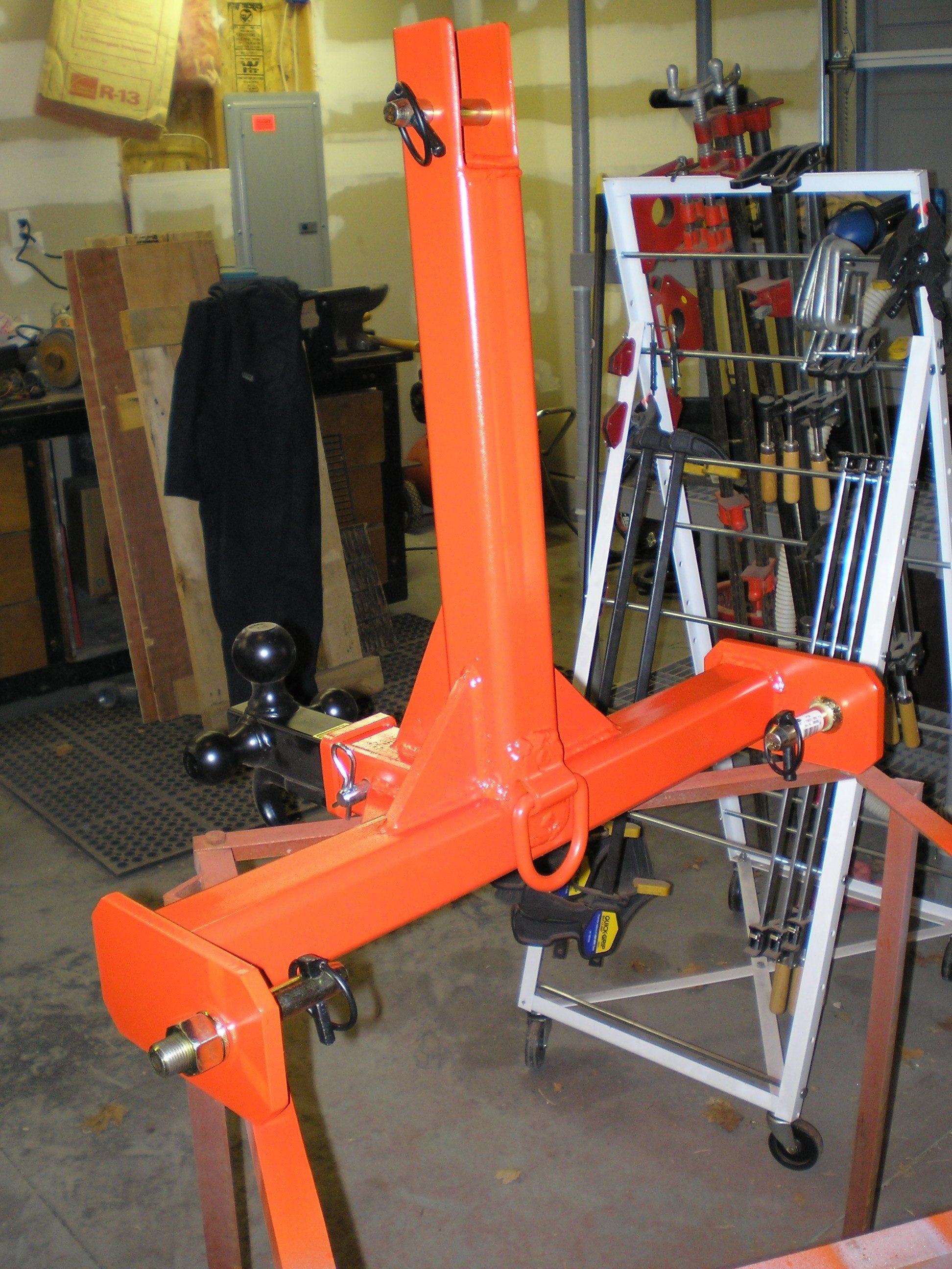

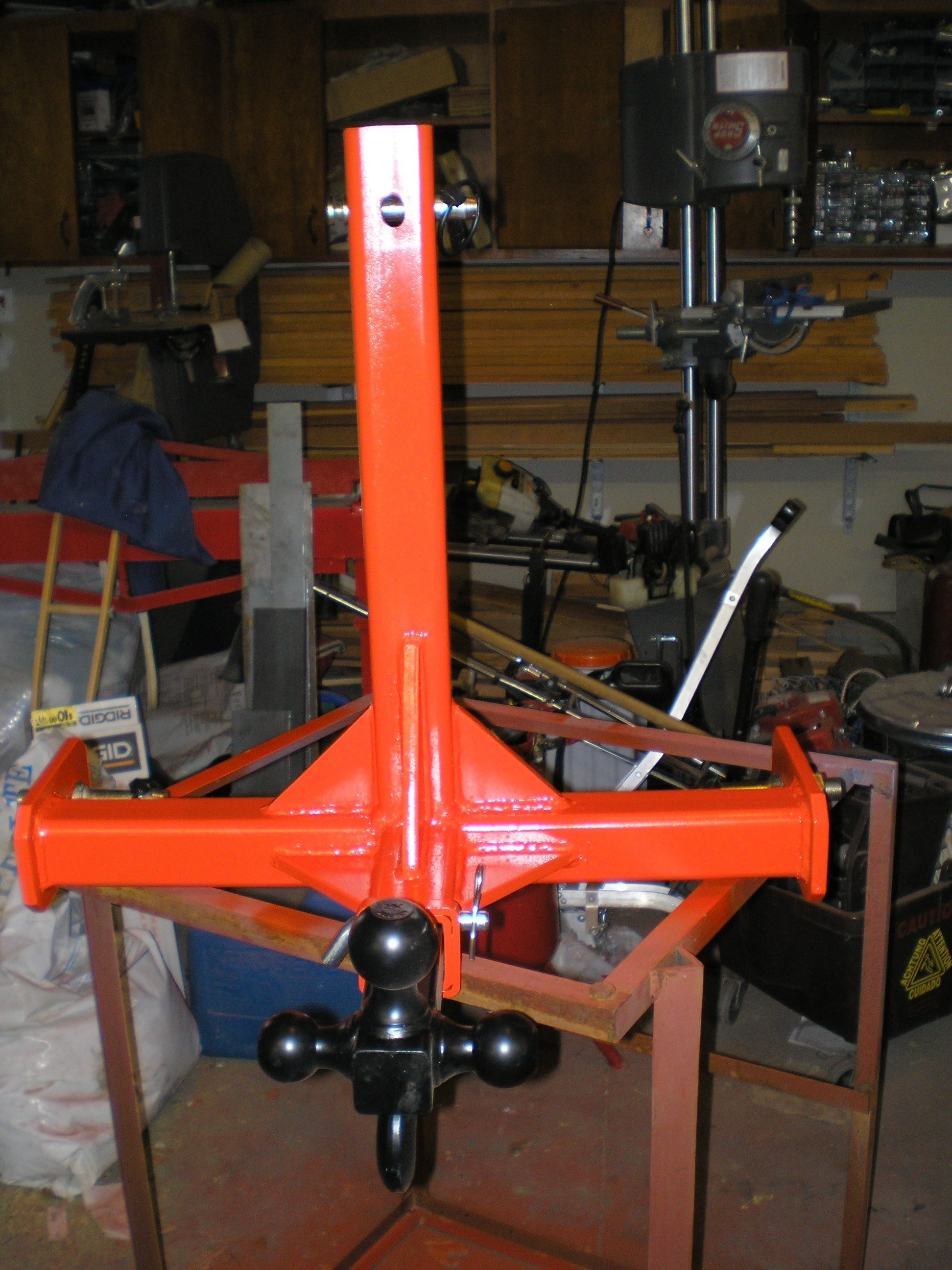

I finally found the round tuit I've been looking for and built this piece. I've been engineering the design in the back recesses of the brain for the past year. Started last Friday night and finished afternoon of the next day. Now to clean and paint.
The tubing is receiver hitch outer tubing purchased from Pacific Recycling here in Boise. The lift pin brackets are 4" X 3/8" plate. The receiver tube was purchased and welded to the horizontal cross member. With gussets all around for the upright and the receiver tube, I think this will be more than sufficient to move my boat and the 16' trailer I use to haul my Kubota BX 24. The stinger was on sale at Harbor Freight, and with the 3 ball sizes and hook for $26.00, the picture is complete.

That is a very nice job you done there, i like how you braced it and that is some nice welds.
You are like me, every time i build or weld something i make it extra strong, you could turn that into a logging hitch.

Catching up a bit here after a busy weekend. Thank you all for the comments, feedback and support. Over the weekend I welded on a ring to the front of the hitch to which I can attach a limiting chain. Still haven't figured out exactly how I will do the safety chain attachment, but I am going to add that feature as well.

Waking this thread back up to post pics of the finished product.
Following feedback from forum members, I added a D-ring for a hold down chain-to-the-drawbar to keep the thing from rising unexpectedly. I decided not to include rings for safety chains as I'll just be using this to move my boat and landscape trailer in and out of parking places, no road travel.
I had to wait a while for the temps to warm up enough to paint. Soooo, after 2 primer coats and some number of color coats (Kubota Bright Orange), here's the final deal, bright and shiny to match the tractor (BX24).

I like the pins facing inward. On my brush hog I changed them to face that was as brush would unsnap the lynch pins and let the drawbar loose. With them inward and the sway links tightened even without lynch pins it won't get free.
