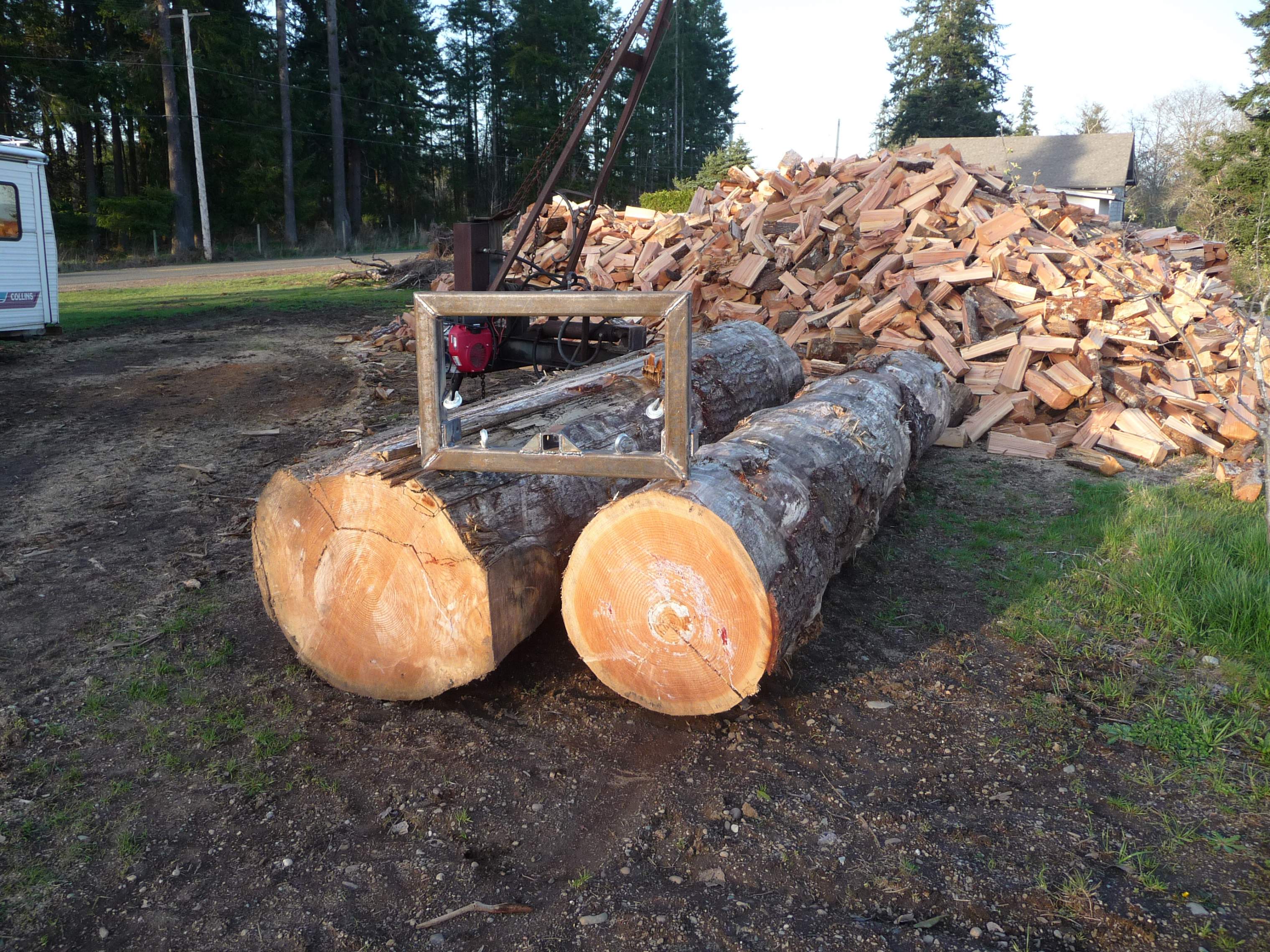

   / 3 pt Receiver Hitch attachment #24
Ok I finally was motivated to get mine going. As I do a bit of logging, trailer pulling and just needed an all around thingamajig instead of the drawbar this is what I came up with.
I built it so it would withstand cat II, but will fit cat I. I put it on a smaller JD and it worked great as far as fit and when it was raised it didn't tip at all, stayed verticle from the bottom up.
It isn't finished just yet as I am adding a removeable boom for tong use.

   / 3 pt Receiver Hitch attachment #25
Looks nice, what's that thingamajig in the background? you have a boom mounted to you splitter?
JB.

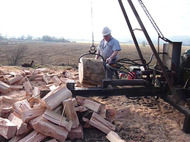

   / 3 pt Receiver Hitch attachment #26
Yes, that splitter will take on anything up to 7ft in dia. the boom is 10ft. The knife is a T knife so you just take two pieces off the bottom of the block as you work it down.
The other day I had a couple of fellows feeding and tossing wood. Went through about 2 cord an hour.

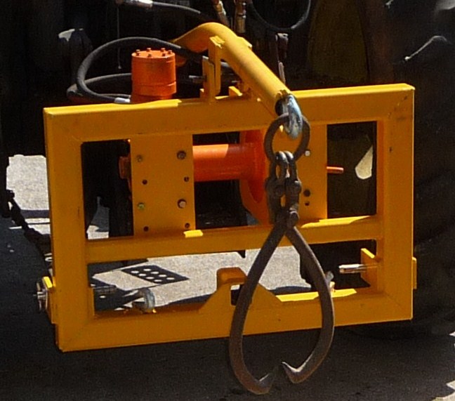

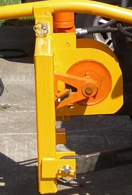

   / 3 pt Receiver Hitch attachment #27
Was able to get back on the project today. got the boom fabbed up. just need to hang a hook or shackel on it and maybe some lattice over the top to strengthen it.
I am still thinking of sticking a hyd winch in it as I have one lying in the shop. Will see how much clearance I will have after hooking it up. Plan on that tomorrow. If I get with it should be ready for paint.
   / 3 pt Receiver Hitch attachment #28
Finished the hitch att finally. Just need to put some line on. I will hang a small pulley on just behind tongs when I use the winch. It will act as a fairlead.

   / 3 pt Receiver Hitch attachment #30
Nice looking rig! I really like the hydraulic winch set up. Should be fairly stout working so close to the tractor.
