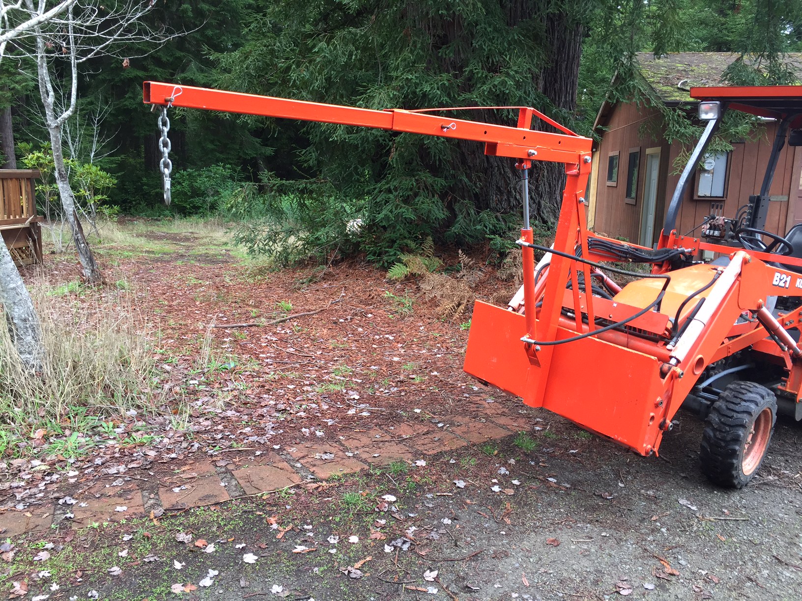

Nice job. I put my old 2 ton Harbor Freight shop crane on the front of the tractor with a SSQA conversion. Extremely handy to have an all terrain mobile shop crane. I can use it in the shop if I need to, and anywhere else as well. Since I already had front hydraulics on the loader, it was easy to swap in a hydraulic cylinder to replace the HF jack.

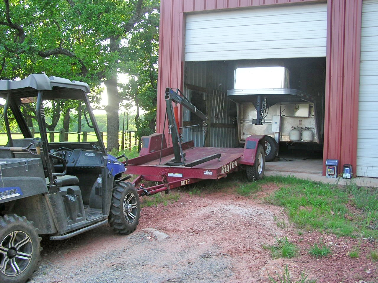

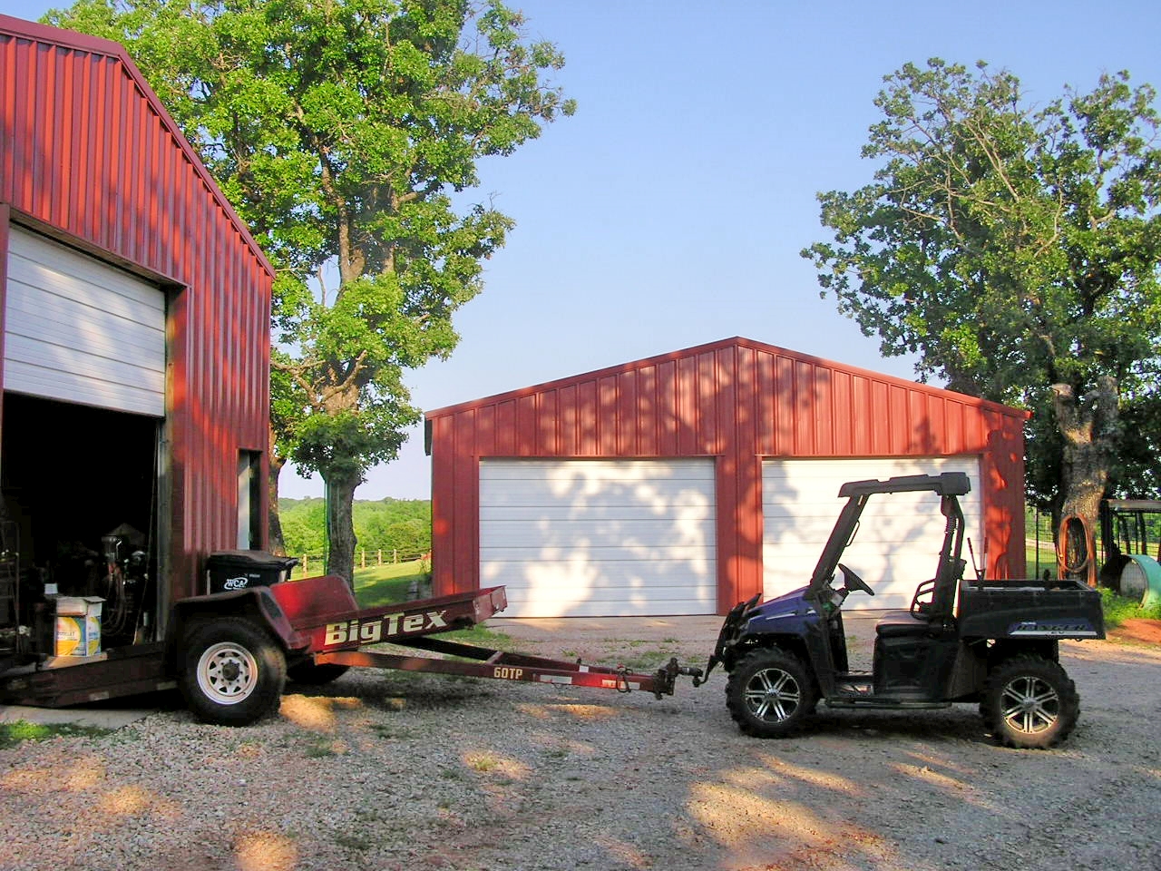

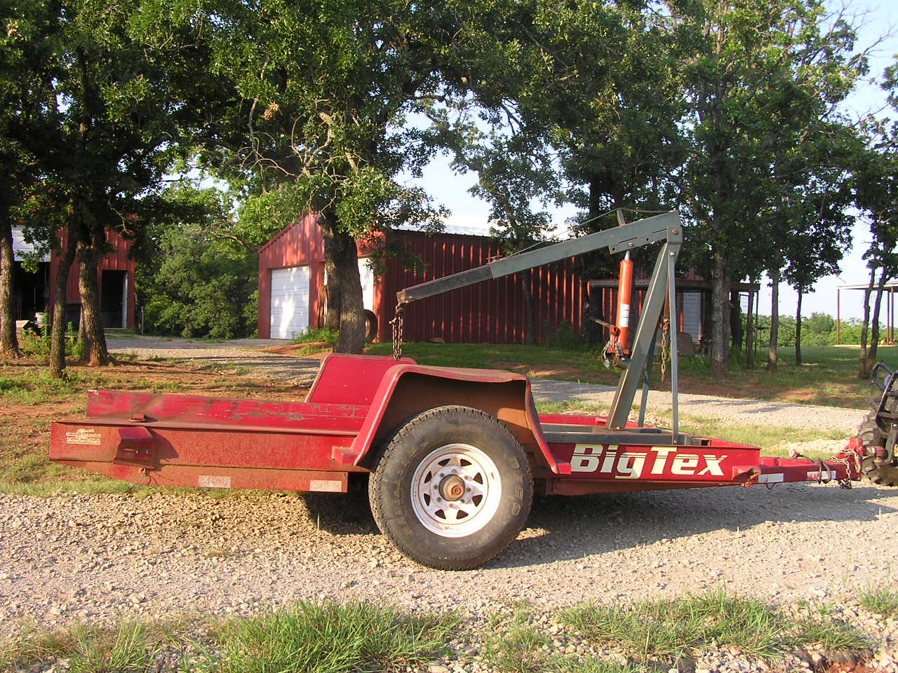

This is how I move the shop crane. The tilt trailer has a 6k axle, so it handled it easily :D:
